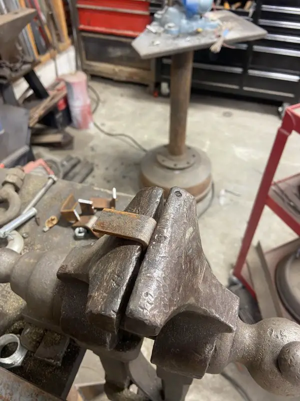

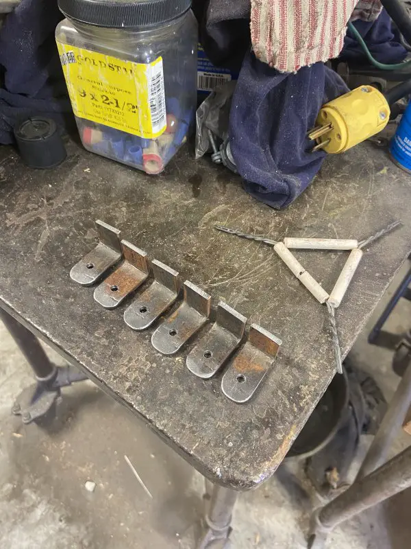

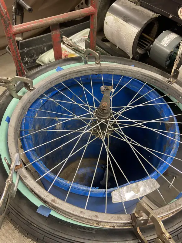

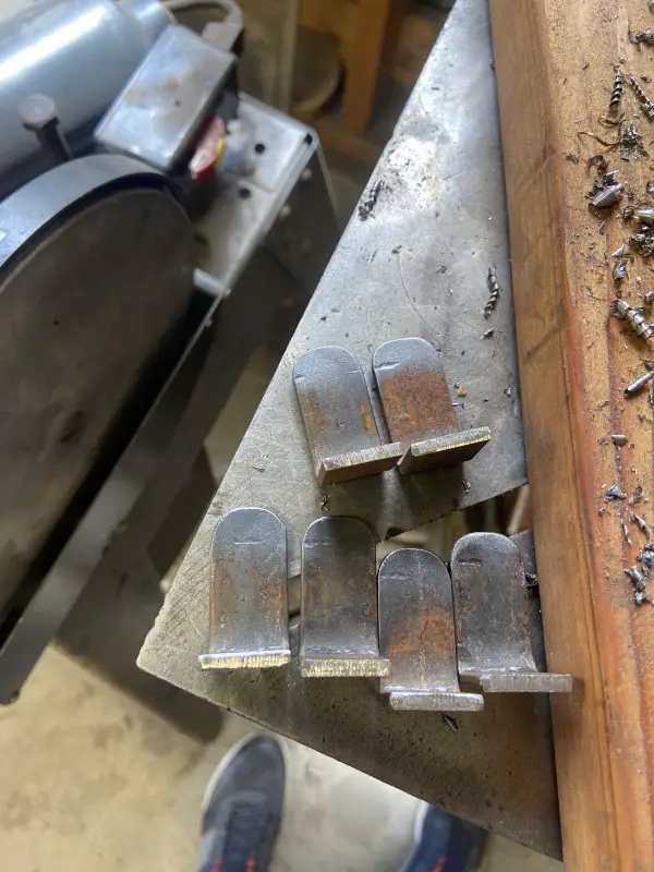

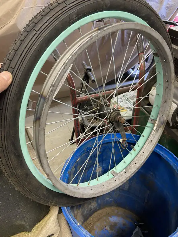

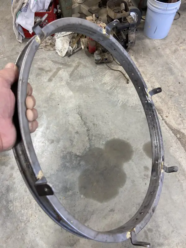

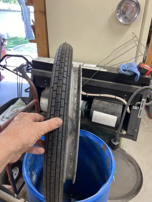

Well I was able to get out in the shop for a few hrs the last couple of days as the wife was sleeping. Grabbed some 1/8 x 3/4 flat strap and cut and bent six mounting tabs for the rear rim/pulley. Today I was able to get them brazed on. Next step will be to dismount the tire, true up the wheel, drill and countersink the mounting holes, the reassemble. Once I have the rear wheel assembled I can continue on the frame modification.

It is good to see you using a correctly proportioned drive sheave. Keith has fought belt slippage troubles.
But he used a Whizzer sheave on his Excelsior tribute machine. Which for the weight of it all is sadly under sized.
