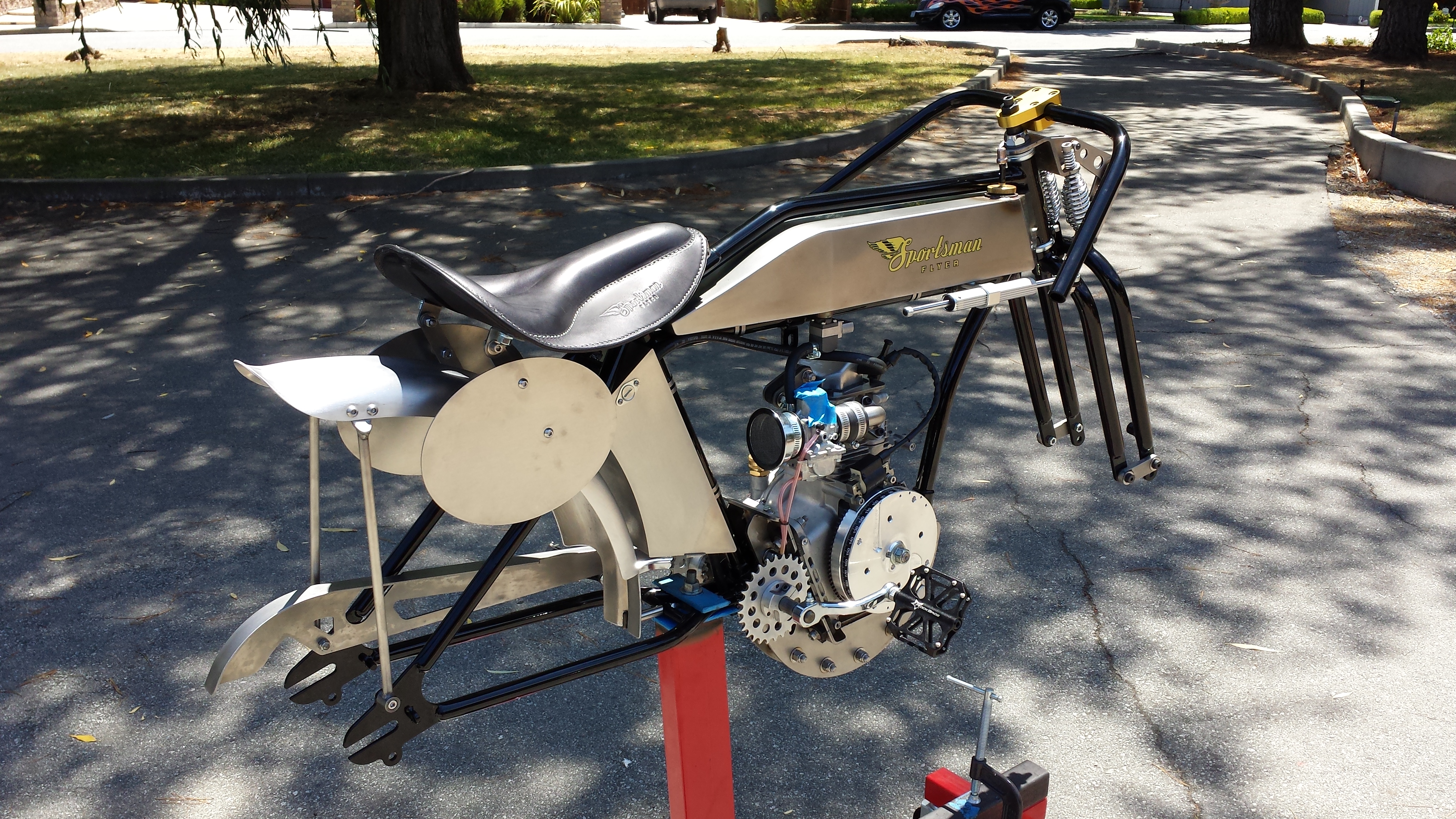

Quick update on the Keystone. I need one solid uninterrupted day and I could finish it. Anyway, here it is almost ready to ride. Plenty of starter clearence and all the chains fit and aligned.
Keystone Flyer by Sportsman Flyer, on Flickr

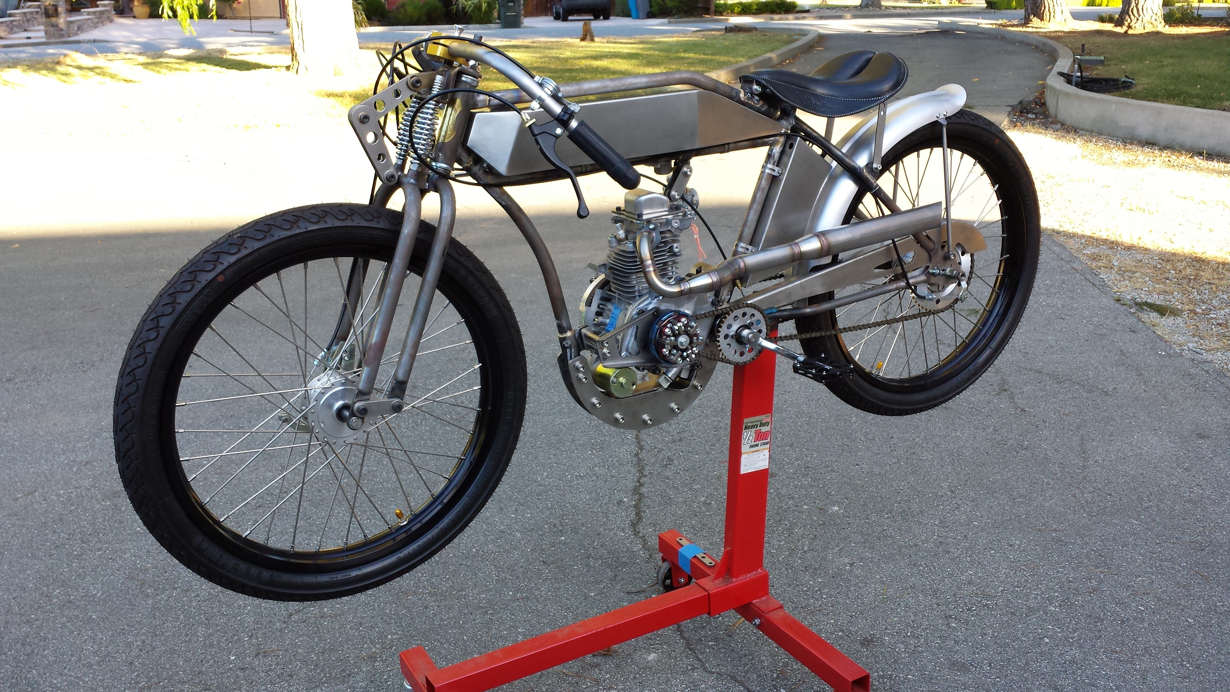

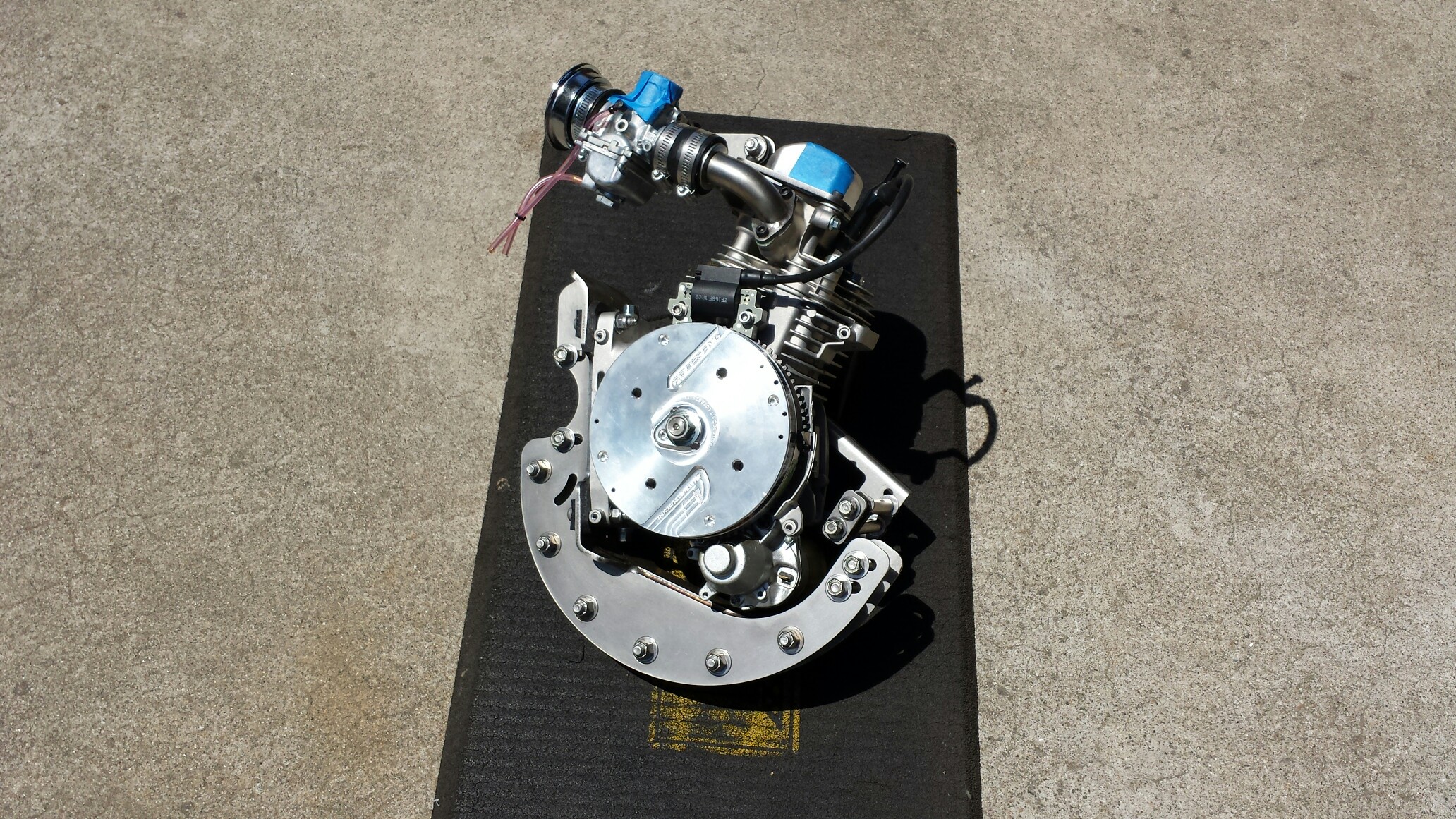

Closeup of the exhaust pipe. Still needs muffler insert and rear mount strap.

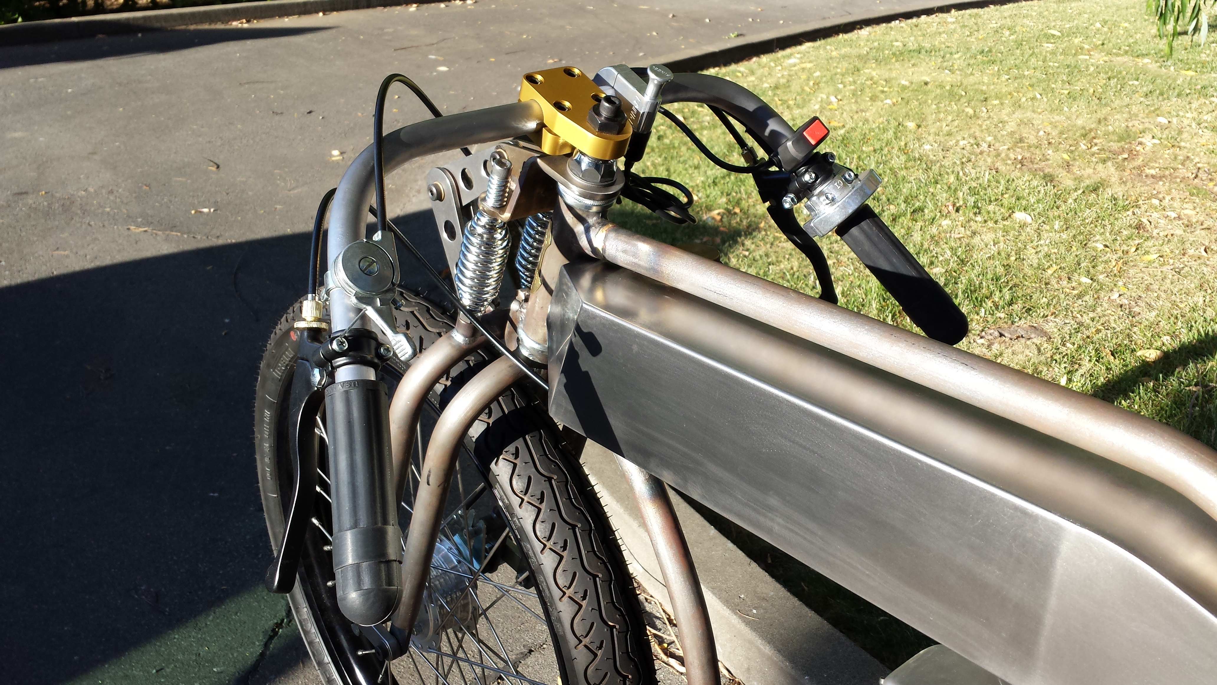

Here's something new. A different style handlebar. Less like an Indian and more like the vintage Harley. Simple and effective. 7/8" .120 wall DOM with an aggressive center knurl machined on so they won't ever budge. Cut very narrow for the high speed tuck!

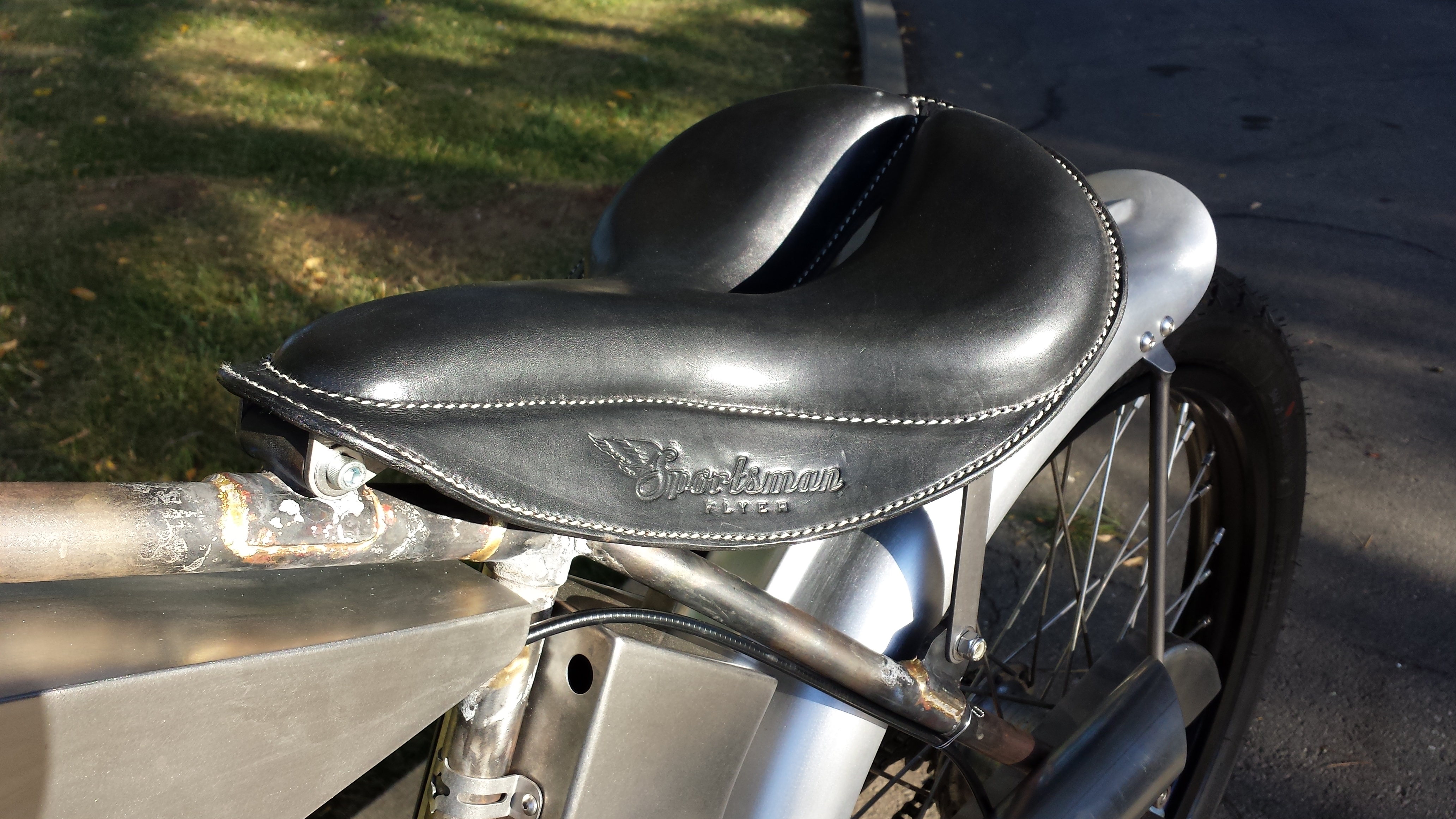

Closeup of the seat. Smaller cut with extra thick padding.

Fired the Keystone Flyer up today for the first time. Not sure how to upload video so here is a link so you guys can hear it run.
https://www.flickr.com/photos/sportsmanflyer/14609356523/
It fired right up and settled in to a nice idle. These bigger carbs I have been using seem to be perfect right out of the box. This engine has a made in the USA billet steel stroker crank and I was hoping for a smooth running engine. I was not disappointed! Run it in for awhile on the stand then took it out for some test miles. Once I felt everything was good I spun it up and quickly hit 63 mph then backed off. That was 8500 rpm! Pulled clean to red line so carb settings are good. This thing is smooth, fast, and powerful. Couldn't be happier with how it turned out.

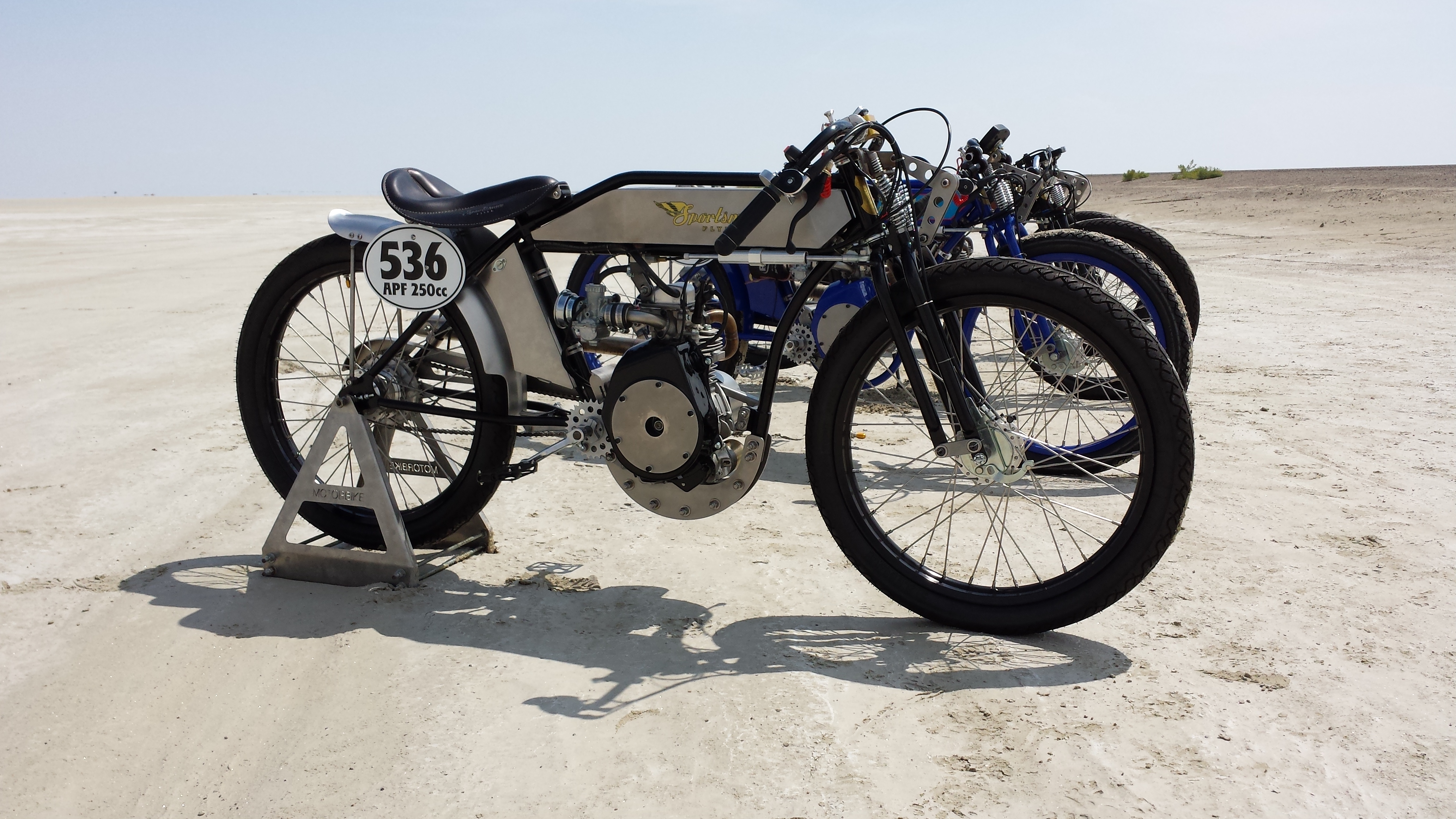

Here is a picture of my Keystone Flyer in full race trim with nowhere to run it.
BONNEVILLE SPEED WEEK 2014 by Sportsman Flyer, on Flickr

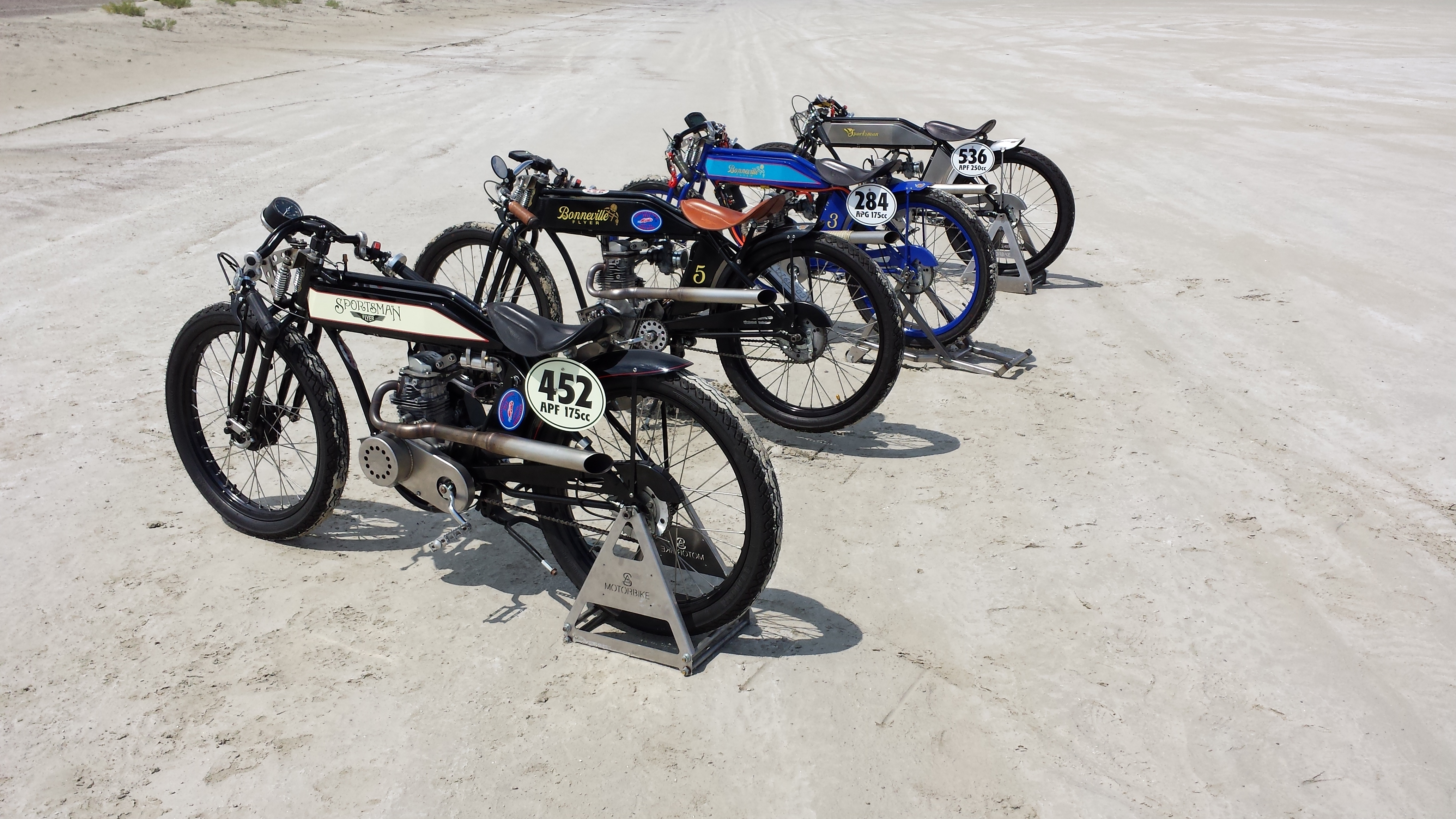

One bike is missing from this lineup. We were ready to run in three different classes with 175cc and 250cc machines and had hopes of 78-86 mph. One bike was even tanked up to run alcohol, a first for us. Oh well, maybe next time!

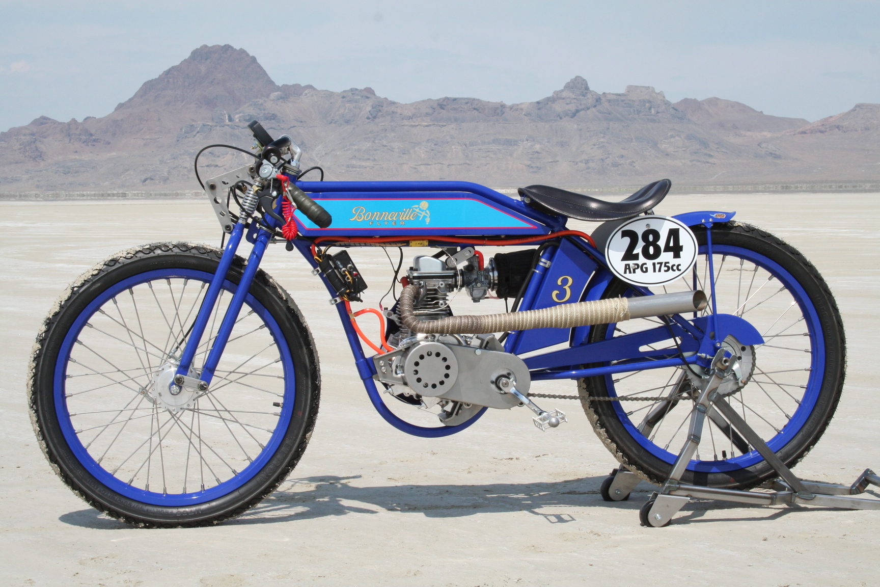

Here is a picture of Rich's alcohol burner. The only alcohol consumed on this trip was a few cold ones! This is a 175cc machine.

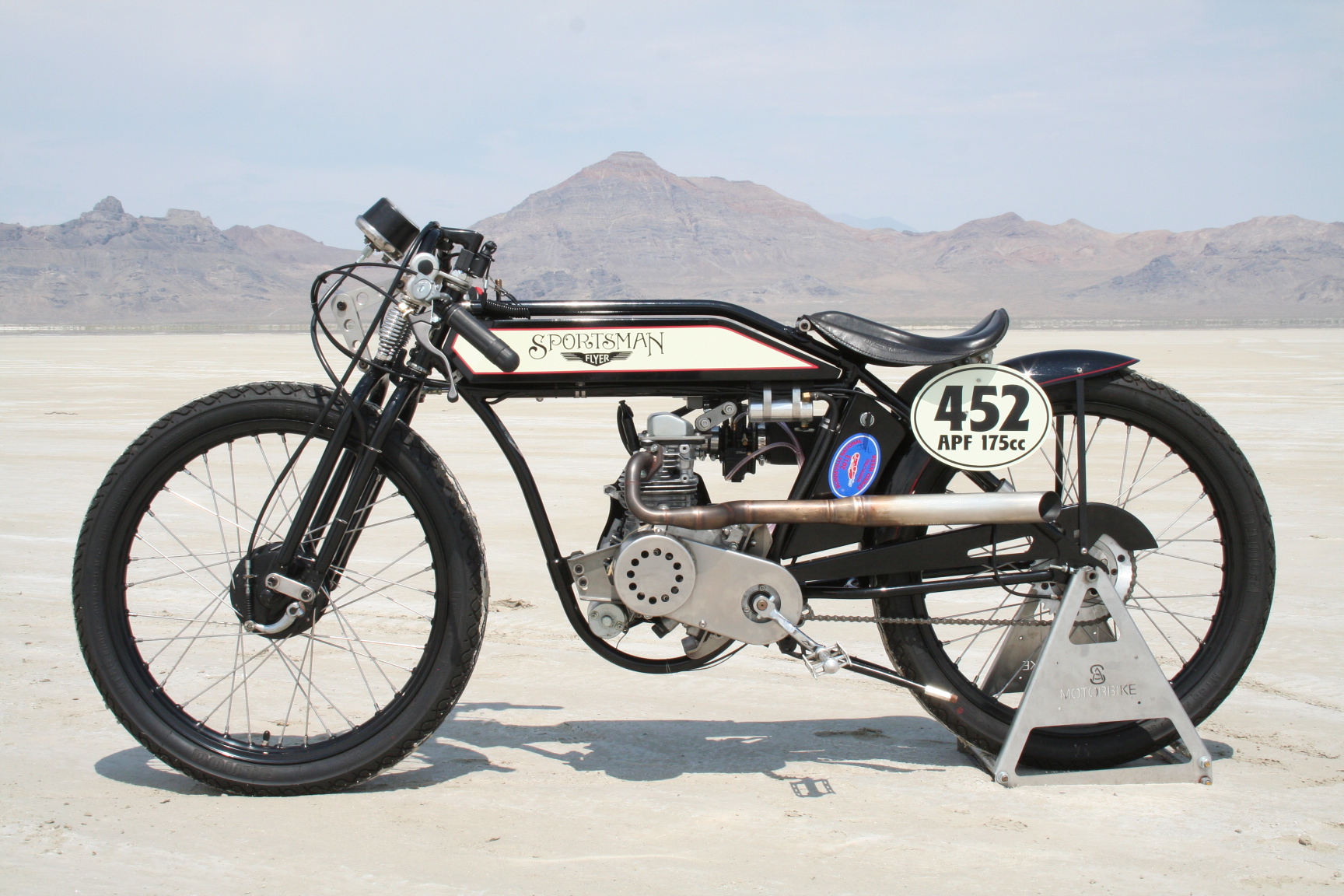

Bill and Garrick's machine. A beautifully prepared 175cc running on gas. You should have heard this engine. Talk about crisp and finely tuned! It had all kinds of cool race gadgets bolted on.

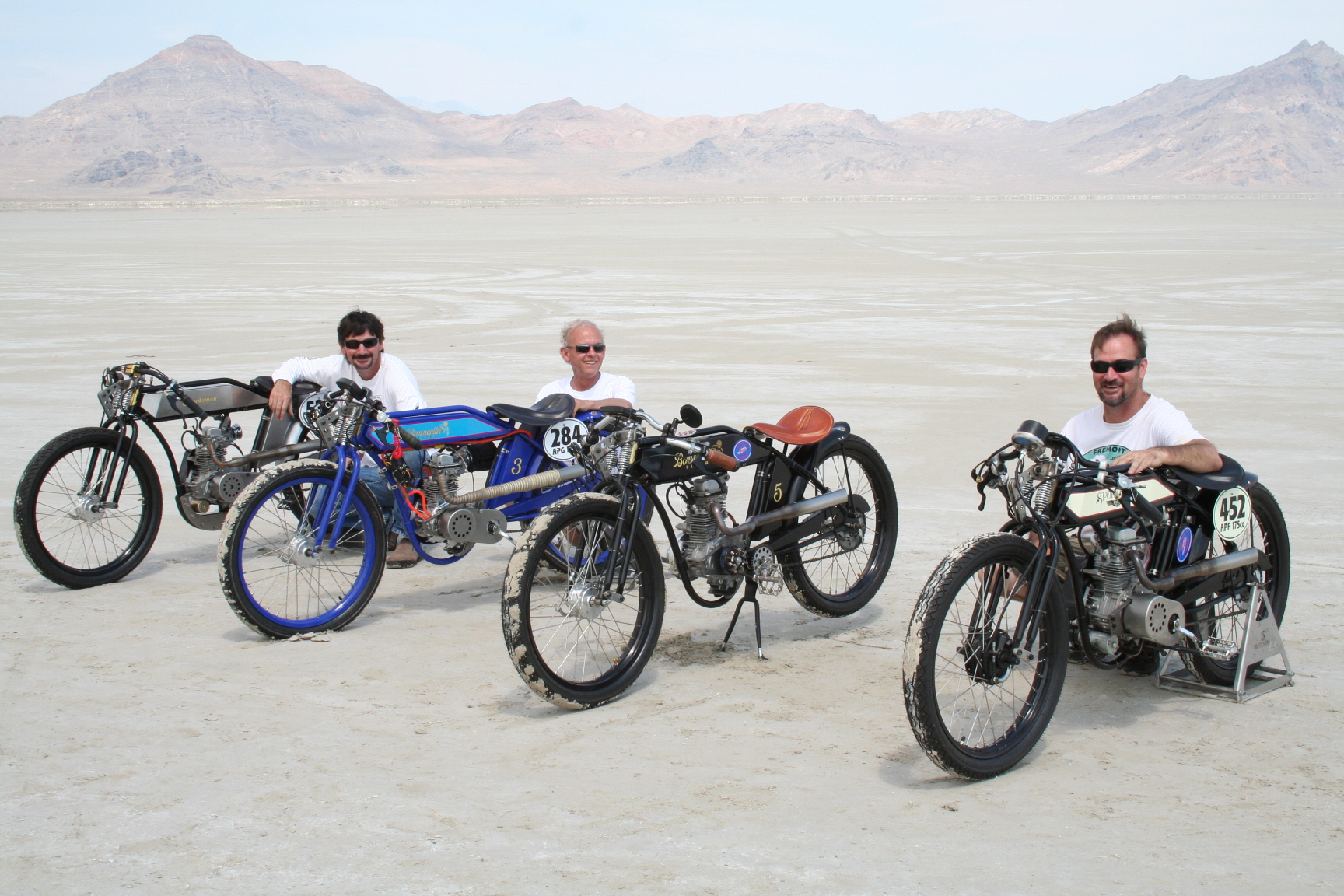

We may be smiling for the picture, but your looking at a few unhappy guys.
