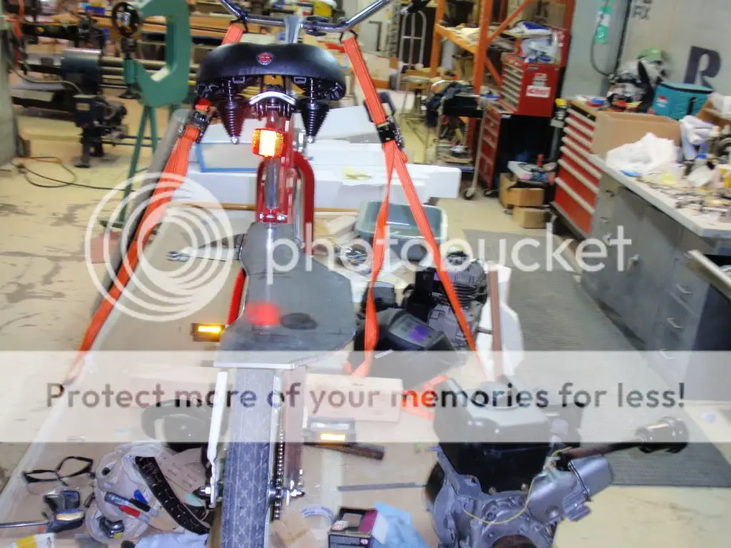

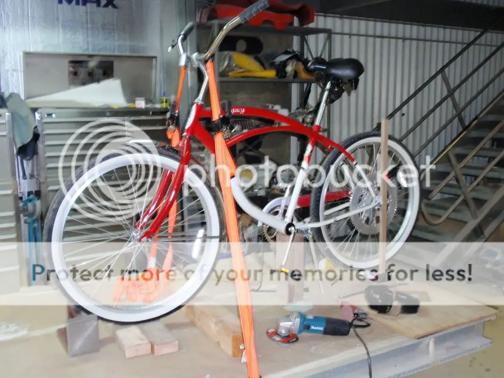

Well then, got a lot accomplished today....the only thing that needs to be done before it can be ridden is to finish the throttle setup....that's it!
And here's a few more of the nearly completed tandem build. That handle on the rack is sure a handy thing. Tensioning the chain is a breeze with this set-up....only the throttle to finish now and then the ride!

Next up will be riding the 2-seated beast....sure glad I get to be the pilot, heh heh!

Finished the throttle today and braced the tranny to the rack as well. Take off on the maiden voyage (solo) and this thing performs flawlessly. The quietness, smoothness and speed were amazing....I honestly almost could not believe it, Pat and I were laughing our heads off, the thing is crazy.
Took some short vids of it tonite and will take more tomorrow in the daylight. Here's the last pics of the build, I'll post todays vids shortly....what a beast indeed!

It's up and running like a champ.....we got to put a few miles on her today after installing a new Shimano V-brake up front. Got a new V-brake for the rear that we'll install in addition to the existing rear cantilever. Added a Cateye wireless cyclometer as well. Things we will upgrade asap include Cloud 9 saddles, higher-rise handlebars, 26x1.5" treads and a surfboard rack! We had it up to 41mph today in the neighborhood, it will go even faster. Some more pics....
