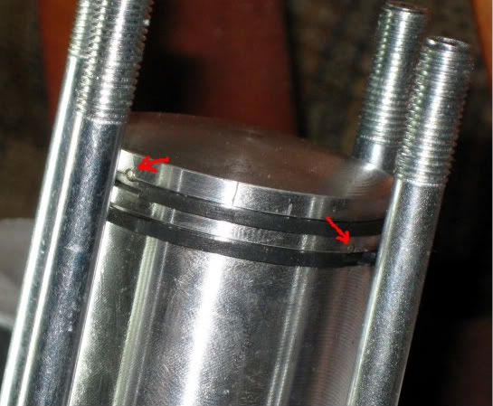

Figured I'd mention that not only should ya compress the rings, but there's two sneaky lil alignment pins conspiring against ya too ;)
yeah i saw those on upon closer inspection. may want to put a warning out for newbies like me on that post about port matching at the top of the page. i didnt even know i was screwing up until i screwed up.
I feel your pain and wish i was there to say NOOO!!! Do not use a hammer to install your head thats a big no no like dood said just use your fingers in the two cut out holes on the head if all is lined up it should be pretty simple .never force .
If you cant get it on with a tap from your bare hand then somethings amiss evaluate , fix re try make sure these two pins are facing the rear of the bike same side as the Carb not the muffler aka front of the motor

Also make sure the ring doesn't go on upside down I believe the widest part "where the ring is separated " should be facing up & the closest point should be on the bottom on each ring Naturally you may want to put the closest point on the rings on top ..this is incorrect not sure how much it matter I just noticed this when I took a new one apart My guess is so the compressed air can caught better by the ring making . However research this further I may have gotten a new head put together by a Bozo
