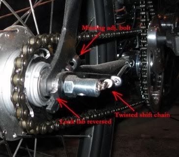

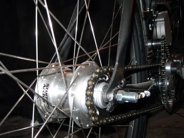

[br]At the time there was still much debate as to whether or not an internally geared hub would stand the abuses of a shift kit...
As it turns out "reports of their imminent demise were greatly exaggerated" lol, I've not had even the slightest problem at all with either of them
This has to be the coolest pic of a Jackshaft I have ever seen.
Nice pic BA ;-}

Re: Is the rear wheel on your MB strong enough
Thanks lol - it's a mid-build pic tho, it's changed a lil since then ;)
I threw it together and in my excitement I neglected to notice a coupla things before I took that pic;
AND the cable mount is out of line with the chainstay :p but I was psyched to have my wheels on it heh :oops:
