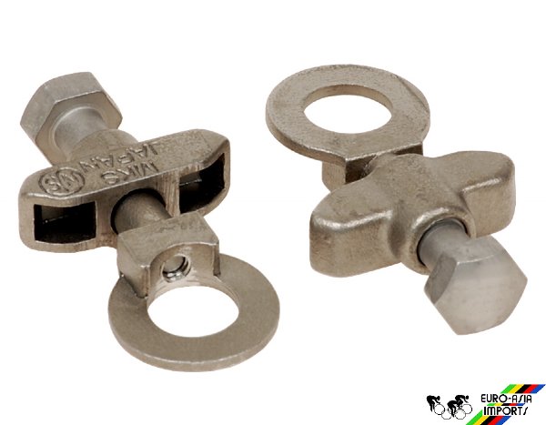

Kc,they're called chain tensioners.
Not these, they are called something like 'axle stays' or something like that and hard to find but a Google on 'Chainstay tensioner' will get you to those cool $14 tensioners I sometimes use on the pedal side on direct drive builds I just can't quite get chain matched and don't want a tensioner on the drive side.
Don't ya hate it when you can't remember a term that will get you what you want?
The sad part is none my local bike stores carry them either but they sure work well on open back horizontal dropout's, if the open side is on the front they are useless so I end up putting a bolt and cut washer and nut in front of the right side axle nut. It's not pretty and it makes it a pain in the butt to take the wheel off but keeps it from moving forward when I lay on the power ;-}

KC, chain adjusters are a good idea on any bike. Not only do they keep the wheel in place, they make it easier to center the wheel when you are adjusting the chain tension. I've seen several versions, mostly vintage, for sale on Ebay and elsewhere, or you can buy motorcycle adjusters and modify them for a bike. BTW, the metal piece you refer to is not pot metal, it's aluminum and it's called a bell crank. You only need enough torque on the set screw to keep the bell crank in place since it does not hold the axle in place. I've ridden mine nearly 2000 miles without a hiccup. I'm excited about riding it in the "Spirit of Christmas" parade with several Cushmans, Vespas, and California Scooters on December 8.

I searched around some more and came up with this for horizontal open back dropouts.
MKS Chain Adjuster 5mm x 10mm Hex
http://www.euroasiaimports.com/productcart/pc/MKS-Chain-Adjuster-5mm-x-10mm-Hex-334p484.htm
That bolt and plate should fit right inside the 10mm slot so it comes out the of middle of the back slot and the washer fits snug to the frame with the cup over the back openings to take some motor torque against.
Granted that one is overkill for a motorized bike but pretty simple in overall design, a washer attached to a nut and bolt that will fit in a grove for you creative guys.
Anyway that should work for that Nexus hub issue.
