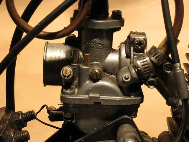

An interesting but perhaps unhelpful tidbit is apparently the "CNS" included w/the Grubee kits and the aftermarket upgrade CNS are two completely different carbys, only somewhat similar in construction;
The "YuanDung Skyhawk"
My "Honghua" CNS purchased frm Spooky about 4500 miles ago:
*shrug*

What the heck, since I am messing with it now I'll snap a pic.
This is the carb plunger and lean/rich adjustment.
If I am not mistaken the old carb's only had 3 adjustments and this has 5.
It also looks like it comes set at the second leanest setting (2nd notch from top).
That might explain my bogging problem, not enough fuel with the air.
I'll move it down a couple and see ;-}
The old carby also has 5 adjustments.auflg
