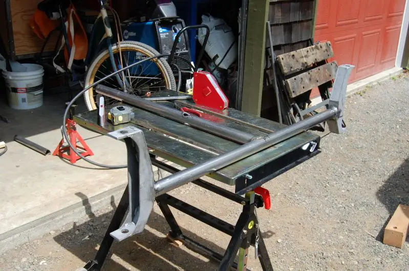

Welded up the front axle and the tube going back to the bike where will attach to it. I plan to be able to remove the tri-car as they would have and add a fork to make it a regular motorcycle.

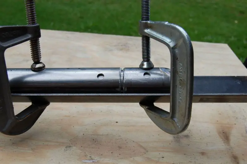

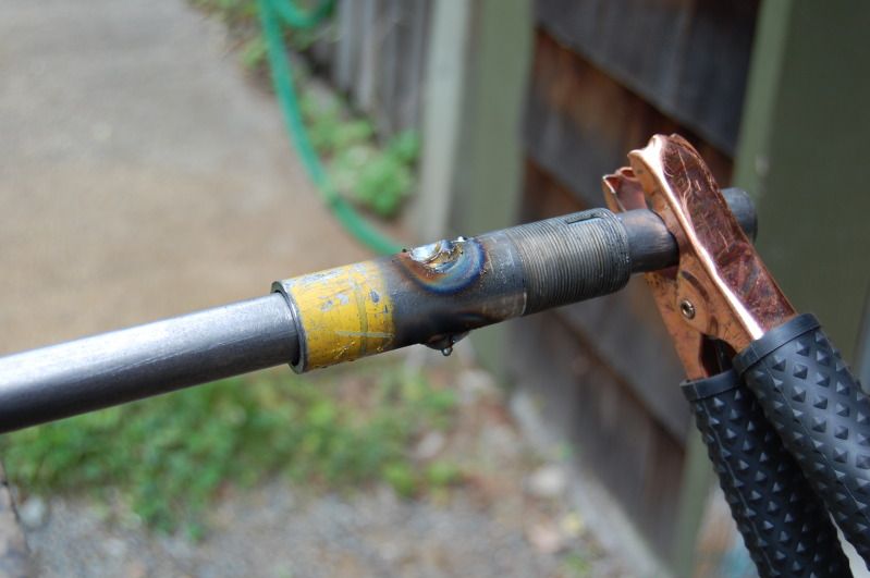

The tube going down from the head tube is on and there will be a small piece added to the underside of the tube. My plan is to use a steerer tube at either end of the tube coming down from the head tube.
The top one will act as it would normally with the handle bars in it so they can be removed and everything undone so the frame can be lifted off the tri-car. The bottom steerer tube will have a bearing cup, bearings and everything else to hold it in place.
I'll have a length of steel rod running down inside the top sterer tube down through the bottom steerer tube and out far enough to weld a pitman arm on it to steer the tri-car.
Welding the tube that runs from the axle to the bottom bracket where it will attach gave me about a 10% caster angle since the axle was vertical when it was welded to the tube. The bottom bracket being lower tilted the spindle holders backwards, giving them the caster angle.

I finally have the front axle on the bike. I was working on the tube that runs from the axle back to the frame at 1am and despite measuring it at least 8 times and getting the same number I managed to cut it to short. I did the happy dance up and down the driveway when I discovered that.
I do seem to have a talent for that so once again I have to add a few inches to the tubing. Amazing how good you get at doing that after a while and really good if you do it as often as I have.
I cobbed a piece in to get it together and that's what you see in the photos. No, I wasn't to proud of myself when I did it. :)
The steering is running smoothly at least. Wondering how it will steer with someone in the front seat. That may have been part of the problem when they where new and then you had to find someone who didn't mind being covered in mud,dirt and road grime and being the front bumper and an early version of an air bag.
That would have added to the adventure as well.
