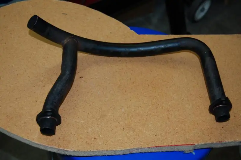

I bought a used exhaust pipe from a small engine repair shop for $10 that I removed a 90 degree elbow from so I can run the exhaust down to the muffler. Hoping that by the first week of March it will be on the road.

Went and got tubing for the exhaust and brake cables for the front brakes yesterday. I'll tackle that tomorrow. Today I'm discussing velocars with my 8 month old grand niece and her's in particular. We're talking electric at the moment but only to satisfy her rather anxious parents. A V twin may be in the future. :)
