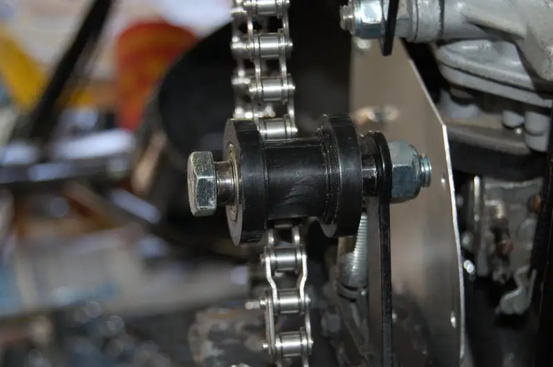

Steve one of my primary reasons to use idlers is my penchant of not wanting to ever move the engine for any reason except major rebuilds. The double tensioner might be serious overkill for the tri car though. I used the double setup first to act as a "step" idler to clear the frame, as I was forced to use a very small pedal sprocket to clear the engine; and a second spring loaded tensioner to regulate the chain tension and both idlers keep the pedal chain from wandering into the tire. All clearances were minimal and I thought it prudent to deal with it up front because as the chain and sprocket wear in the chain would have eaten the tire. That's the reason and perhaps the solution.

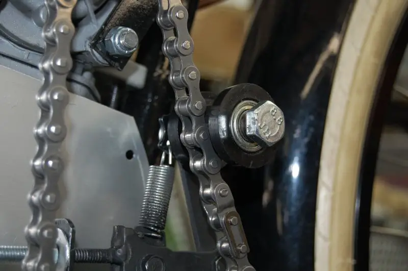

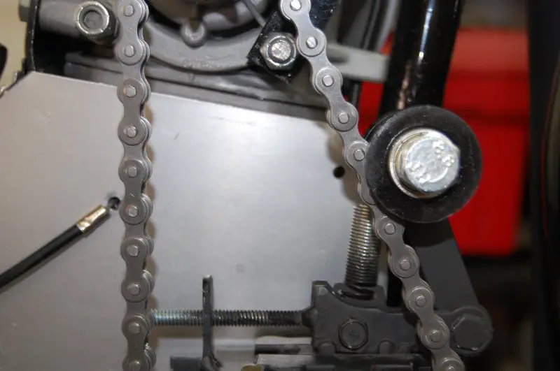

Reran into a problem I'd forgotten about. The chain from the engine to the clutch needs to be stretched. I have a half link in it and when I try to install the link to join it together it's short by half the width of the pin. The motor can't be adjusted because of the way it had to be mounted.
With a full link in it the chain almost touches itself when tightened. Any ideas?

Thank you for all the great replies. I have an idler pulley installed. The problem is with a full link and a half extra the chain is very close to one another when the idler is tightened. Within maybe a couple of inches. I didn't take the camera out to the garage so I'll have to take photos tomorrow to show what I mean. I'm worried about the chain bouncing back and forth as it turns. This is because it has an link and a half it doesn't need. The idler pulley has a decent spring on it so it may dampen the chain whip but with no caster or camber built into the steering it remains to be seen just how fast top speed is before the ride turns into Mr. Toads Wild Ride.

I have a ten tooth sprocket on the engine and the sprocket on the clutch is custom fitted so it can't be changed easily or inexpensively. With a 3/4" shaft on the motor the 10 tooth sprocket is as small as they come. With a 5/8" shaft there is no problem. Faced with the perfect problem and no perfect answer.
To give you an idea of the amount of slack there is, the chain that is under the tensioner is almost vertical, with the diameter of the sprocket separating the two chains.

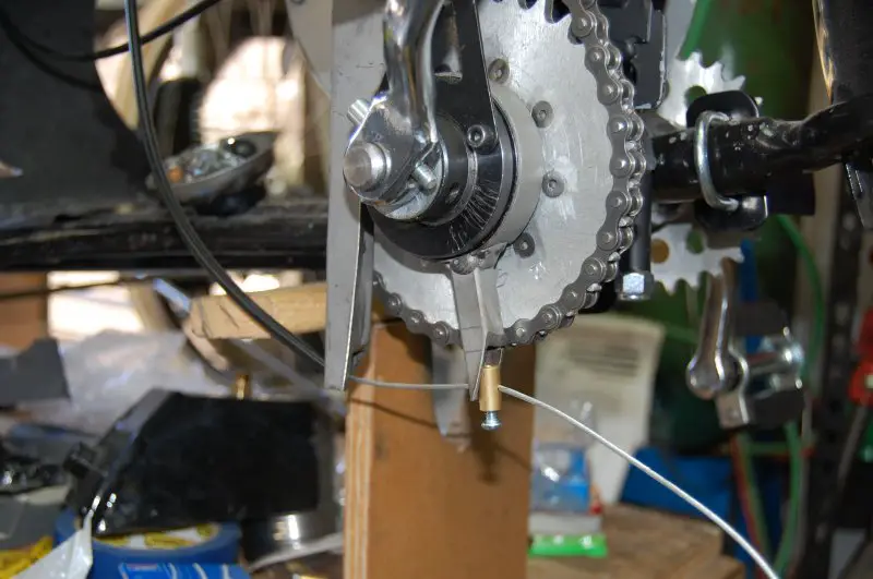

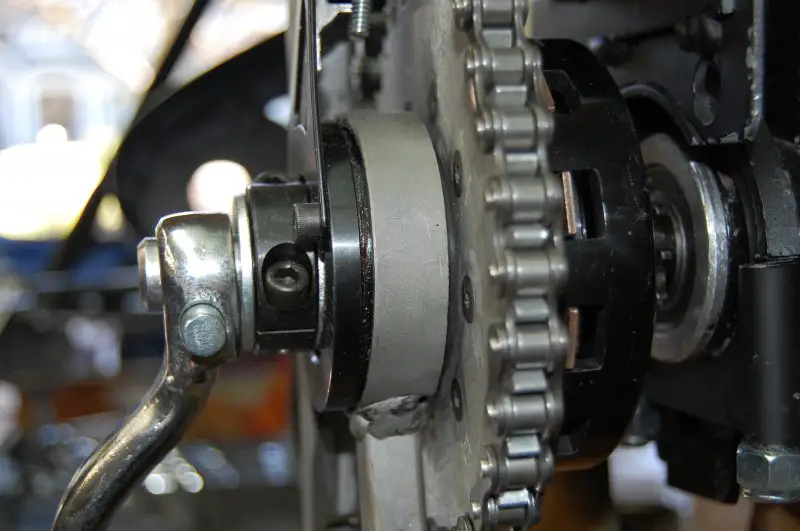

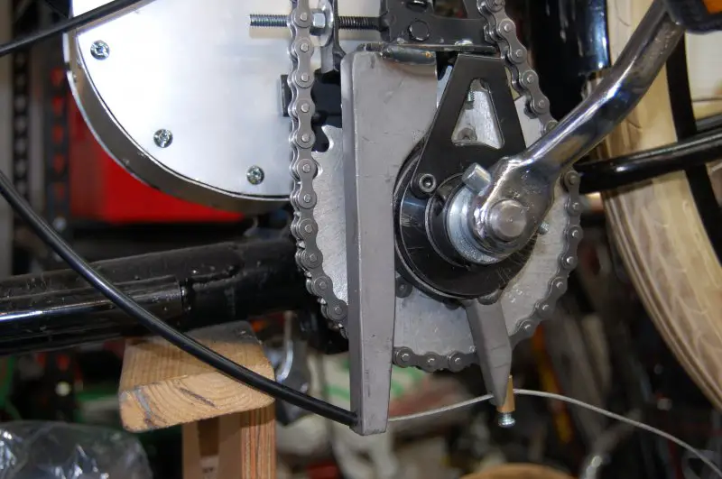

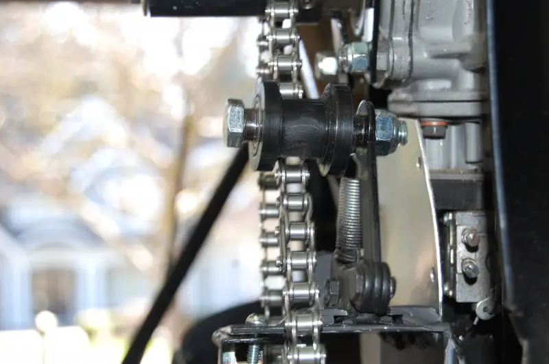

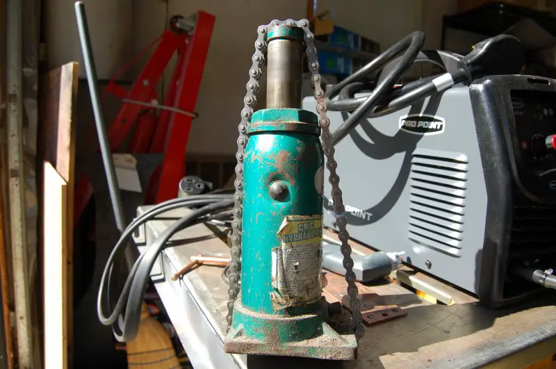

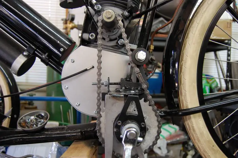

Chain is on. I will include photos of our patent pending chain stretcher but must warn everyone that any attempt to duplicate it will be met with vigorous resistance by our law firm, Wee, Gottum and Goode.
Everything needs to be taken apart and painted and the band around the clutch that has the clutch arm welded to it needs to have a hole drilled and threaded into it so it can have bolt installed can't move.
Clutch seems to disengage well.
A few steps closer.
Steve.
DSC_0005.JPG DSC_0006.JPG DSC_0008.JPG DSC_0009.JPG DSC_0010.JPG DSC_0011.JPG DSC_0012.JPG DSC_0013.JPG
