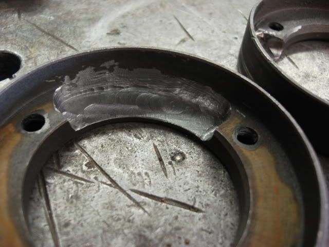

right now i am in the process of re balancing my crank. after about 5-6000 rpms the motor starts vibrating bad enough to break exhaust pipe. so i tore my motor apart yesterday and milled as much material as was removed from the factory (in addition to what was removed from the factory) from the same spot on the crank balance pads. hopefully that will put my sweet spot at 10k.
heres what i removed from the balance pads. i wil fill the entire thing with silicone to up my crankcase compression.

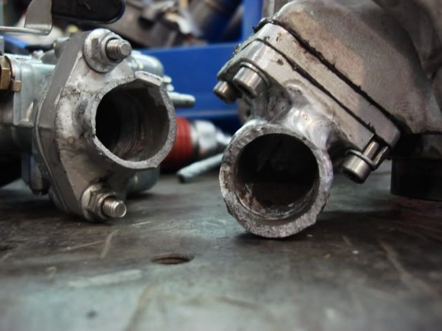

this happened the other night after blasting past a car on 4th ave and failing to notice the trolley tracks. thats what i get for laughing at everyone else who has wrecked the same way.
box o parts

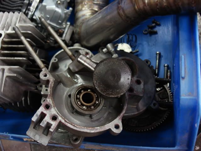

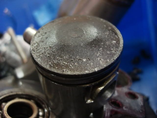

after i went down and the intake broke off, the motor stuck at full throttle while laying on it's side with a giant air leak. i think some street got in there and bounced around. everything looks like it'll be ok

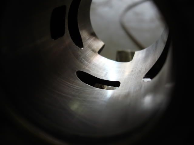

can you see the tiny mark below the transfer? that is the only cylinder damage. i love nikasil

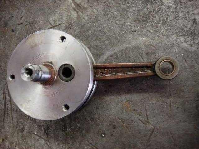

I recognize that rod.
It is out of a GT-5 66cc Angle Fire.
I believe the center to center distance is 88.9 mm.
I have one question if you can please help.
How much pressure is required to push the crankpin out.
Or if you have the crankpin diameter and the bore diameter in the crank i can calculate it.
just push it out bro !!! you really love #'s dont ya just saying i build race car motors and bushed rods pin pistons and sleeved cylinders pressed cranks in dirt bike motors never have i measured the amount of pressure it takes to get them out only size them so they go back together properly just saying you may make foureasy crazy with asking for mad #'s on this thread you have a extensive knowledge of building motors it seems from other posts if you never split a crank give it a shot it is very simple and i like your porting thread ive done this before now = i just wing it from all my past experience ive done everything to these motors only to accomplish 5 to 5.2 hp on a speed to wieght calculator my bikes only go exactly 40 with a 36 t but pull like mad from bottom to top take it easy bro and keep up the good work on the porting thread gotta go goin street racing in the big block stang hope i can hook up !!!!!!!!! COLD HERE BRRRRRRRRRRRRRR!!!
