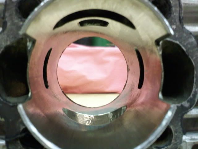

kinda runs, the shorter rod changed my port timing too much so i need another crappy long rod.
Is it possible for you to cut the bottom of the cylinder? Seems if you cut it "more than you had to", then set a final timing for the transfers using base gasket(s), and finally modifying the exhaust timing you could use the short rod.

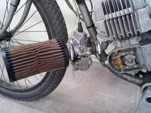

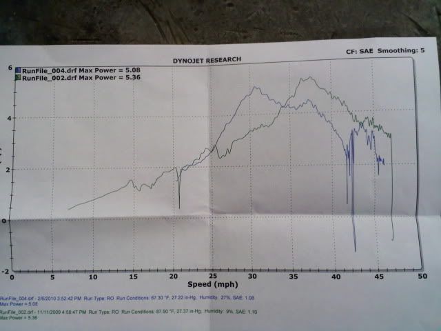

i put the 24mm flat mikuni on and switched back to 91 octane and this thing is an animal. i think i need a 44t sprocket cause im hitting 46-47 with the 41t, a little bottom end was lost with the new port timing. 180 exh and 116 on the transfers. this thing hits hard in the middle and revs to the moon. no noticable heat fade on the test hill, but the compression is still way low. i will need to weld up the head to fix the 2mm squish band. the crank is perfectly balanced as well. i can finally call this motor a win.
10,500-10,800 over 45mph with 41t sprocket on the rear. im gonna drop a tooth in the front because 41-42 is what i want my top speed to be.
