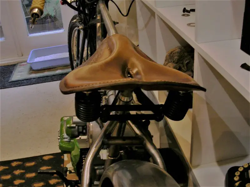

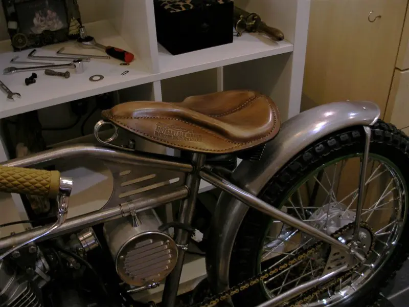

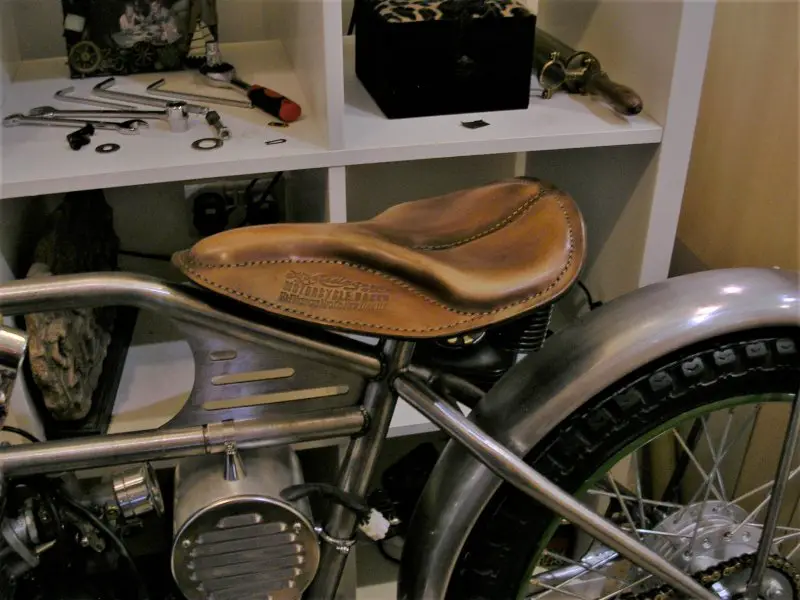

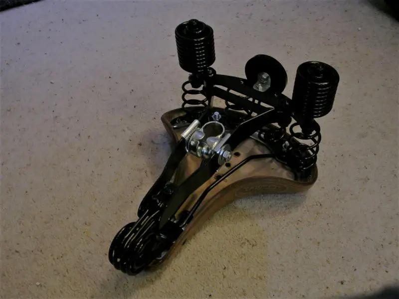

So... thought I'd begin by picking-up where I left off .... figuring out how to mount that beautiful Mesinger saddle which arrived via Czech leather-meister Tom Adamek. To say I'm happy with Tom's work is an understatement. Wasn't sure whether to fit this saddle to the bike or hang it on the wall as a piece of art! The aged patina he created is exactly what I was hoping for. In keeping with my plans to be able to swap-out both the handlebars and saddles on my ACE build, I needed to come up with a suitable mount for the Mesinger saddle which allowed it to be secured via the frame's seat post, same as the alternative Lepper Primus saddle I'm going with. I appreciate going this route isn't the usual way to rigidly mount a Mesinger racing saddle, but I was confident I could come up with a workable solution.
After examining the Lepper saddle's metal underpinnings, I decided to try fabricating a mount for the Mesinger saddle using some of the underframe parts I'd seen advertised online as spares from Holland Bike Store in The Netherlands. However, just as I was about to order-up the parts I wanted, a UK eBay seller on listed a lovely used Lepper Primus saddle which I thought would be a perfect candidate for donating the metal parts I was looking for. Three days into the auction with no bids, I made a cheeky best offer - and the seller accepted. Paid a lot less for a complete saddle than I would have done if I just purchased the spare parts from The Netherlands store. The Lepper saddle arrived and despite its leather upper being slightly distressed, it's metal parts looked like new. And it even came with a seatpost clamp. Result!
Ended up using the pair of larger springs and the mainframe from the Lepper saddle and these attached to the captive fixing bolts on the underside of the Mesinger saddle without any modifications being necessary. Following some 'creative staring', I reckoned a spring fitted under the nose of the saddle was the perfect finishing touch.
Plan is to be able to switch between the dropped-style Boardie handlebars and pullback-style Roadster bars - and relevant saddles - according to my ride mood, giving the ACE two very different looks.

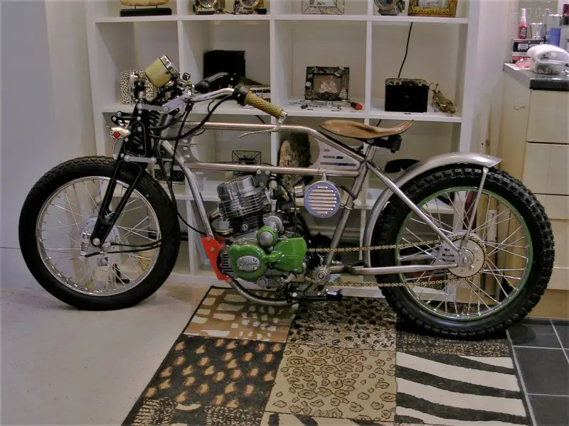

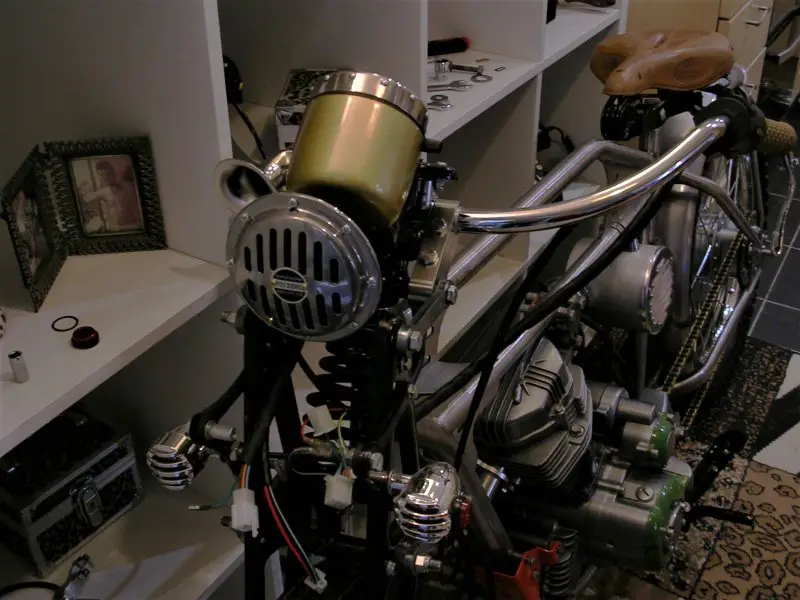

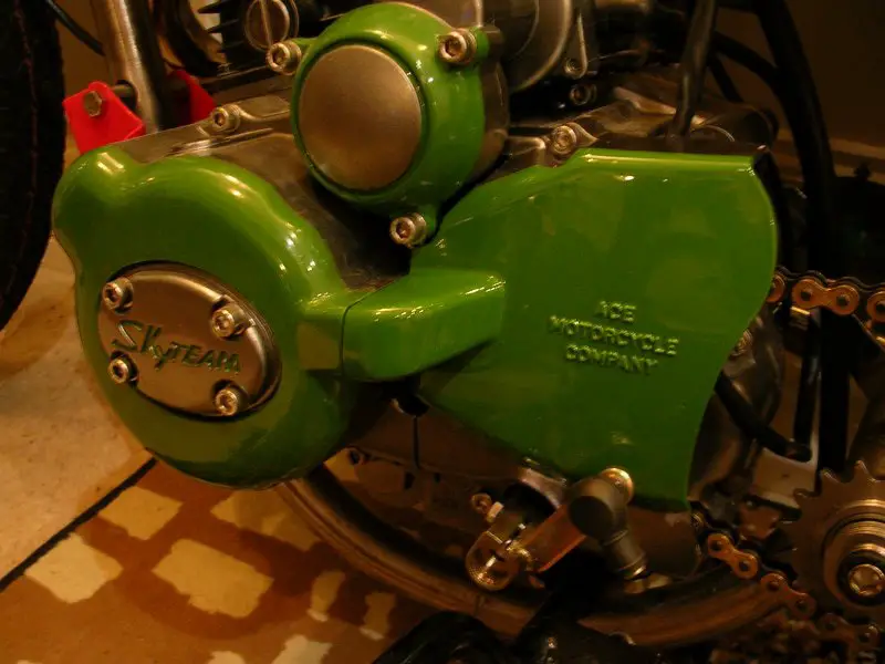

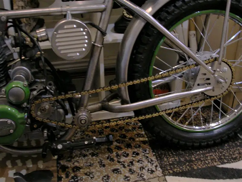

Here's a few more of the ACE's details I didn't get a chance to post in the last few weeks.
Created some raised lettering on the motor's sprocket cover before repainting it.
Fitted a vintage style horn up top on the forks.
Idler sprocket arrived from the US, so the ACE's chainline is now sorted. Idler along with a couple of spacer washers conveniently located directly onto the pedal shaft in the frame's bottom bracket, meaning now chain comfortably avoids the frame's chainstay.
