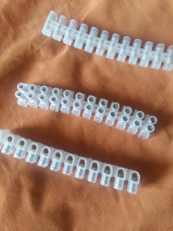

Pete I use these screw terminal strips to hook up the small diameter wires between the controller and the throttle , ignition lock, or any accessories. I tin the wire ends. Strips can be cut to length with shop scissors to the number of connections required. I use a heavier duty terminal block for the large gauge wires handling the higher current. Really helps in initial setup and any future replacement of components. These wires are small and short and get shorter each time you cut and solder in the future. I have wires running through panel grommets so detaching wires one way or the other would be problematical even though some are plug in all plugs are not compatible. The terminal strips seem the best plan for me and make wiring look organized, sanitary and secure.

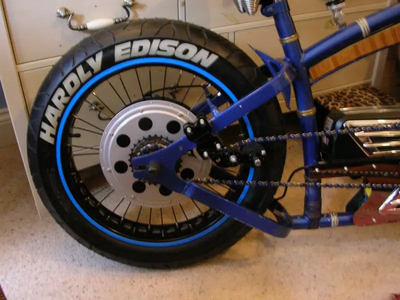

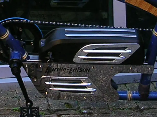

Did get a chance to refine the look of BLUE BAMBOO's hub e-motor though. As purchased, the all black hub and wheel did nothing for me. I was happier with the look after spraying the hub silver, and even more so when I added the blue rim blades to the wheel. I still felt the plain hub needed to look more sprocket-like, so with the addition of black circles I finally ended up with the look I wanted.
