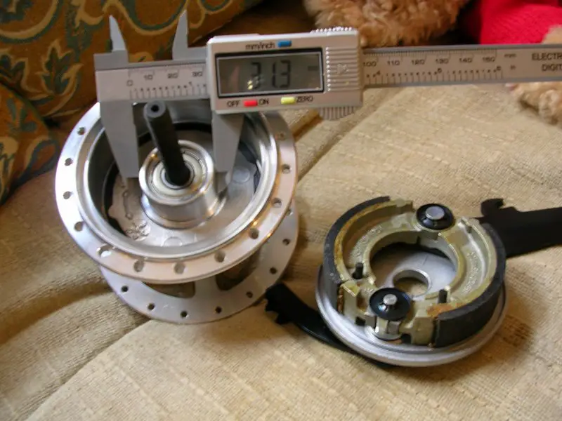

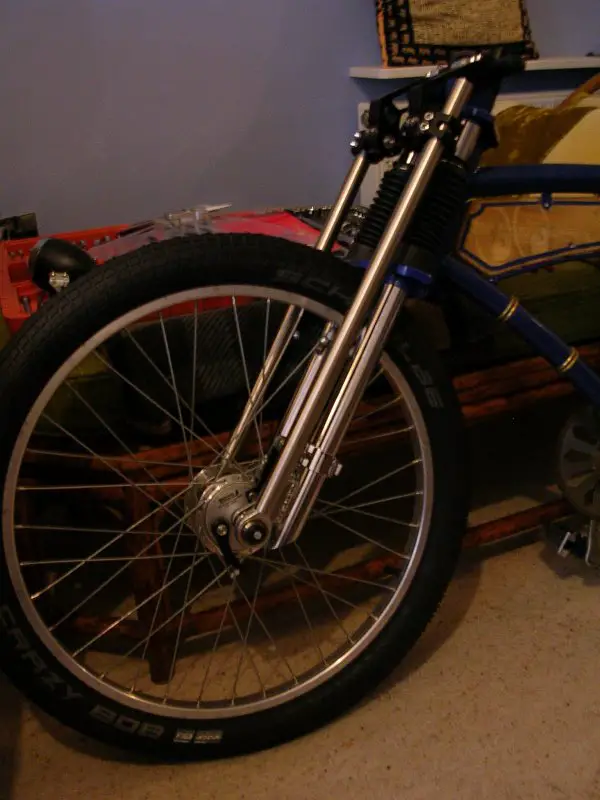

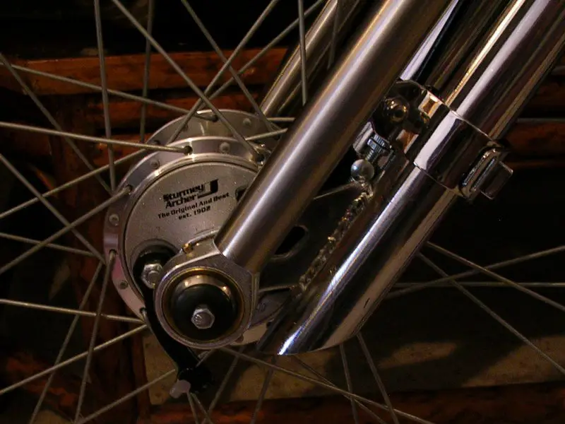

No dice. Pic shows the S/A brake hub internal bearing housing measures approx 31mm o/d.

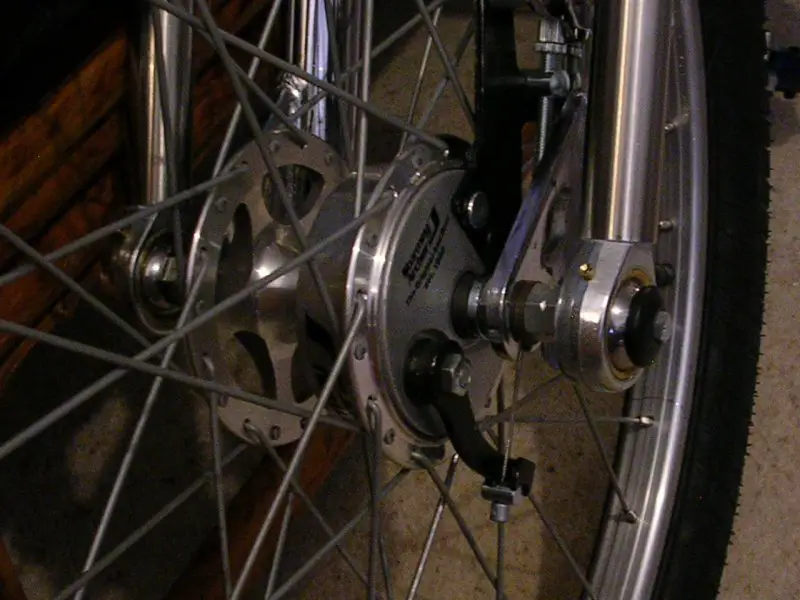

Used a pair of 16mm rod ends to locate the lower ends of the leading fork legs to the hub's axle nut. Domed ends of both m9 Axle nuts were drilled then tapped to accept m5 fixing bolts secured through rubber dust caps,holding everything firmly in place. Pleased how these forks are turning out.

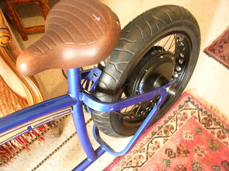

20x4-1/4" rear tyre now mated to wheel. I had some chrome vinyl wrap film left over from my Aero Cycle Car project, so I applied some of this to the wheel's rim band and I reckon it looks cool peeking through the holes machined in the rim. Tyre fitter here in Alnwick loved it. Went with a standard sized replacment rear tyre for now. But I reckon I'll soon be swapping it out for a taller 120/80x16 or 130/90x16 motorcycle tyre to give a heftier look to the bike's rear end.

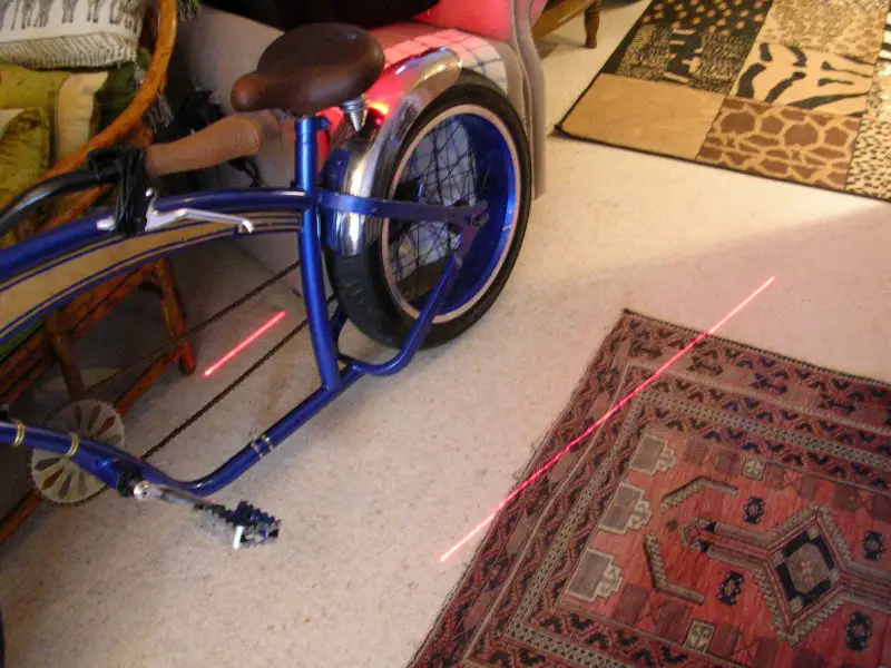

Decided I'll definitely need working lights/indicators on this build, so I've fitted a nifty wireless tail light with multi selectable features fixed firmly under the saddle. Operated via a small button pad fitted to the handlebars, this means I won't be doing much hand signalling. Not sure if I'm a fan of the light's 'laser' function which projects a bright red line down onto the road either side of the bike. Presumably in an effort to 'claim your space on the road' it'll probably have the opposite effect and antagonize car drivers.
I already have a small headlight to hand for this build. Just need to provide a rear stop light - and I've seen a small 'inertia' brake light on eBay that'll fit the bill.
The pull back handle bars are great. Definitely add to the look and riding comfort in my books. Laser lines on the road may invoke an unpleasant reaction from motorist but they may help to guide them away from you as well.

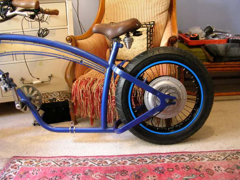

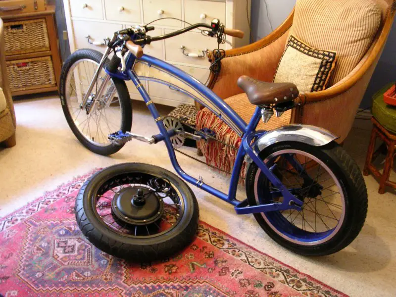

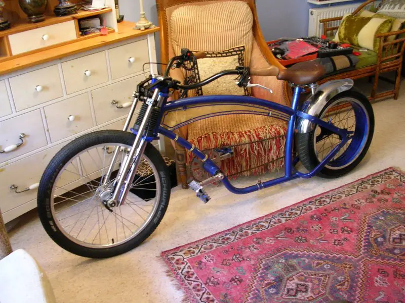

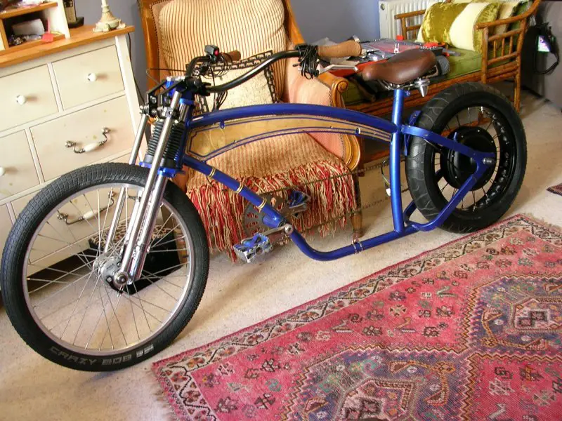

eHub rear wheel temporarily installed - and I'm not digging the look as is. Firstly, I'm not at all enamored with the black rim look on this bike. That'll have to change, so a rim repaint is in order. Secondly, the new 20x4-1/4" tyre I purchased looks fine, but there's plenty more available space in that rear triangle for a bigger tyre. Got my eye on a 120/80x16 Bridgestone Battlx listed on UK eBay right now, and I think that'll be a bigger/better option. There's presently 14mm (1/2") chain clearance between the 4-1/4" tyre and chain as pictured, and upsizing to a 120mm wide tyre size is the max width I can squeeze in before having to drop the chain down a gear on the wheel's cassette to create some extra room. Thought I might have room for a 130/90x16 tyre, but turns out that's just going to be too wide. Oh, and fenderless look gets my vote.
First it looks great!
Paint's not my forte, but I have confidence in your judgment, so both rim's colored the same. I don't like the silver and black rims together so I'm not a fan of silver and blue on the wheels either. Wider tire I'm all over it for this bikes bad boy style, if both width and diameter will fit up in the frame. Bigger is better. Heck yeah fender less! Though I like the bobber fender if it were painted to match the frame, with bamboo flair.

Thanks for the kind fender offer Curt - but fenderless vote has already been cast.
OK, here's the plan wheelwise....
Always intended to match-up the wheels by replacing the front 24" hoop with a black one which I have here. Spokes swapped-out for black ones to match those on the rear wheel.

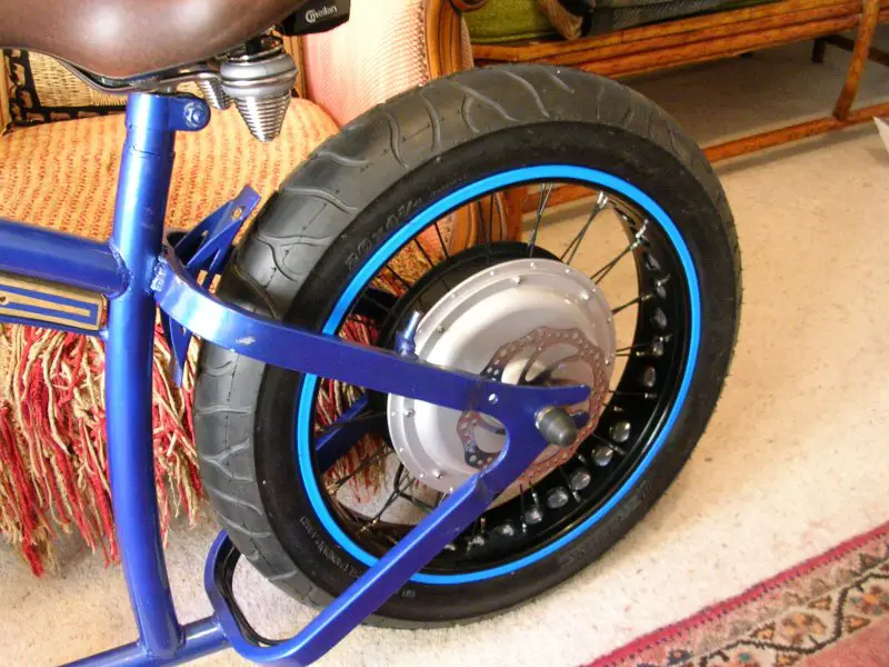

Just not happy with the lack of distinction between rear tyre/rim as things stand. So instead of repainting the rear wheel, I'm going to fit both front/rear wheels with Rimblades self adhesive rim protectors. Colour coded blue to match the frame's paint. May even try some air-brushing on the Rimblades to maintain the faux bamboo theme.

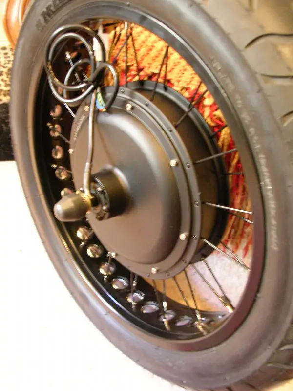

That eHub looks like a prime candidate for chrome vinyl wrap which I have plenty of. Just not sure if heat may be an issue. If so, I'll resort to Plan B and paint it silver to match the Sturmey Archer front hub.

Still interested in upsizing the rear tyre. Just haven't had any response to my enquiry asking for the tyre's o/d from either of the two guys on UK eBay who've listed 120/80-16 Bridgestone Battlax tyres. Not gonna pull the trigger on a purchase till I establish there's room in the bike's rear triangle.

Rick, I'm not concerned about width on the rear tyre. Plenty space in the bike's rear triangle width wise. I just need to establish the largest tyre o/d the triangle can handle. There's room a plenty for a larger tyre - and more if I remove the rear fender mount. I've seen PC's dropout extender plates. Won't need 'em on this build - but they do enable up-sizing to a 24" wheel should that ever be my intention in future.
Rear wheel looks wonderful, Pete. The hub motor looks so much better silver.
