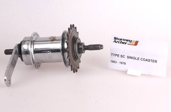

Something I found with the Sturmey Archer coaster hubs from the 1960's is that they have a plastic oiling bung and when this is lost or falls out the hub gets full of water and grit which doesn't do its inner workings any good at all. When I was overhauling a coaster hub for my Hercules the only spare hub I found that was any good inside was one that still had its bung in place. All the rest were filled with a brown gritty paste and were completely worn out.
Truth be told I much prefer the earlier SA hubs that have a proper steel flip top oiler, but they are getting harder to find now.
This is wot I'm using on the Hercules.
They don't need the production of a small oil producing country diverted through them, - just a few drops of oil every week or so if the bike is being ridden most days. I much prefer the oiler hubs that are fitted to my older English bikes because they roll much more freely than greased hubs. They fell out of favour of course because they meant you actually had to pay some attention to bike maintenance and the other thing was they tended to be a little messy, but nothing a wipe over with a rag couldn't keep under control.

The oil cup issue is easy to solve. Ditch the plastic & put a fresh oil cup in:
http://www.mcmaster.com/#oil-cups/=w3ywuq
Same goes for anyplace you would rather have a cup & a wick. Just drill the bottom bracket for a cup & put in a bit of wicking.
B
Oooooo nice :) What a useful link FFV8. You are so lucky having McMaster-Carr in the US as we don't really have anything like that here in New Zealand. I wonder if McMaster-Carr would ship an order to New Zealand? The only problem would be that the postage cost might be awful.
My older English bicycles have oil cups and they are sooooo good when it comes to giving my bikes a lube and service.
