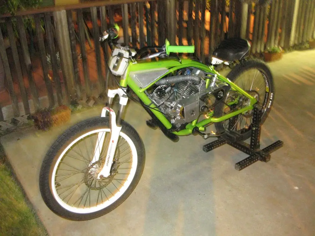

The last vehicle I would ever think of mounting a 212cc Predator, would be on a MotoPed. Being not (remotely for any reason what so ever) designed for that type engine you are just wasting your time and money.
Build the MotoPed with the engines they ARE designed for and have a BLAST!
(Just my thoughts without really thinking laff )

The last vehicle I would ever think of mounting a 212cc Predator, would be on a Bicycle. Being not (remotely for any reason what so ever) designed for that type engine you are just wasting your time and money.
Build the Bicycle with the pedals they ARE designed for and have a BLAST!
Yeah.......and it's race proven! dance1

My point exactly! Your bike is one of the most awesome builds ever, with the race credentials to back it up. In my opinion it borderlines on art. That's why I couldn't believe you of all people would tell someone with a dream of creating something truly unique not to waste their time and money doing it. When I built my 1st Motoped I didn't want to be like the rest of the sheeple running those heavy E-22 clone motors with clunky transmissions, I wanted more. More horsepower or more torque. Initially I was going to go big horsepower with a 45hp XR50 motor but changed my mind and went with a high torque setup instead. I'm pretty pleased with the 180ft lbs of torque my Motoped makes, it's a blast to ride and I personally don't give a rat's a$$ if anyone thinks I wasted my time and/or money.
