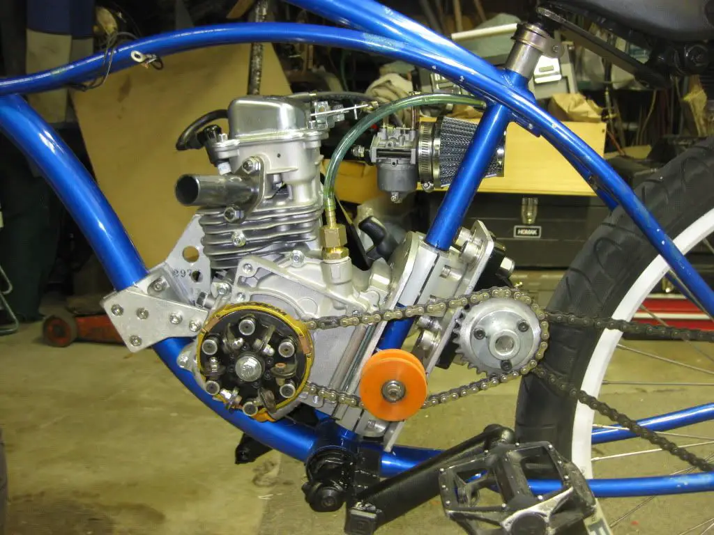

This was my motored bike.
A bicycle I built from parts:
And a mill I built from scratch:
Which I used to make parts for the motored bicycle...
And now.. I goto my garage.

Well, that engine isn't going to work. After installing the sprocket, and checking stay clearances, this is a non-starter.
Okey, now my idea for an engine is toast. Where do I find a X wahtever engine, to try for this formula.

It's not exactly little. And it's quite wide. I don't think it would work in this case. :-/ I"ll go take measurements this evening. But it doesn't look good.
