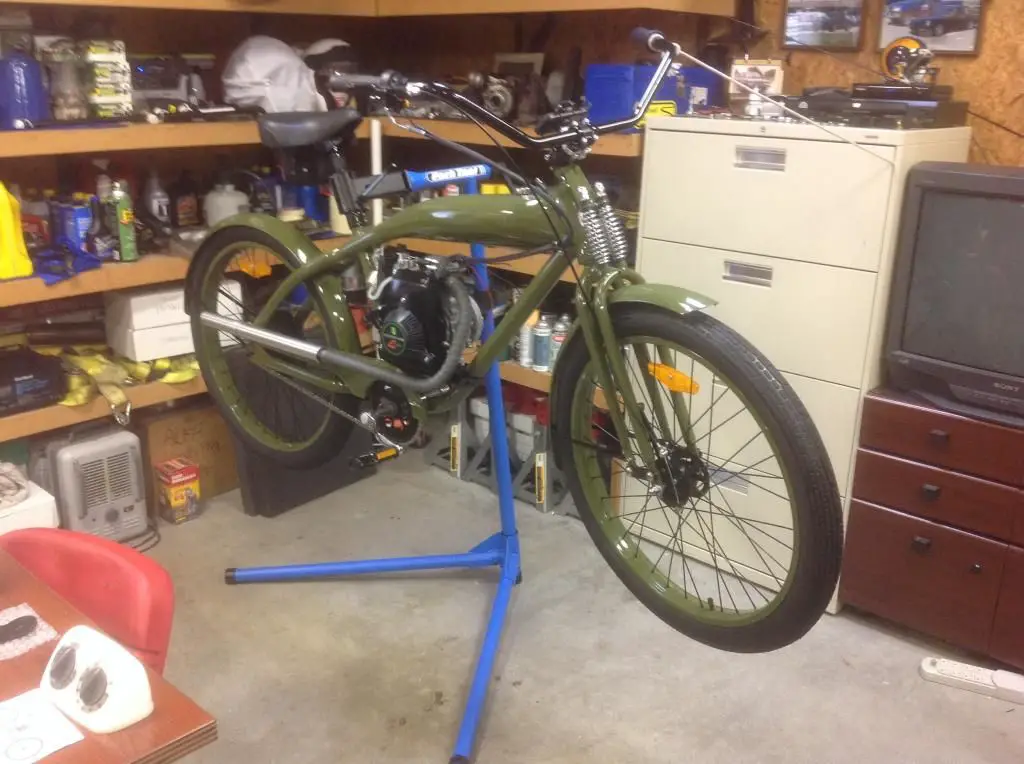

Not a ghost racer just the base ghost bike with the engine kit plus exhaust pipe and yet to be put on big light (wiring is done just waiting on replacement light).
Also waiting on a tach and hour meter to come in (Wednesday) and get that installed then fire it up and take it for a test drive.

I'm impressed with the quality of the Phantom Ghost bicycles and their 4 cycle engine. I'm almost done building my kit which was the the base ghost bike with the engine kit. As soon as the picture I uploaded gets improved it will show up here.

How will you improve it? How long will it take?
Right now I'm just adding a tach and hour meter, rear flasher and a mirror. I posted a link to the tach/hour meter below.
http://www.northerntool.com/shop/tools/product_524744_524744#
Future mods might be something to tell me how fast, how far and my times. Nothing planned for go faster mods at this time.
I took me a solid week to put it all together....but still need to install the light, tach/hour meter and finish the wiring.
Looking good! Phantom does have nice (but pricey) stuff. It looks like his Ghost DIY kit. Of course you know this thread is about the Kings/Gasbike 7G Ghost Racer kit and not the Phantom Ghost. They sell similar frames and motors but not exactly the same. You should probably start a separate build thread.
