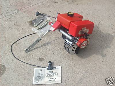

Excuse Me For Buting In. I Just Want To Try Pic Posting Again. MOST OF MY PICTURES ARE JUST TO BIG. THIS IS A PICTURE OF FRICTION DRIVE THAT SOLD ON EBAY. THE MOTOR IS ON THE WRONG SIDE. THE MOTOR RUNS BACKWARDS. IT THOUGHT THE NEGATIVE MAY HAVE BEEN REVERSED. NOT SO, THE PRINT ON MANUAL IS CORRECT.

All weedeaters I have seen turn counter clockwise. However all the chainsaws i have worked with (two) turn clockwise. Go figure

A two stroke engine will run both ways it is up to the manufacturer as to the direction they want it to go. Some of the mags on these engines will let them turn in reverse and still spark, if they will you can run ether way. It will just be retarded in reverse, you will need to move the timing with the flywheel. Have fun, Dave
I ran one backwards and found that the nut that held the drive wheel on would constantly come loose. I went back to mounting them the way the manufacturer designed them. Knowing they will run backwards was important to me but doing it just wasn't that big a deal the way I do things.
