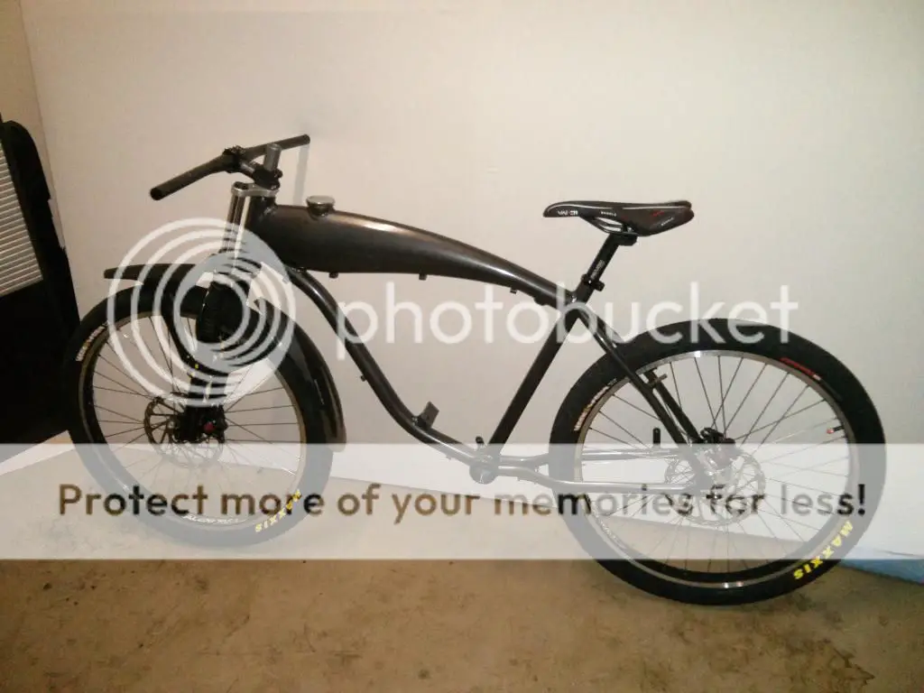

    OK so the rims are Alex dx 32 rims both F and R.
    32mm wide, 36H black. They also sell a 32h version but I chose the 36 to have more spokes.
    No modifications to fit 2.5" tires.
    Spokes are 13/14g butted. Nipples are alloy 12mm. Rear hub is a 3 speed SRAM imotion disc version and front is a shimano xt with disc.
    I hope this helps. I bought everything online and I think each rim was approx 34$.

    Really shaping up suweet

    Looking excellent!
    How about a little better pic background for the next shots please?
    It's kinda hard to see detail with a wall of stuff in back ;-}

    Will do ! Until now I needed a place to put it since I'm building a motorbike type stand for it too. Lots of things in the works. Stay tuned.

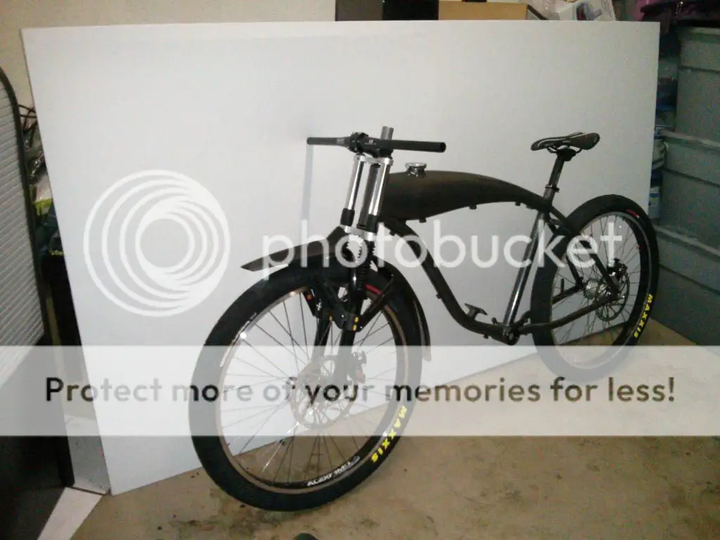

    More pictures! This time without the rubbish background.
    Added a temporary seat, headset and handlebar. Thinking of changing the handlebar from a flat to a riser type.

    You are going to love those forks. I have had 2 sets and have one on my current ride. I'm digging those fenders for some reason! IMHO...I think a riser type handlebar would look better...just my opinion. Might be a little more comfortable as well.
    The bike is really looking great! What engine are you going to use?

    And nice job with a photo wall bud!
    It really makes a difference in the detail we can see with your progress and it looks great!

    I ordered a different headset and handlebar I just got desperate and wanted to mock it up.
    For the engine I think I'm gonna go with a bicycle motor works racing engine. I'm trying to finish my build as a normal bicycle and then install the jackshaft and engine to it.
