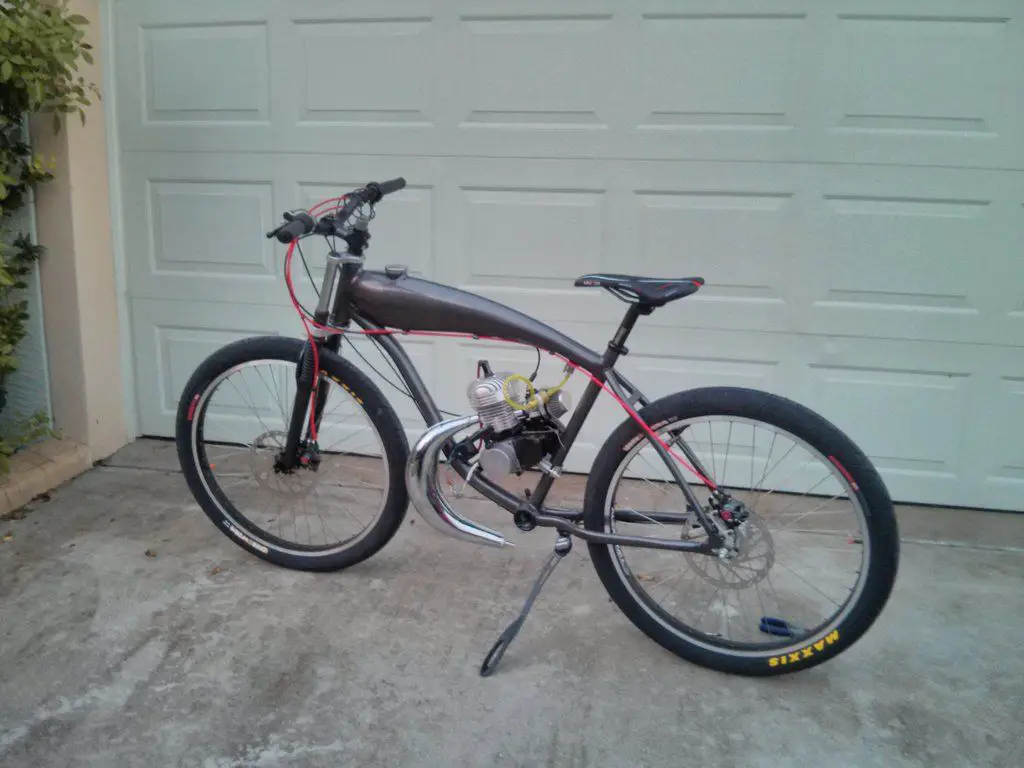

I been looking at that fender, how do you like it?
The fender looks pretty good in the bike BUT there isn't much clearance to the tire. I removed it and will install it again after I test brakes and the shift kit.

A quick rundown of the costs:
Frame 125 plus powder coating 75 = 200$
Rims, Spokes, front hub and rear i3 sram hub = 300$
Tires and tubes = 75$
Front fork = 95$
Headset, stem and handlebar = 80$
Custom Racing Engine with clutch and accessories = 450$
Brakes = 100$
Still to add
Exhaust = 75$
Shift Kit = 200$
So almost 1575$ with a lot my precious time
I think it is worth it .. specially if you consider that if you were to buy a bike like this from a retailer it will cost you waaay more.
