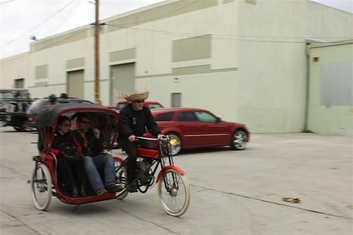

yes i am loving cali to much.. picked this up- free!
