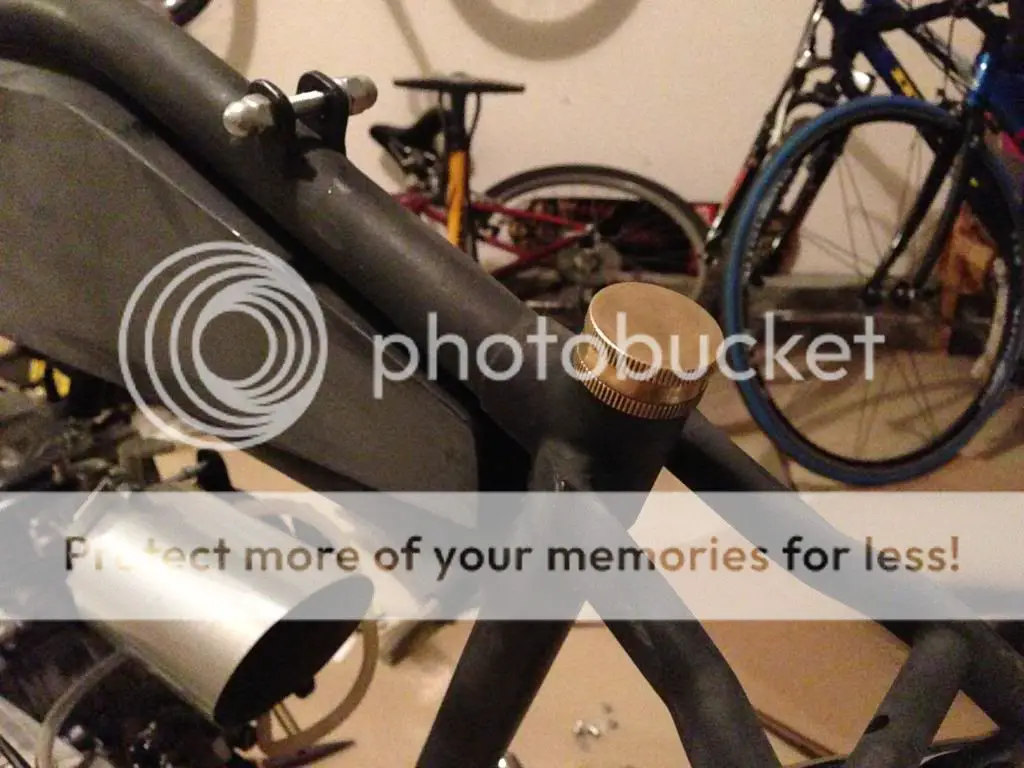

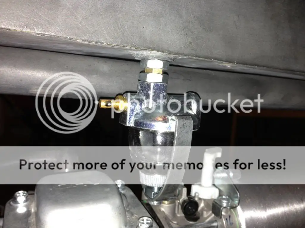

Radio controlled gas engine cars web site? if you got the plumbers fitting type cupler you could twist a piece of either aluminum or copper line down wards, that would look cool as well as suite you're purpose as a pressure equalizer.
Nah I'm not talking about the fuel level monitor, some one had a fuel line come out of the cap for ventilation, I'll try to find a pic. A small air filter would look good, any idea where I can get a tiny 1?
I've seen what you're talking about, I've seen internal lines that follow the seat tube and exit below the bottom bracket via a copper fuel line. I also really like that look....... I'm really liking this build so far. Very cool with many handmade parts by the owner, just how I like em.
how does it connect to the cap; does it connect to the cap?

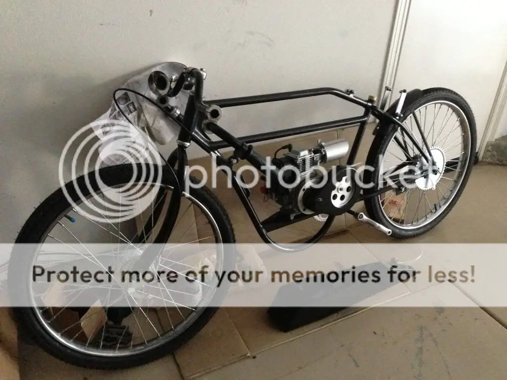

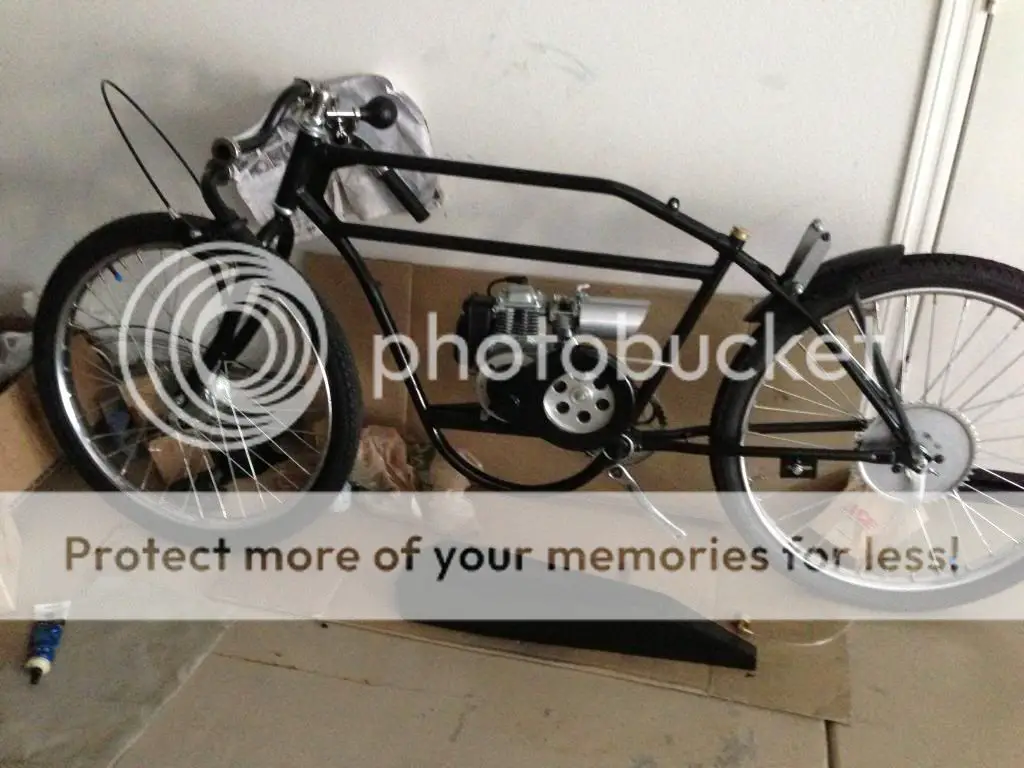

here are some more progress pics:
had to fill that hole that was left over from the seat post:

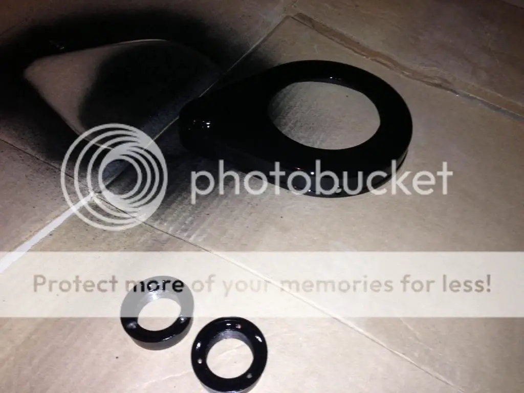

had to repaint the clutch cover and the bottom bracket adaptors:
and heres an overall pic with some parts on the side:

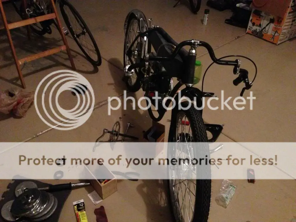

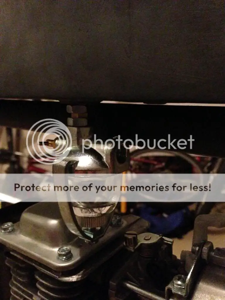

some more update pics:
still working on painting the gas tank, I must have had 1o coats on it by now by the paint just doesn't sit right so I keep sending it down and repainting

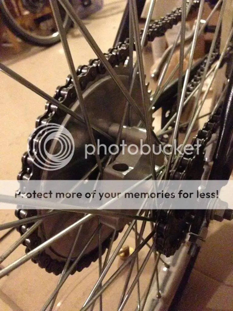

Try a light sand paper for color sanding, then clear coat & buff, everything looks beautiful, when yer done yer go'n have a nice bike! I just hope yer not using a kit rear sprocket with squash adaptor.
noway lol, I spent half a day customizing the adaptor to make it fit:

Very nice! how many teeth? Dan ain't going no where so when yer ready give him a Jingle, but while yer waiting to resolve yer issues keep a lookout for the forks on Ebay and remember the forks have to be 2 7/8" -3" wide at inner top messure your steer tube and ask questions about the product, we've all had bad experiences so play it smart(er) this time.
