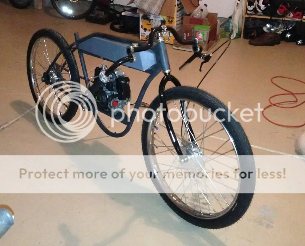

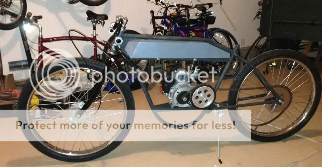

finally building a BTR inspired motobike
heres an idea of what i want my bike to look like
2 last suggestions,,,,,,put a half rear fender not a quarter fender you'll be sorry later because of all the crud you'll kick up on the engine,bike and clothes.
Add front and rear engine mount plates (shiny aluminum) if that is your final on engine mount design,it really will make it look like part of the engine insted of a filler piece under it.
i beleive the final mount will be a tube welded from seat tube to the down tube with the mount plate on top. that black filler is still tentative. i like your idea for the front and rear engine mount plates. ill still have to find the aluminum pieces and design them to fit around the actual mount

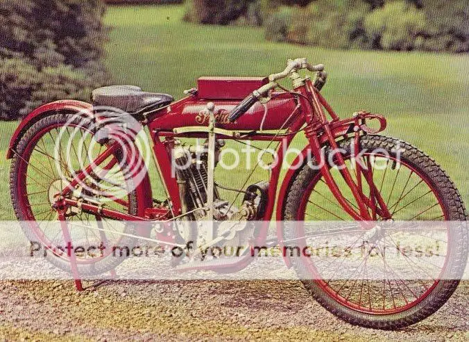

One last design.
I don't mean to intrude on your build and design or desire's for your bike,you've done such a fine! job to this point, you have taken some advice and you've got this far already,you my friend are on your way to achieving an authentic period correct looking tribute bike, don't be to hasety with quick decisions and or half step anything including the design just because it might be easy at the time.
I love it when some one builds a proper running and asteticly beautiful bike thats where it becomes a real tribute.
Have fun (as I know you are!) and build the best you possibly can! perhaps this can shed a better light on the subect at hand (not so corny looking LOL!)

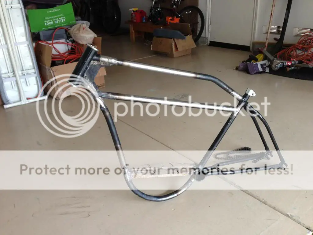

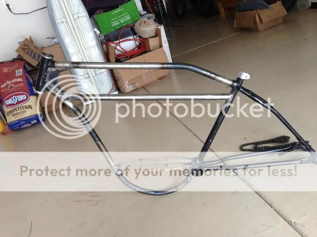

im waiting on maxvission to help me finish the frame, not much i can do without the frame lol. the downtube was crooked so we had to cut it off and make a new one, that whole process is is very time consuming without a professional grade tube bender. there are a few things i did on my own like got the handlebars straightened out and painted a nice high gloss color... etc hopefully we'll have the frame and the mount ready soon so i can start assembling it and putting on some of the details i have invisioned

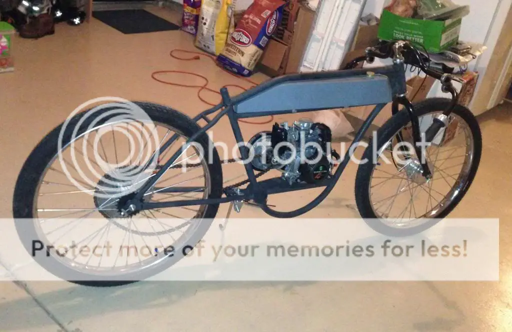

I've been thinking about different forks because this 1 simply won't cut it for the look I'm going for, I'm trying to find a monark 2 fork for a decent price but if I can't find 1 I will go with the vintage truss rod style fork

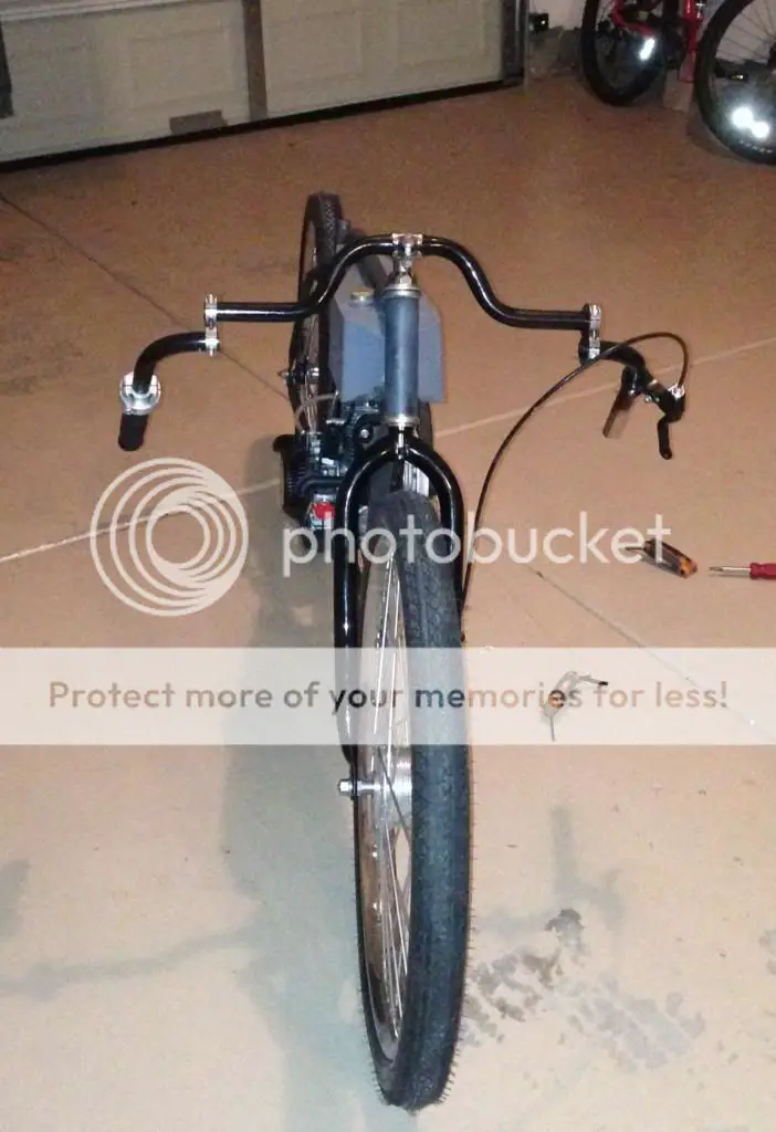

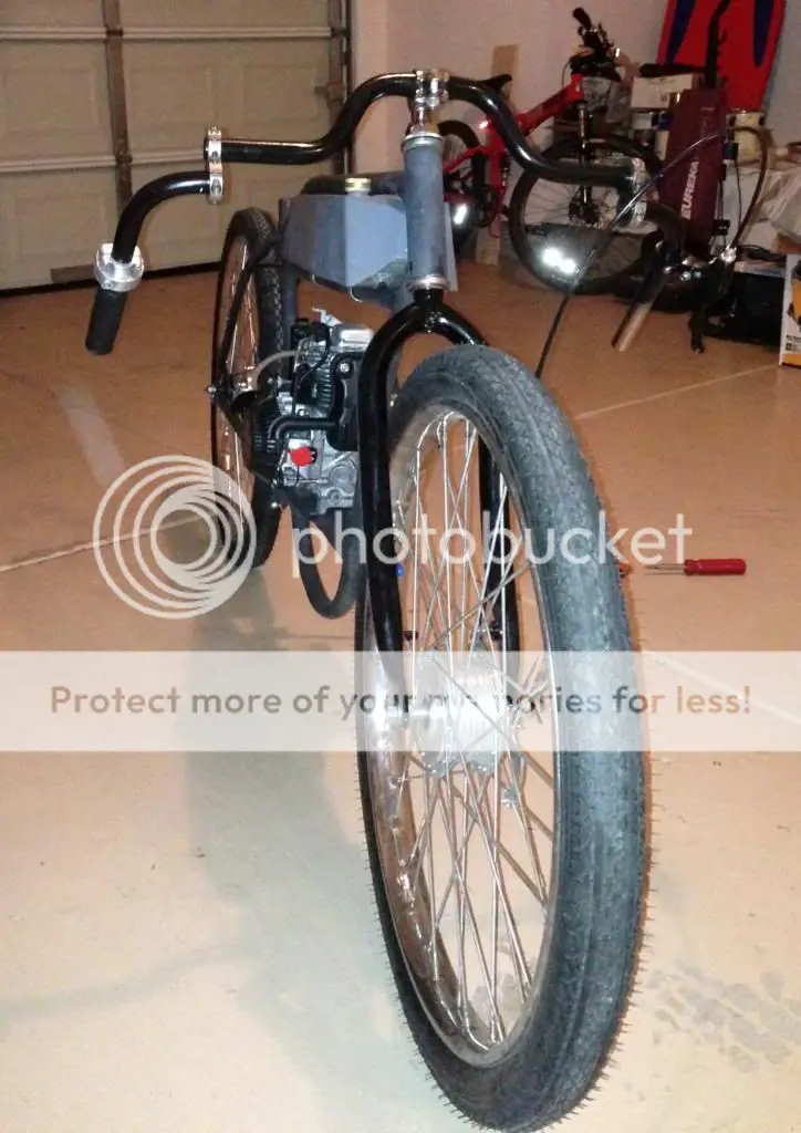

ok so i ran into a major problem:
the sprocket adaptor arms are too thick to fit through the spoke gaps, so i spent all after noon manually filing them down until they fit, sanded the frame down and applied a coat of primer:

I think those forks you have would look cool with truss rod and again the red bike thats always in the back groun photos has a nice set on them to configure a truss rod set up.
