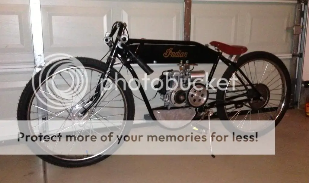

finally building a BTR inspired motobike

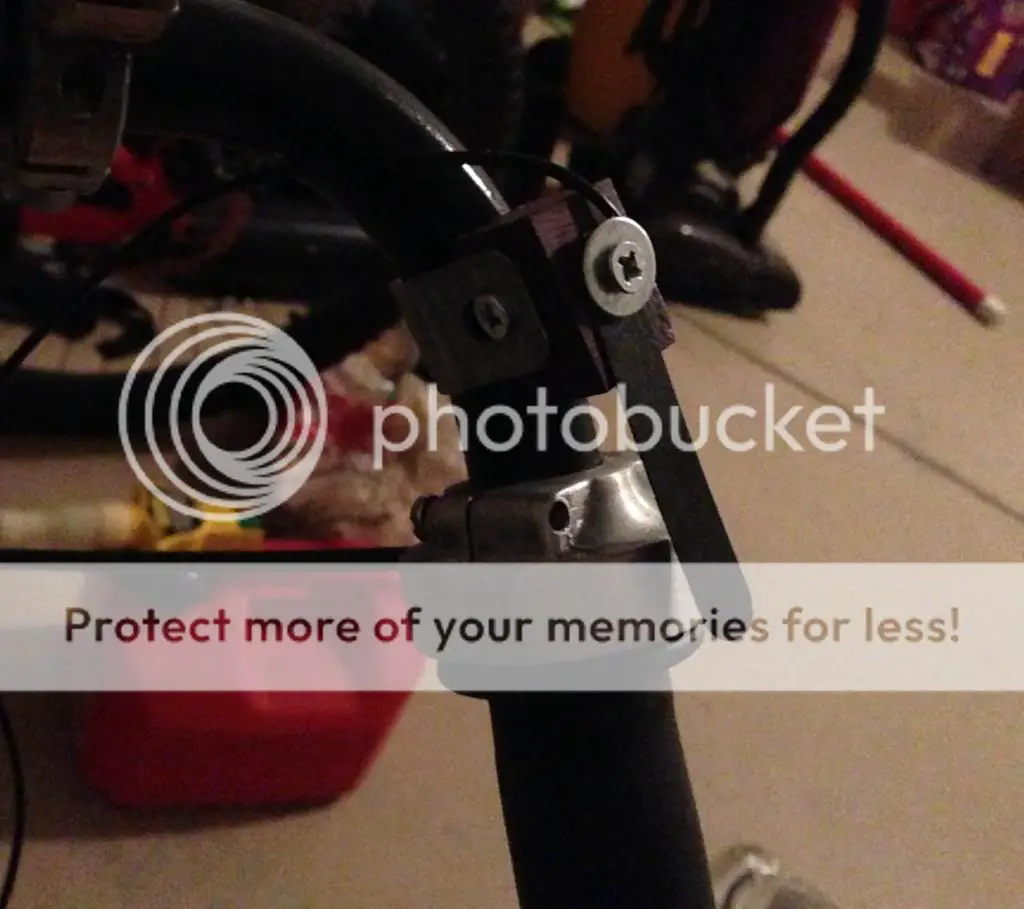

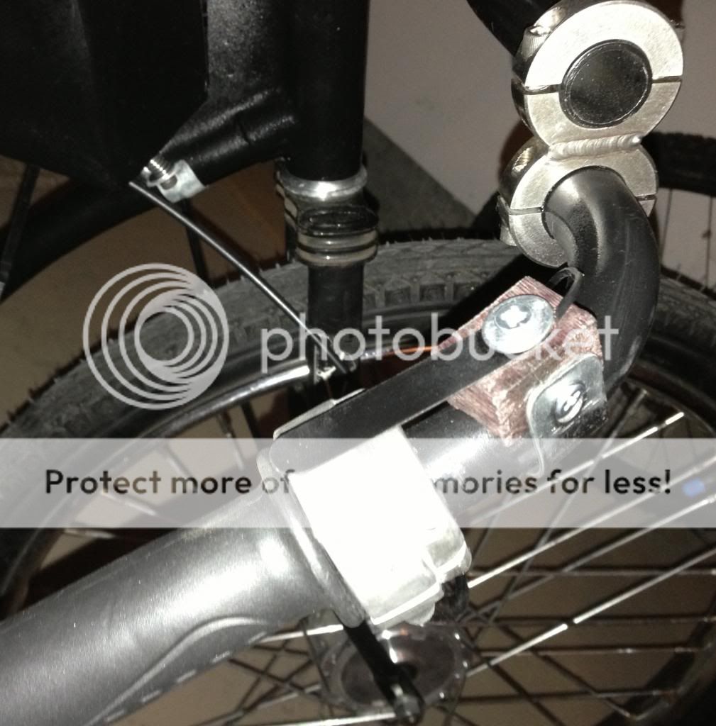

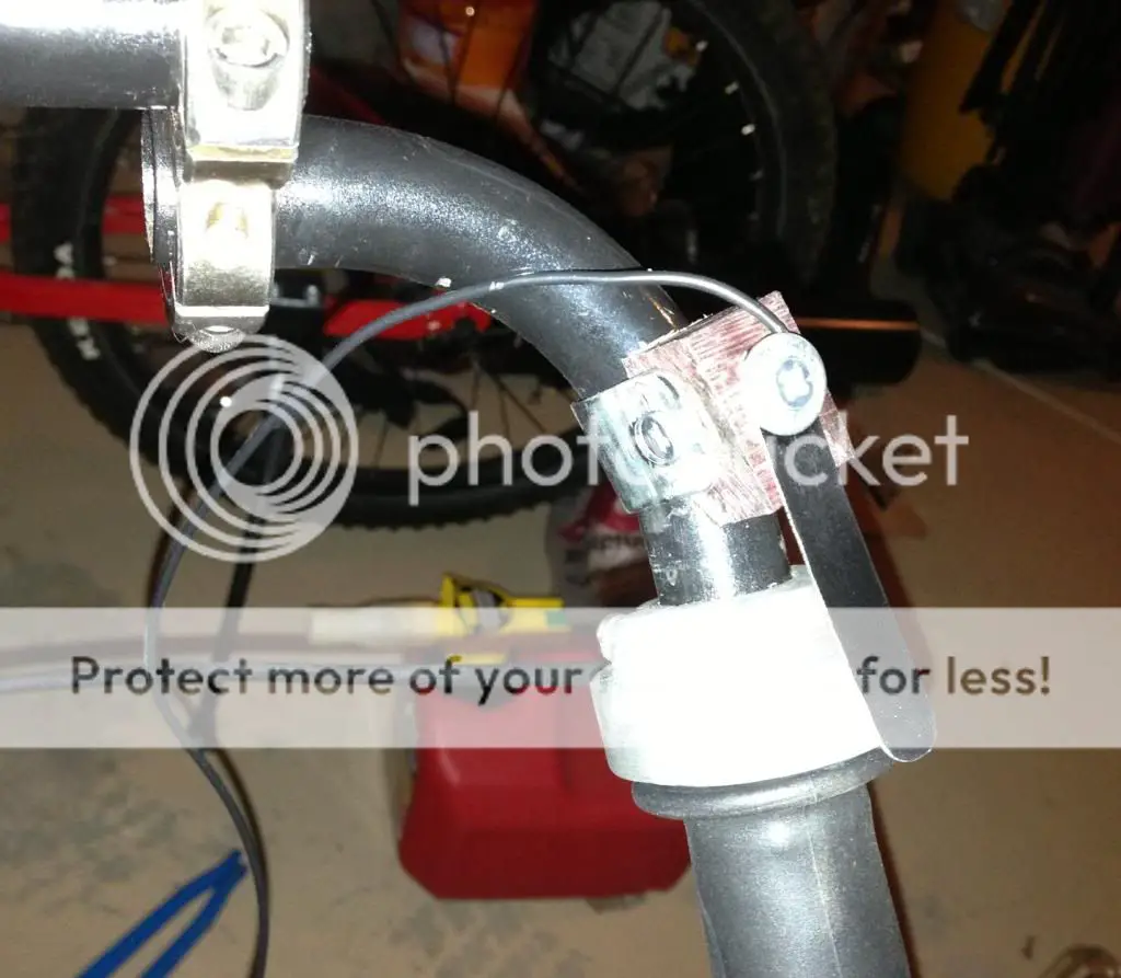

made an antique style killswitch, used a piece of purple heart wood, couple of inches from my hax saw blade, a kit tank mount and a piece of wire I found laying around:
P.S. works like a charm
Nice! and another alternative would be to use a rear chinee engine mount, but it looks cool! whats up with yer clutch ?

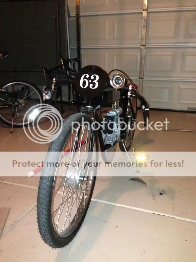

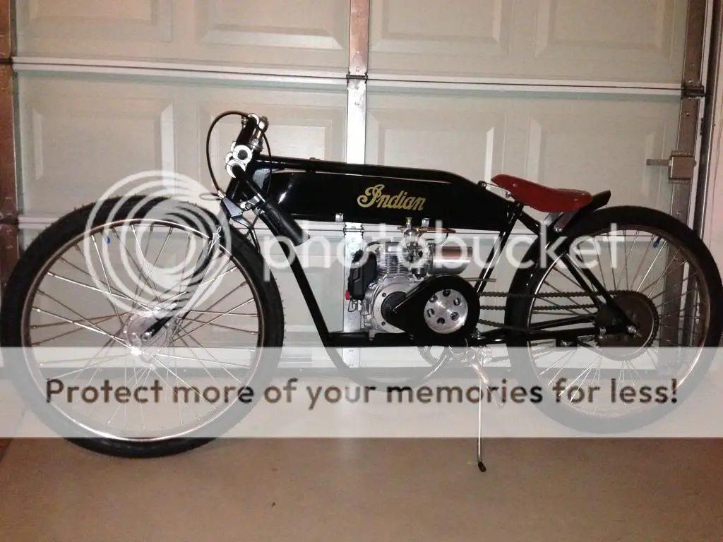

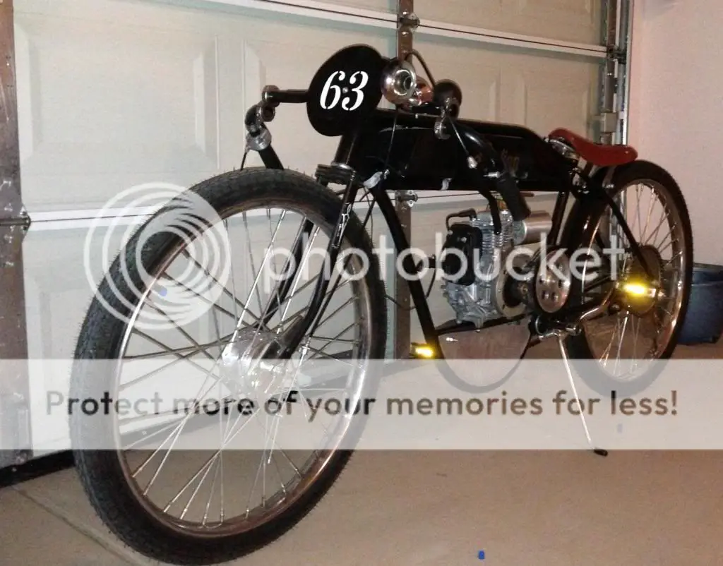

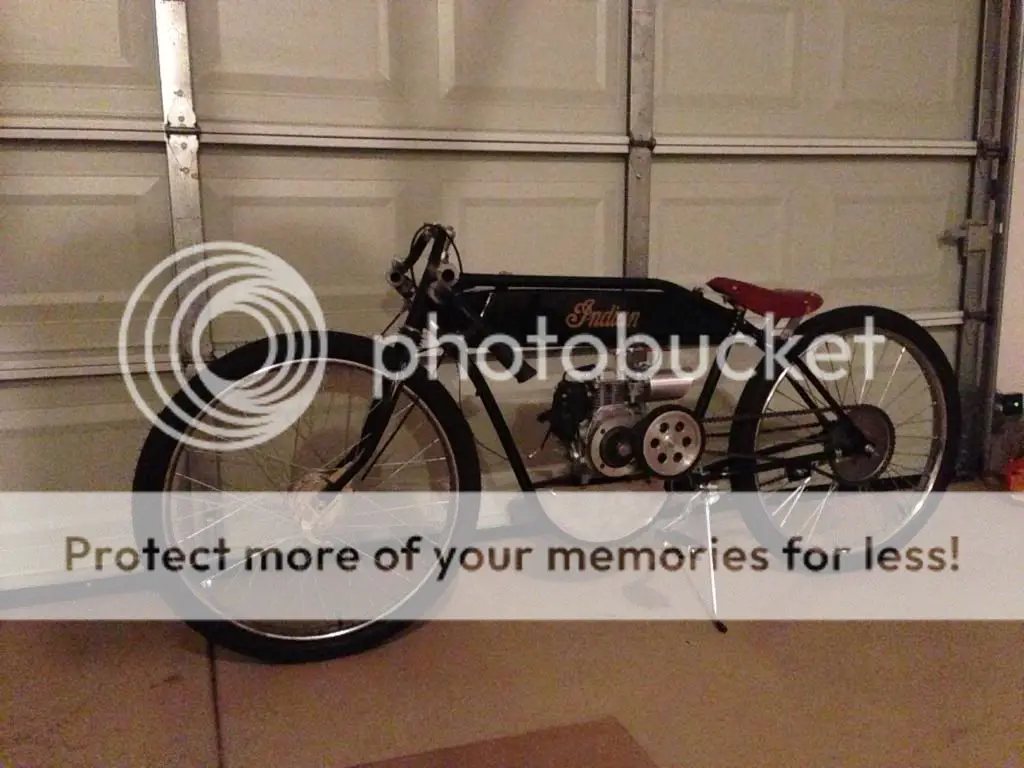

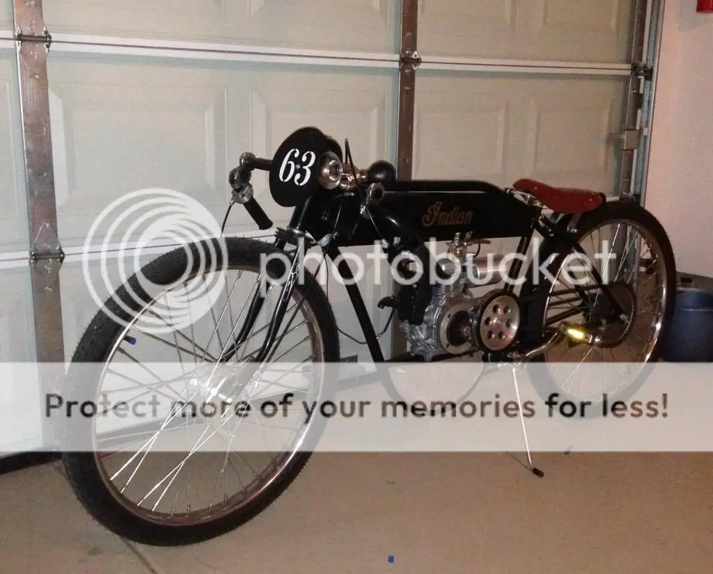

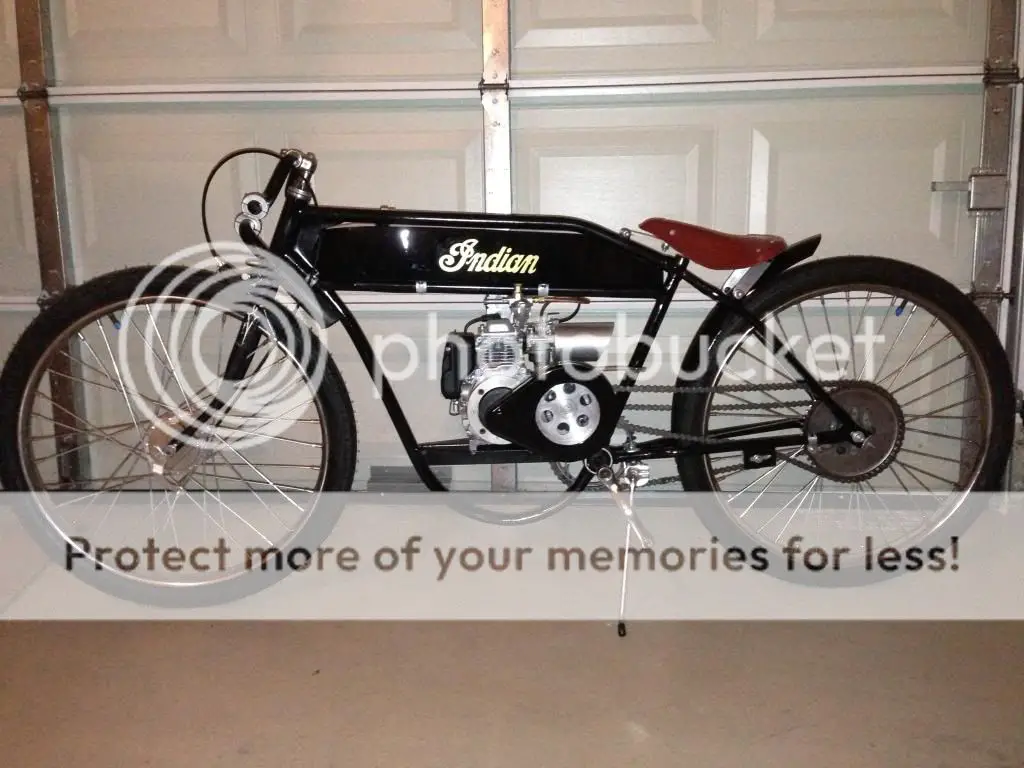

scored some sheet aluminum and made a crank case cover. still need to fab artificial mounts:
Now that's a Good Look'n BTR! I do like those forks even if they don't have truss rods, the style just fits the bike real proper.
Good Ol' #63 I like that, kind of sounds like a Jack Daniels commercial Nice Job is it done yet?
Thanks guys, no it's not finished yet, I still wanna work on the mount and make it look more like it fits. I'm also planning on replacing the spark plug wire and getting rod of the boot
