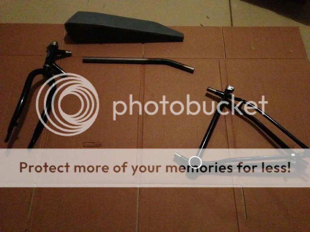

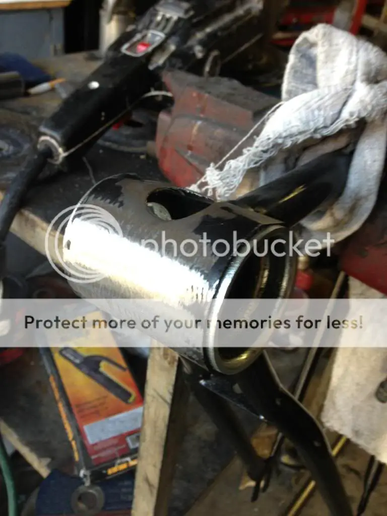

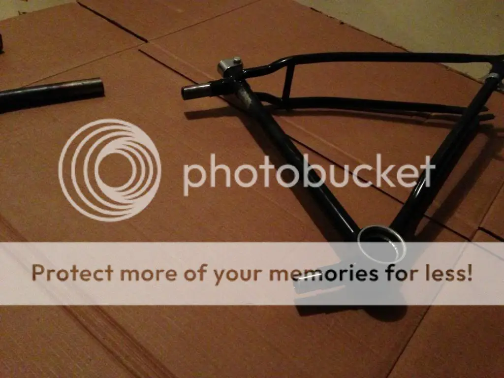

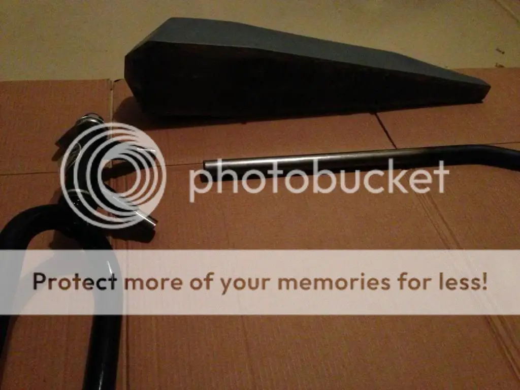

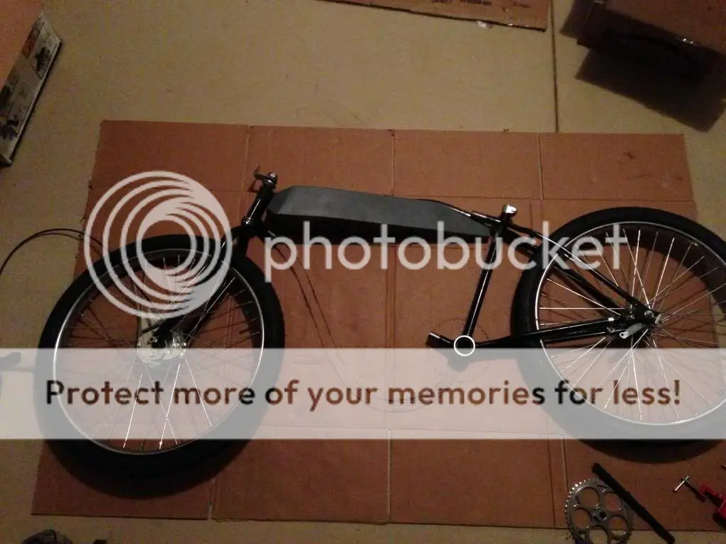

met up with Maxvision today, and we chopped up the frame. we were running out of daylight so i had to take the project home and draw out a diagram of what the frame should look like
Beautiful! Beautiful! you are on the right track, if you don't mind could I give a little advice, I think the down loop should come down about 2"( not really big #'s) and get the rear rise to the same angle as the seat post tube when connecting to the bottom bracket other wise you are doing a nice job and that tank looks So Sweet!
Not everyone knows but if you use just a little thicker tubing for the down loop you can get just a little more bend out of it without kinking the tube. and if you are going to re-braze it to the butted head set just turn down the tip of the pipe to the desired insert length.
Maybe you're right, I'll redraw the loop making it a bit smaller just to see what it'll look like
Longer! Longer! 2" lower then your scale drawing, bring the bottom of the loop lower, refer to the Indian in the begining of this thread, look at the last scale drawing you posted see the horizontal crease in the paper/cardboard inbetween the lower section of front & back wheels? thats where you want to be, any realistate between where the engine will be mounted and bottom of the inner down loop can be filled with either a realistic looking crankcase engine mount or faux(fake) crank case.
Dude Come On! you know you gotta watch for that any way! but really 2" is not a lot and here is a really quick rendering of what I was talking about, maybe this might help with the visualizing thing/(LOL!) remember if yer gonna do all this nice work Astetic's & design(looks) play a very important roll in fab

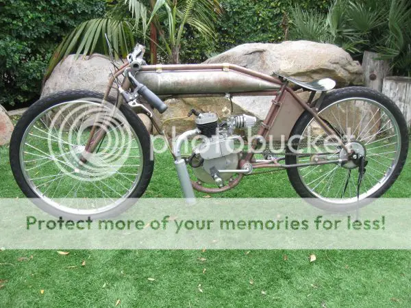

I agree with truckd, make it a little bit lower. Look at the Indian...that hoop is like 2" off the ground! To get the right look, that thing's gotta be LOW! that's how I did my drop loop and I think it looks perfect!
I'm actually thinking about bending up loops by the dozen or so and selling them to people doing a BTR drop loop on a worksman frame. the geometry I designed ties in very easily to the original down tube, and matches the seat post angle exactly once its welded up. Might be good for people that don't have access to a mandrel bender?
You Can also refer to my 1911 Indian ,look how low it is but yet it will still clear a speed bump if ridden correctly, what do you think about the crank case and mounting system I drew? something to play in yer mind with, you can have the Idea free of charge (LOL!) Ha! Ha!
i absolutley love the lines on this build, but his frame loop doesnt seem to go much lower than mine?
I say build it your way, just the way you mocked it up. I think it will look good. But then again who am I to say anything.
i will play with both ideas and see which looks better. thanks for chiming in
my frame is also stretched 5"
i also have to take Maxvision into consideration, he is the one who is helping me bring this idea to reality

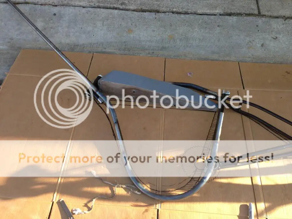

update:
went over to Maxvision's and we managed to get the don tube with the loop made (we made the loop a bit larger and lower:
by the size of that loop youd think im putting in a V twin in there lol
That looks so much better! and you will be surprized at how much realistate you'll fill with all the extra goodies you know your going to put on it and the other stuff you'll put on it as you go, lots of room, bike looks good! have you thought about the mounts I drew up real quick, not as hard to fab as you might think and it uses that extra little realistate wisely.
Remember to dry fit everything! before re-brazing or welding so you can avoid the headache later, you might catch something you over looked or want to make a last minute minor mod.
I know you want to build the bike the way you have it in your mind but do your self a favor and do some research on the indian motor mounts and others as well, it's that one detail for that area or part of the bike you just don't want overlooked or funky fudged.

\./ your bike is looking great, really nice!!!!!! This will be a nice one.
Trukd, you're full of ideas, are you finally doing your own fab work and welding yet?
thanks guys.
truckd:
im gonna have to come up with disguising the motor mounts a bit later, i definitely like what you sketched out on the previous page, i had something similar in mind as well.
harry76:
thanks, i cant wait till this bike starts to be put together. im getting more and more ideas every day
