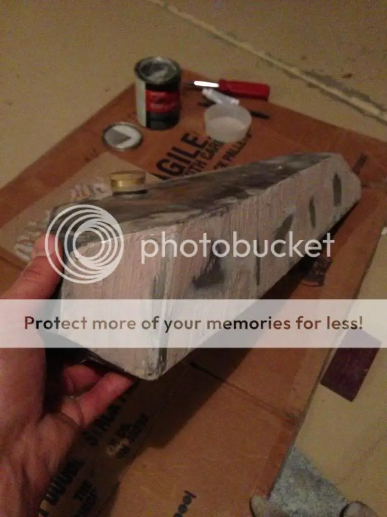

so i spent the last couple of days hammering, applying bondo and sanding the gas tank:

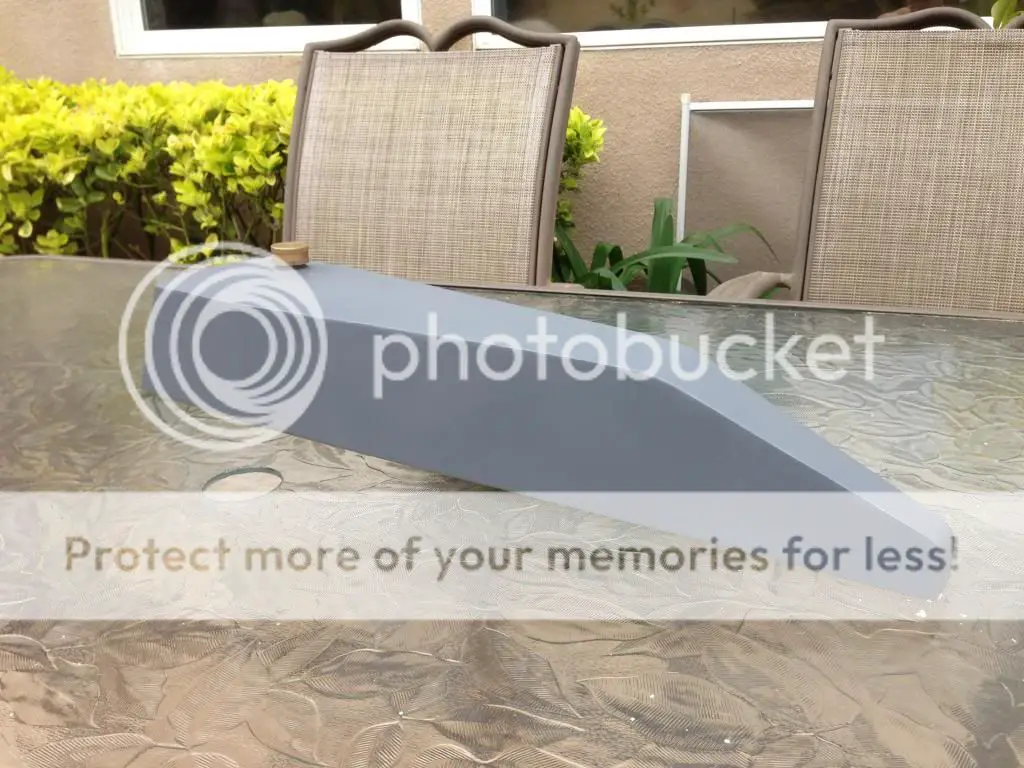

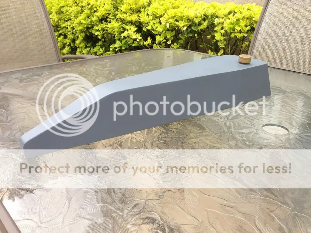

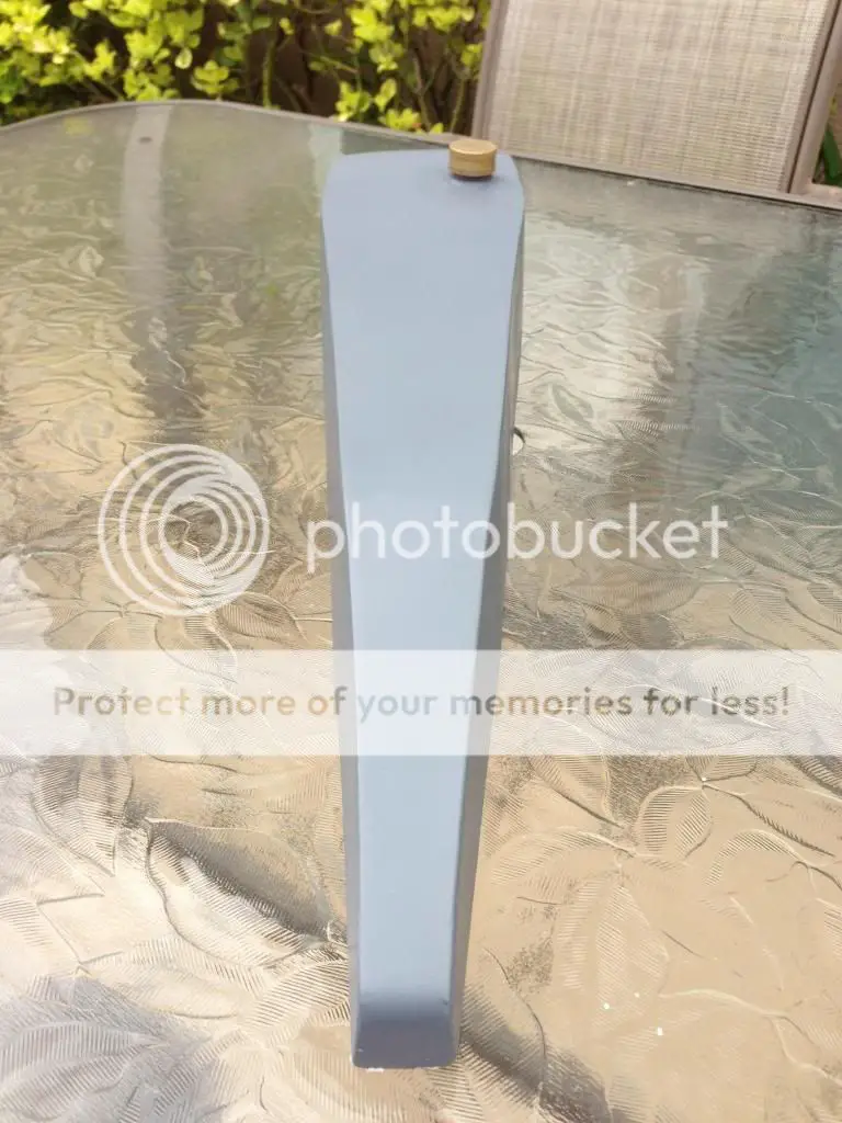

after sanding it down, i decided to apply a coat of primer to better see any imperfections (its easier to see dings dents and bumps on a smooth monotone surface, there were still small dings and crevices all over so i sanded it and re applied primer a few more times. finally got it to where i am happy:
P.s the photos make the tank look warped and wabbley, that's not the case in real life, I'll try to get better pics when it's finished

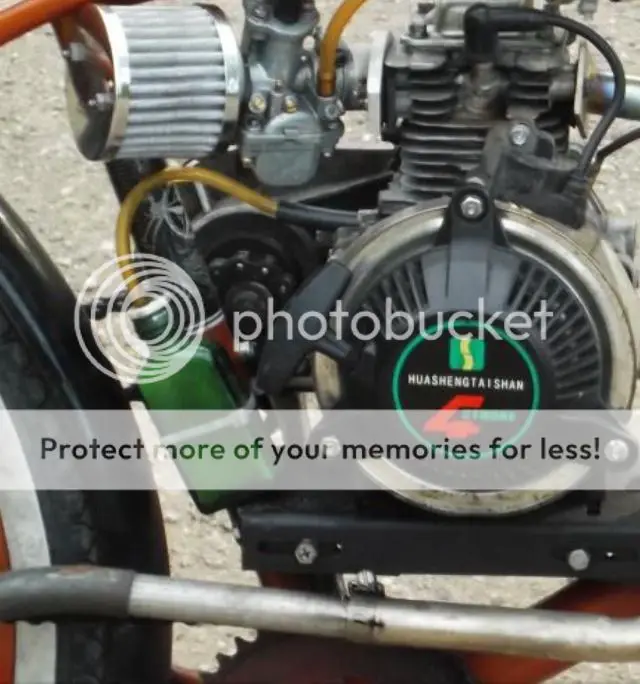

cool video, but i really dont like that plastic cover on the motor. im definitely planning on removing mine, maybe even shave down the shrouds for the pull start. theres someone on this forum who used a hua sheng and took the cover off, made the motor look way better:
Agreed 100%. Im not sure if that cover is for cooling the cylinder or something, but it looks a million times better without it. My last one i didn't care what it looked like, but im thinking of doing that to my current one.
