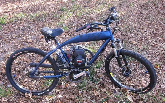

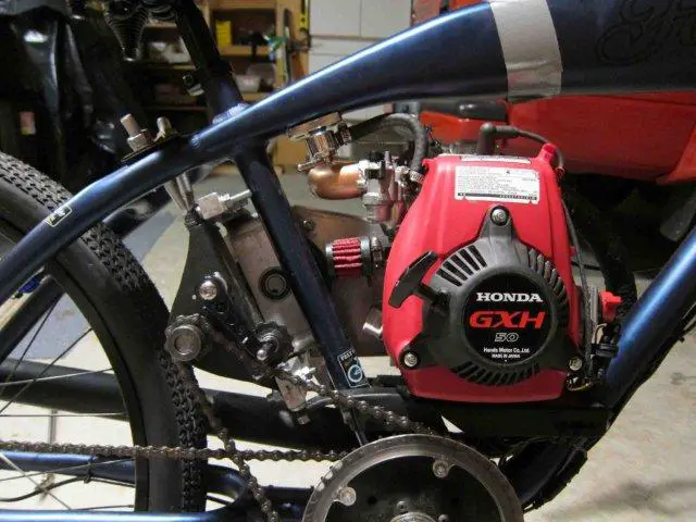

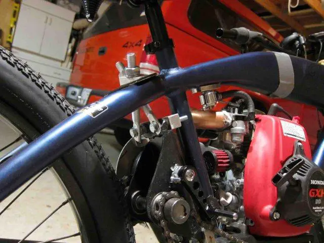

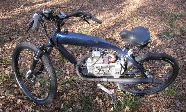

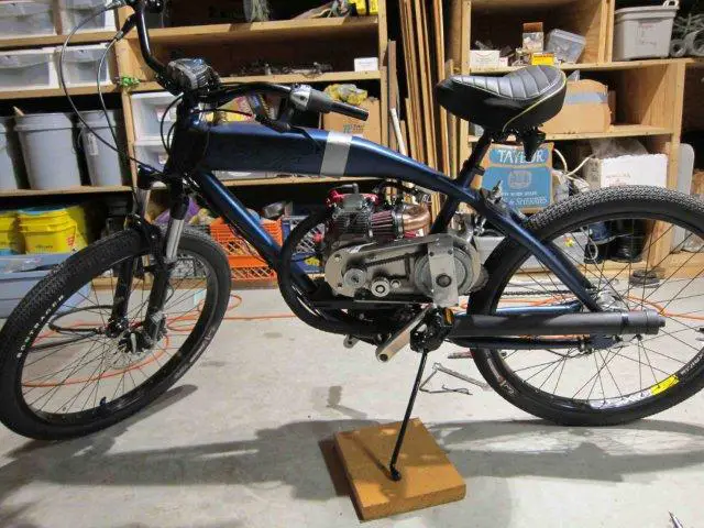

Here are some pictures of a bike I helped a customer build, but he did way more than he needed to do and included a spring loaded chain tensioner and a few other unnecessary parts.
It is a Qmatic with a shifter kit, rear wheel has a Sturmey Archer 8 speed, custom exaust I built for him and a Honda GXH with a custom cam, High performance Carb and Filters, can you say ZOOM!
Wow, now that is a sweet ride! So a Q-matic/jackshaft shifting kit it is possible, just bloody difficult laff
The top jackshaft mount fastener that holds it to the frame is very clever - having all that clearance between the seat tube and the rear wheel is essential, as I'm coming to discover. I don't think the current frame I have (older Trek 6800:confused:) has sufficient clearance - the more I research and investigate other bike frames, the more I'm thinking that no frame has the dimensions necessary to mount the engine + Q-matic in the frame and then have the jackshaft mount mated to the seat tube like normal - the QM is just to dang long, and no matter what it's going to be impossible to get the cluch and jackshaft sprockets to line up. Suspending the jackshaft out from the frame like that might just be the ticket - somehow securing it in place so it doesn't move/rattle around is another story. This frame might not be the ideal candidate after all...
If only tomorrow wasn't Monday... have to work, can't spend the day in the garage!
