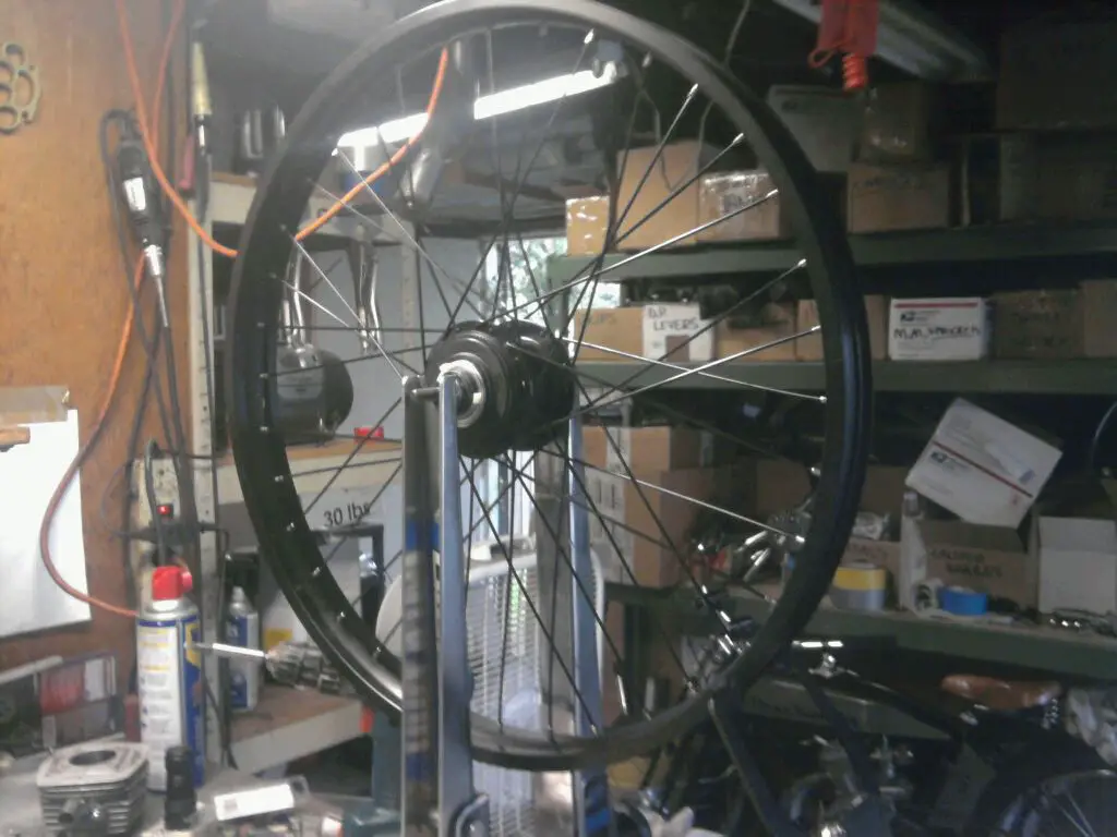

Here's a update on the Slater... The engine got a full port & polish & was pretty fast on the last LA club ride, but it really would've gone a lot faster with a smaller rear sprocket; so I decided to go 'all out' & install a SBP HD shifter kit, a Shimano Alfine 8-speed hub & front & rear Clark 185 hydraulic disc brakes.
Here's some pics of the rear hub installed & ready to go.

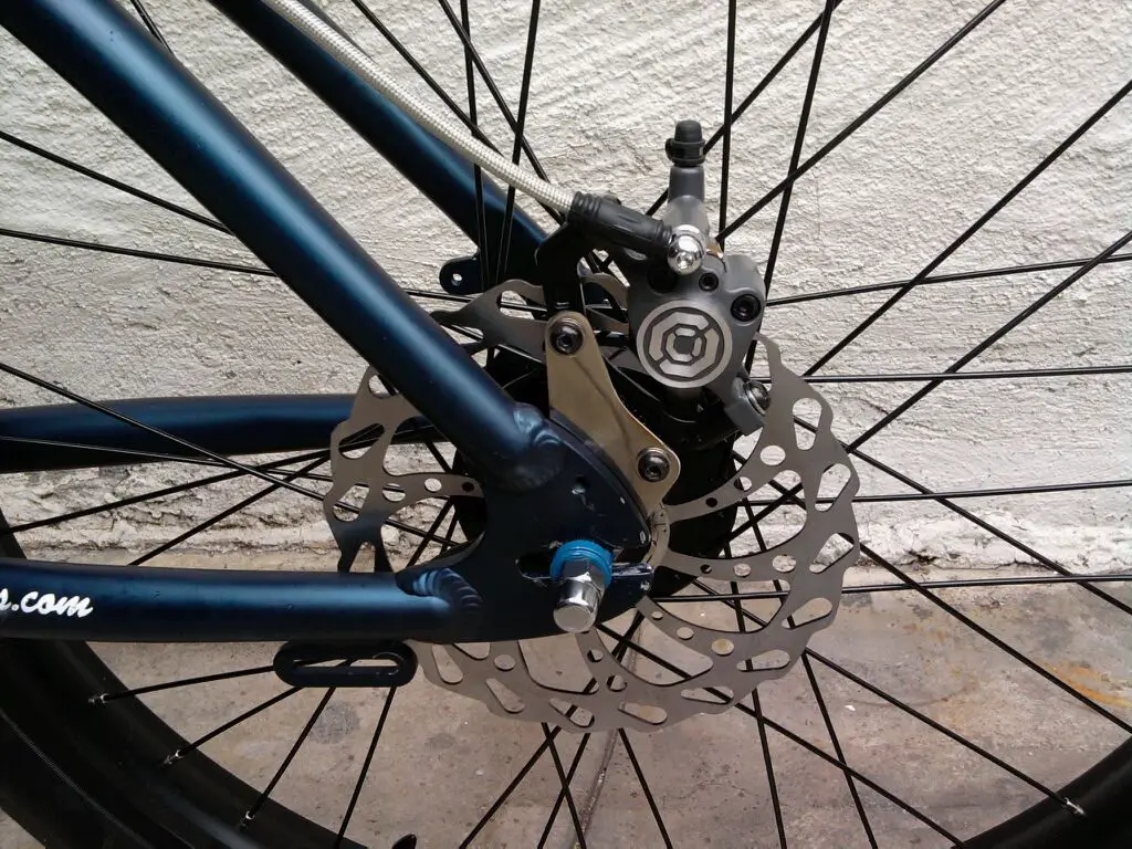

A little update... I took the rear wheel off to relace it for the front disc hub, & I put the new rear wheel on for a test fitting for the custom rear disc brake mount.
Here's a pic...

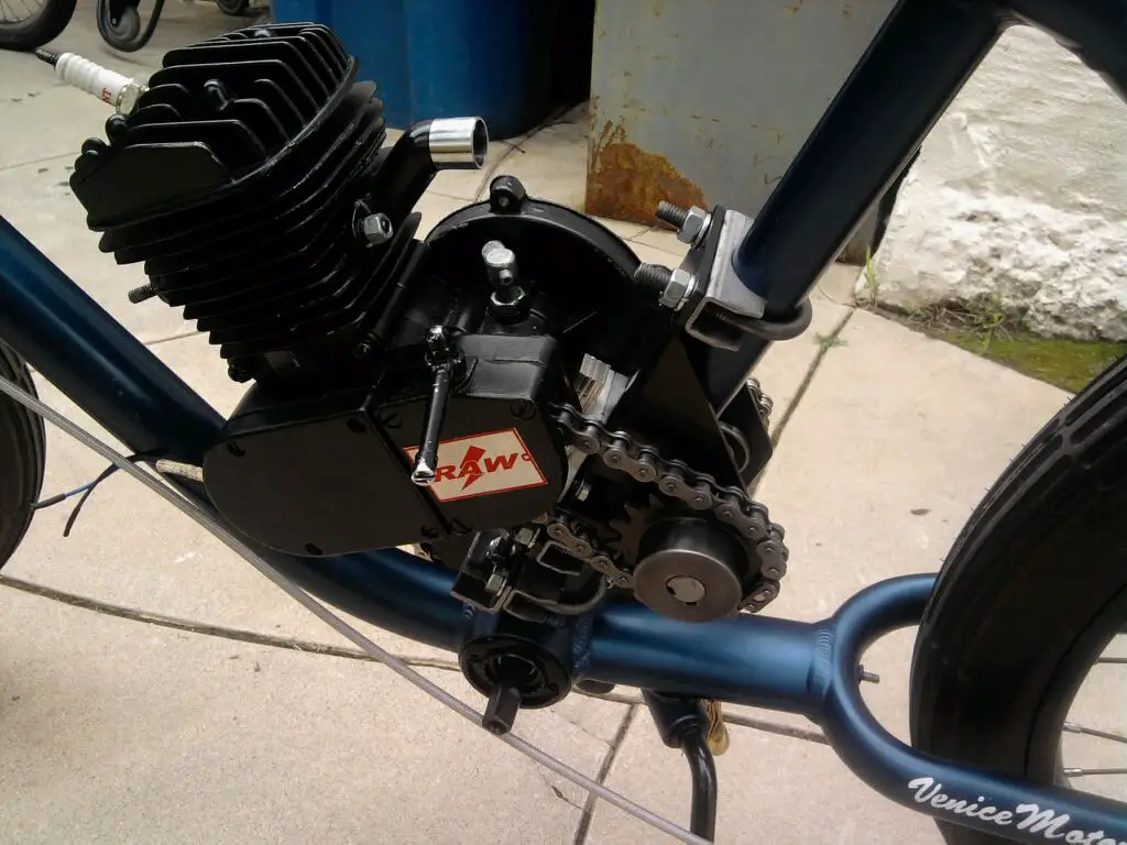

Here's some pics of the (slow) progress on the Slater.
I had the large parts powder coated black to match the bike.

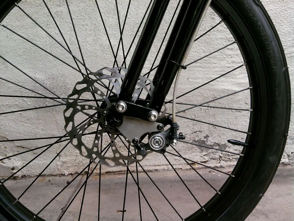

Here's a pic of the front hydraulic disc.

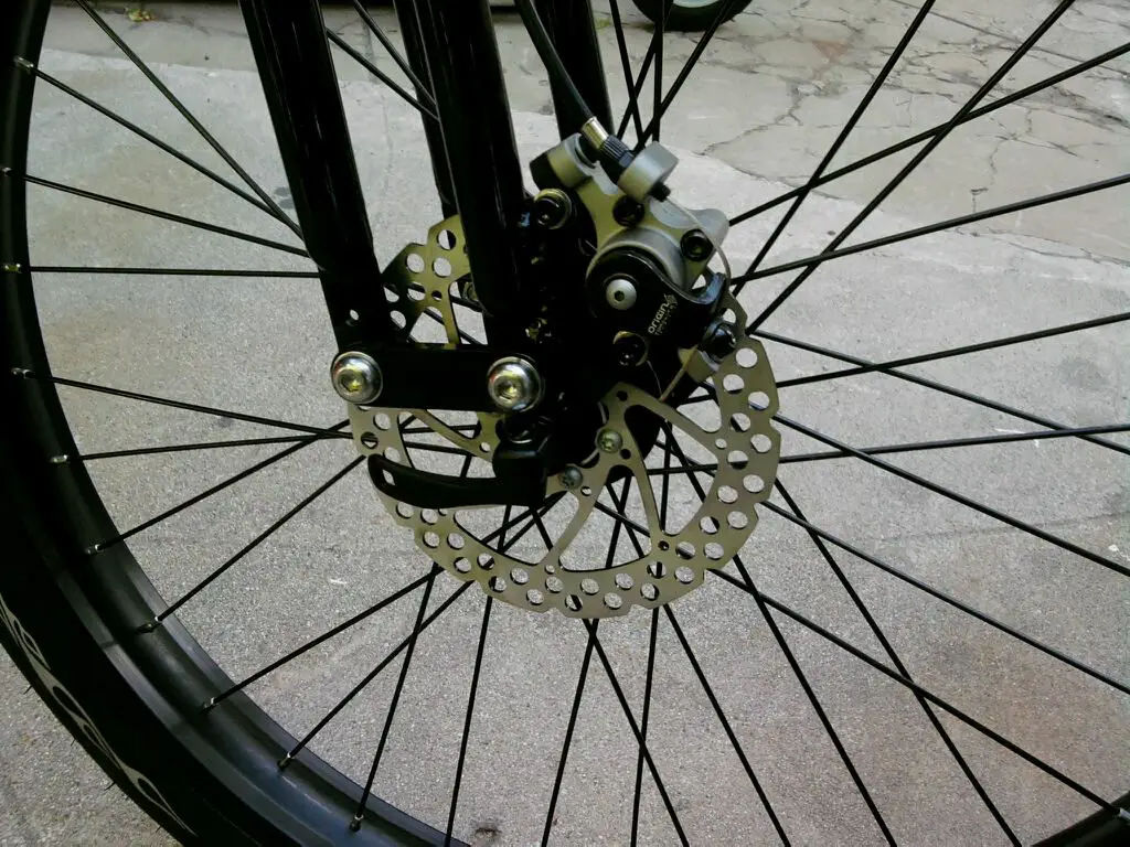

Here's todays update... I removed the large rotors & hydraulic calipers.
I installed 160mm rotors & cable calipers & a dual pull lever.
I also welded on a front caliper mount made from two of my bolt on mounts (I put two 'back to back' to make it extra rigid), & the rear is made from two also.
Here's some pics...

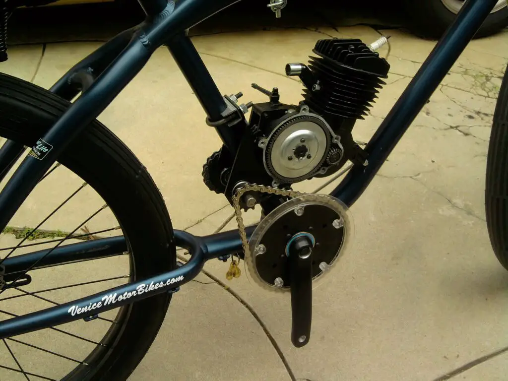

Here's a couple of pics I took today...
