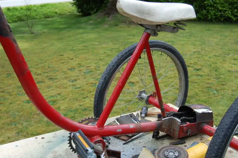

Things have been creaking along much like myself. Rain has slowed up if not completely stopped so I was able to clean out the half of the garage that I use. Had to put it outside to organize it and with a yard sale completed the crap won't filter back in. Just the fresh stuff that will take it's place.
Today I was measuring up the trike for an idea I had and then it went to get the basket holder off and then the brakes and cables. Finally i said toast it and took it out on the front lawn and cut the brackets off that the former owner had so thoughtfully welded on it when he added the motor.
The kid should have welded up the Titannic. Nothing would have come loose. He welds like I do and that is not good. I call it fear welding. I'm afraid it might come loose so I keep piling weld on to it so it looks good and safe.
Sure glad I loaded up with cutting disks when Silverbear and I went to Harbour Freight last summer. I went through 12 of them cutting the added metal off the trike. If metal met metal he welded it there.
Cut the seat posts off the bike to get at some of the brackets but it had to come off anyway so I can put it were I want it. I'll cut the tube off just in front of the trike part and add 12" to 18" to lengthen it. The trike really is a cheap piece of crap.
Wheels are not keyed to the axles. Instead they have a roll pin going through the axle and the wheel has a notch on the inside of the hub that goes up against the roll pin when you tighten the nut on the axle. Rude and crude.
I'm thinking that it will have a hub motor on the front wheel. I have one and without spending a lot of money on rebuilding the trike rear end it will never stand up to a motor. I do have a trike rear end that I bought some time ago from Chainmaker that is set up for a motor and I'll use that when the time comes.
If the weather holds up I'll get at it tomorrow. I'm waiting for information on parts for the tricar so I'll fill time in with the trike.

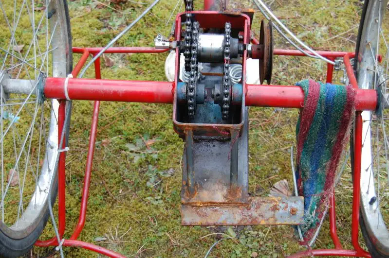

Hi Motortriker,
Both the wheels are driven by the pedal chain. This acts as a differential since they both free wheel. It has a 3 speed hub and I'm going back and forth between using a hub motor front wheel which I have or a Cyclone set up so I can use the 3 speed which isn't legal here in Canada but of course they have to catch you doing it first.

I am looking at the Cyclone motor kit rather hard. Motortriker has a Schwinn trike set up with an Currie/IZIP trike rearend that has a place for the Currie motor prebuilt into it.
The Cyclone will make this more than fast enough to get me from home to the store which is about as far as I would want to go around here. They are putting bike lanes in on the major streets here but as yet it's almost a case of certain death riding the main roads in our immediate area. The drivers seem to feel that bike riders are a minor inconvenience that should be taught a lesson for being on the road.

That rear end is right ! :)
Last weekend I was riding the trike hard offroad .
Only the left tire is powered.
My wife Nancy is about 100 lbs. I am about 170.
She could go right through the sugar sand but the torque of the motor tends to make the trike want to go right because only the left tire is turning.
With me on it I was getting spinnage and tended to lean left to get more traction.
On pavement I have to lean forward to keep the front tire on the ground when giving full throttle at start off.
Powering both wheels is the way to go with an electric motor I would think.
I have a couple of Trailmate trikes. They have two axles like yours but only the right side is powered.

Looking at it today as I was working on it they have mounts threaded on the 5/8 axle and free wheels hubs welded on them.
Just went out and looked.
The dual drive hub says,
