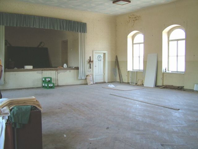

Talking of house restoration - NEVER spend a day drinking in a German Beer Kellar then wander into a State Property Auction ................... you might end up with something like this !
Bought for the price of a modest secondhand car. Built in 1880 9 bedrooms, dance hall and stage, beer gardens [ was a Guest House / Bar at one time ]. 20 minutes North of Dresden - what a wonderful City - no thanx to the RAF and USAF.
BTW - Axel - I think our paths may have crossed in a previous life ..........Porsche Spyder 550 ring any bells ???
Sadly this will NEVER be restored [ light refurb modification more the case ] in my lifetime / funding - but we do enjoy several vacations a year out there
hmmm.....wondering?
Dance hall and stage? What's the German voltage? Do you play bass or drums?
Voltage same as the UK [ give or take ! ] We have single and 3 phase [ for cold rooms, beer pumps etc. ]
Played lead guitar in a group ..mannnny years ago. I leave that to the local villagers now who come and play every year at our Pig Roast and odd occasions for the villagers.
