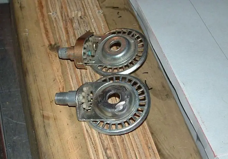

The speedo sounds like a chore. What kind of hub is that? Did stuff also get chewed inside the speedo hub/gear? Or do you only need to buy a new cable.

Actually I’m looking for the driver, or even just the little nylon gear with a “D” hole as seen in this older pic...
It's made in Japan, but it gets a little confusing because of a similar looking brand that has a slightly larger gear...

Thanks for the tip about msrfan, I'm using a 1960’s Japanese made driver that has a highly modified and reenforced housing.

The chewed speedo driver gear turned out to be a non-issue and actually seems smoother than before, who’da thunked?

Gilbert, I see I missed answering your hub question...
It's a old Yamaha flea market find, but I don't know what model it came from?
Must of been fairly large, like in the 250-500cc range though.

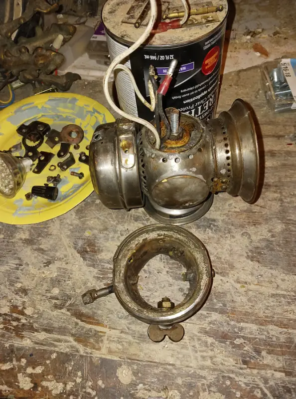

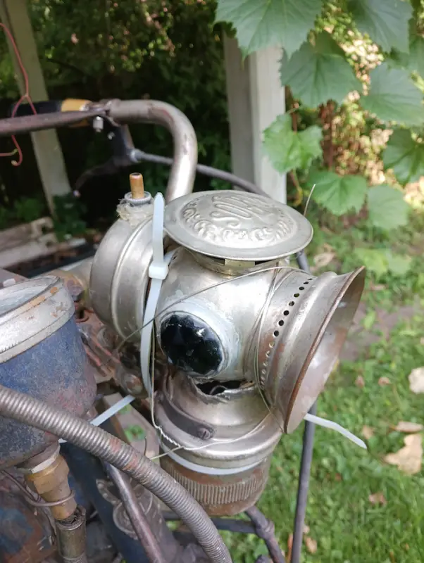

Here's an update of the some of the "routine" maintenance required if using antique parts...
On a recent 60 some mile ride with a couple of Eastern Iowa buddies my old Solar brand headlight broke in two! Cheap Arse Made in America junk, it only lasted 125 years!
Some field repairs where made to get home~

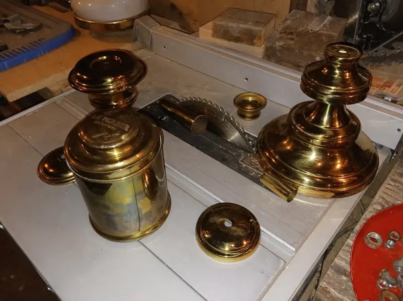

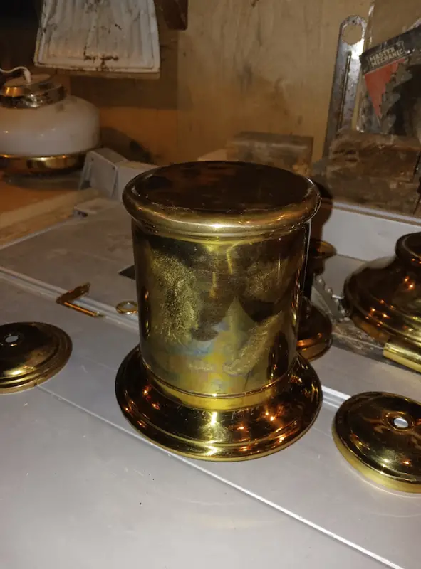

At first i considered making an all new "Retro Antique" replacement with brass parts from an old table lamb and cigar can that i've collected. But because of the amount of work in that i decided to just repair the Solar. And I was also anxious to just get back to riding! But i will probably still use those parts for some future build...
