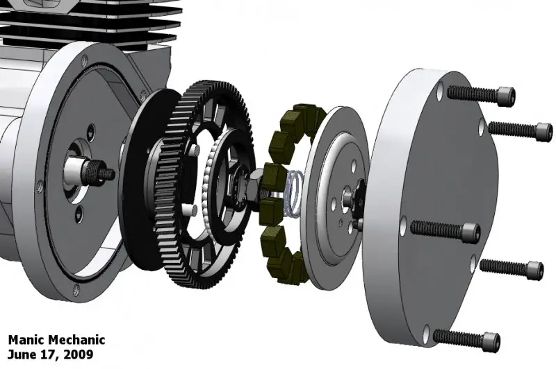

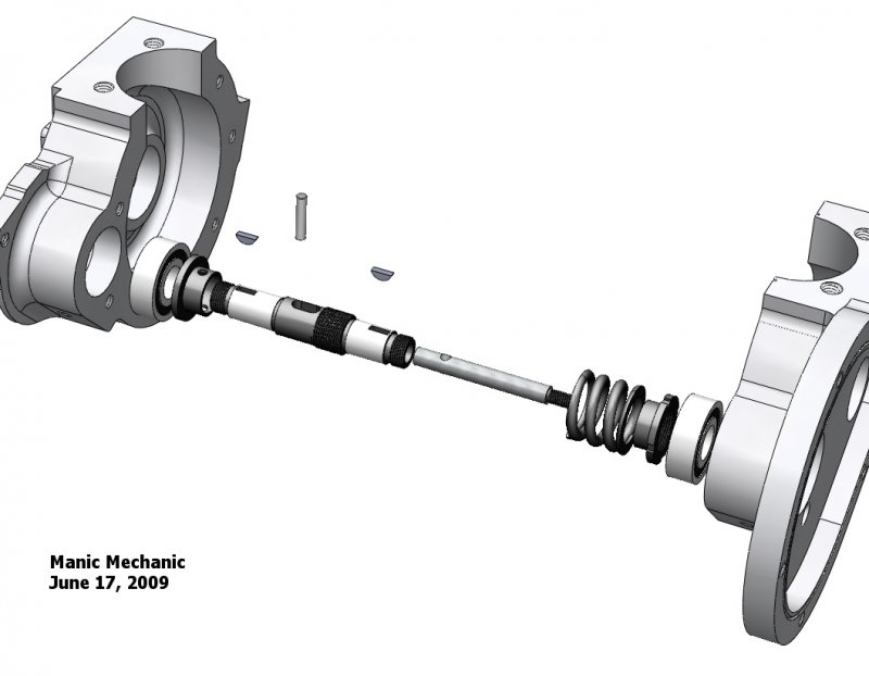

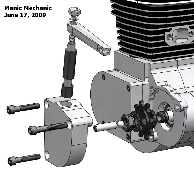

You have 3 key ways in the drive line, one under the chain sprocket and under both gears on the right side. See if you can determine if either has broke.
Look at the small gear first, it’s the easiest to check. All three keys should be the same.
Each gear or sprocket has a woodruff key under it in a groove cut in the shaft and gear or sprocket.
Here are pictures.
