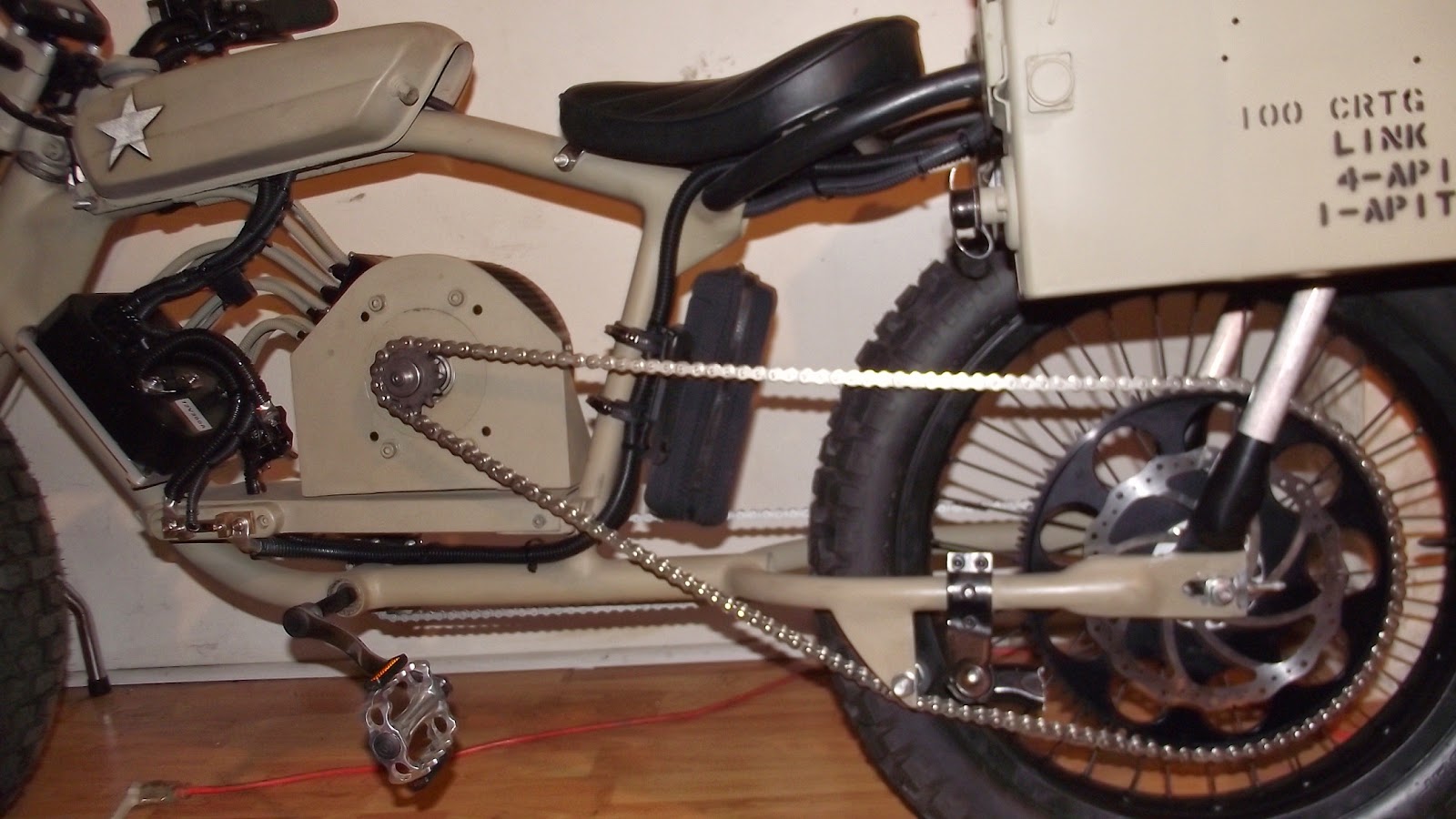

It's complete electrically and drive-train wise but it has no batteries yet. I'm still waiting for them from China.
The one 1/2" cable running up the seat tube is the negative electrode. The positive electrode runs on the other side of it.
There is tremendous rachety type drag from the motor when it's off. It really only needs 1 mechanical brake as it stops all by itself when the motor is not getting any amps. You can pedal it but not for any length of time. It pedals like the bike weighs 500 lbs. LMAO

Obviously this motor was made to power something much much heavier than my bike, where the magnetic drag of the motor would not even be noticed over the weight of that vehicle.
On a bicycle, even one as heavy as mine, you can't help but notice it. It sends a shockwave right through your thighs with every crank. LMAO
miked826
Aug 6, 2011
1,748
7
Los Angeles
I still in awe of the size of that sprocket
I'm not a big fan of anything that visually stands out like that sprocket but that large azz sprocket allows me to simply change out the motors tiny and cheap sprockets until I get the gear ratio correct for maximum battery efficiency. I have no idea what size motor sprocket that will be yet.

If you removed the spark plug on a 2 stroke bike, popped the clutch and started pedaling, the drag from that motor would not equal the drag felt on this motor. Running out of electricity just isn't an option on this bike. laff
I'm waiting on a sprocket roller to replace the rubber wheel roller. I hate those rubber wheel rollers but that's all I had.

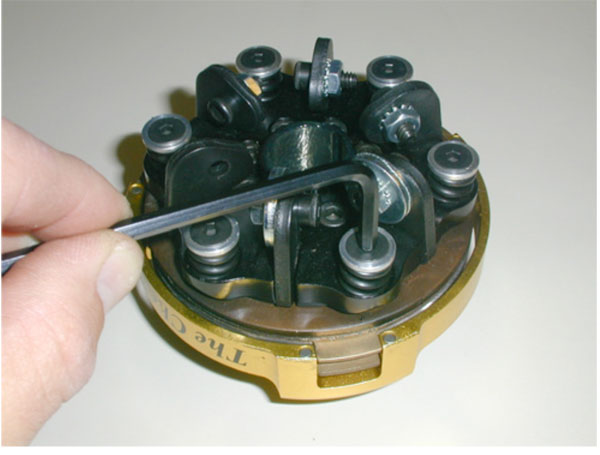

If I keep cranking on those allen head bolts and adding washer weight, I wonder if I could drop the Cheetahs bite down to 100 RPM? It makes me wonder. laff
You could just use a freewheel motor output sprocket if you can find one strong enough, that's what I use on my 50V 1860W shifting e-bikes, or in this case an e-Beast.
Nowhere near the power you are talking but it has gears so it might run with you.
I was thinking an easy mechanical disengage of the motor from the drive train.
That would be pretty easy to do with a belt but a chain presents a different problem and a cent clutch seems like a poor solution.
