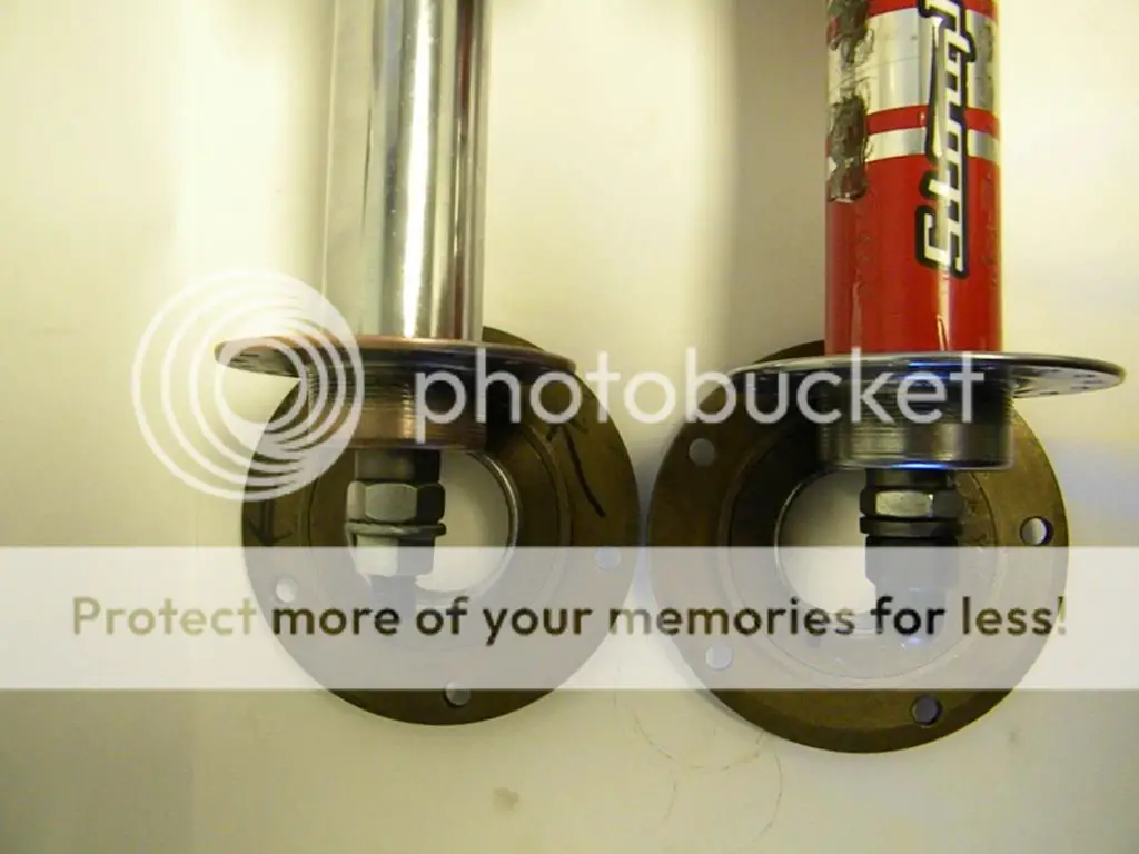

I Just Posted In Your Other Build Thread. We Have A Problem. I Received 2 Hd Axle Kits Today.
The Left Hand Thread`s On The Hubs And The Freewheel Adapters Are A Larger Thread And Will Not Work For You.
Your Chopper Hub`s Are Already .008" Under Size Already. (this May Be Good = Threads Not Cutting Into Hub As Far = Stronger Hub??)
You Are Still Ok, Just Buy 16 Tooth Left Hand (south Paw) Freewheel Sprocket.
More Inventory On The Shelf!! Lol.
Let Us Know What The Machinist Says! Good Luck, Ron
The hubs are finished, although I was not expecting the machinist to hurt me as bad as he did!!!
Ouch ouch ouch... $292.56 at 3-hours labor to machine left hand threads on 2 hubs, oh well a lesson well learned.
Yes 2 hubs one is for my XL Chopper and the other is for my OCC Schwinn Stingray Chopper!
Anyway I'm just glad it was a success, he was able to thread 3/8" worth of threads on each hub.
Now I just have to Lace the spokes to the wheel, and then I will add a few tack welds to make sure they don't slip. That is the Left Hand freewheel adapter which is what I'll be mounting my sprocket to.
Note, I could have just welded the left hand freewheel onto the hub and saved my money, but it's ok it's a very clean job.
Word to the wise if you want to use this type of 5-hole freewheel adapter from Bicycle-Engines.com you can just grind down the left side of the hub a lil over an 1/8" and the freewheel adapter will slide on hub and then all you have to do is weld it in place.

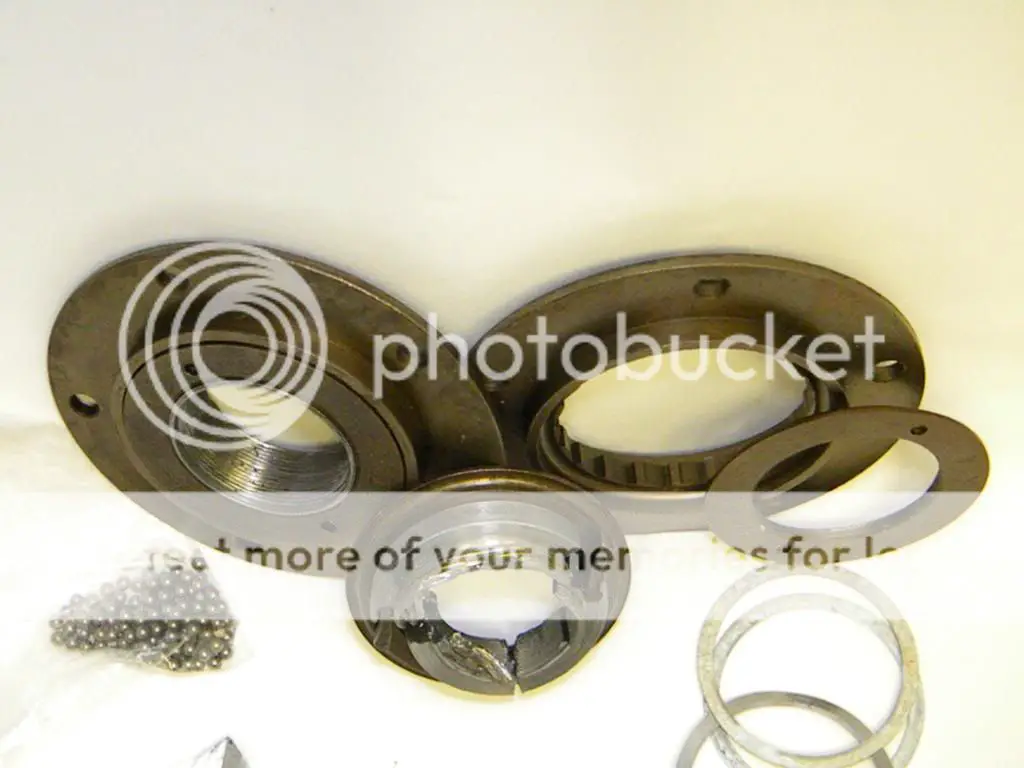

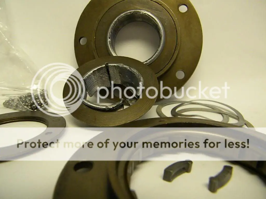

By the way when I ordered my freewheel adapters I ordered 3 of them and one of them I destroyed taking it apart to see what its internal parts were, I don't recommend wasting $20.00 dollars to see the inner workings of the 5-hole freewheel adapter.

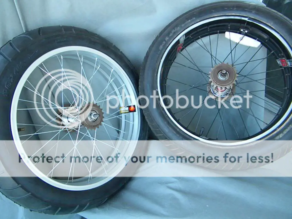

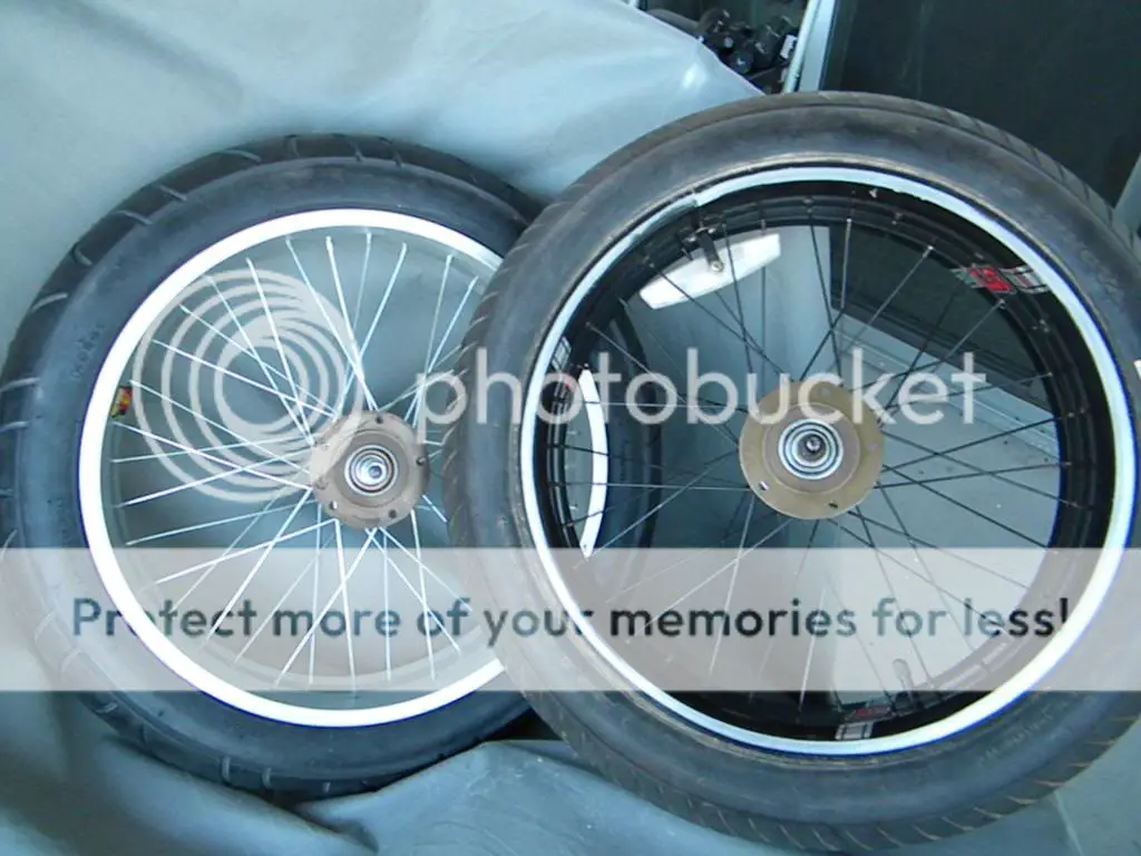

Here's both wheels laced and ready to go:

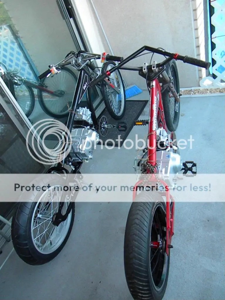

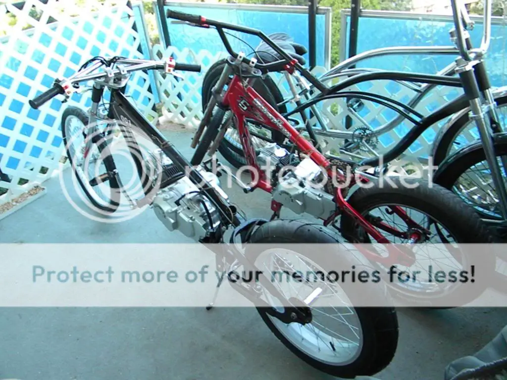

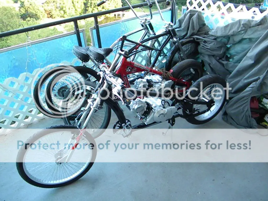

Here's a few pic's with wheels mounted, the motors still need the skid plate welded on to the bottom tube that'll be done this week:

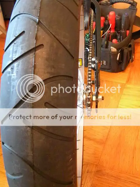

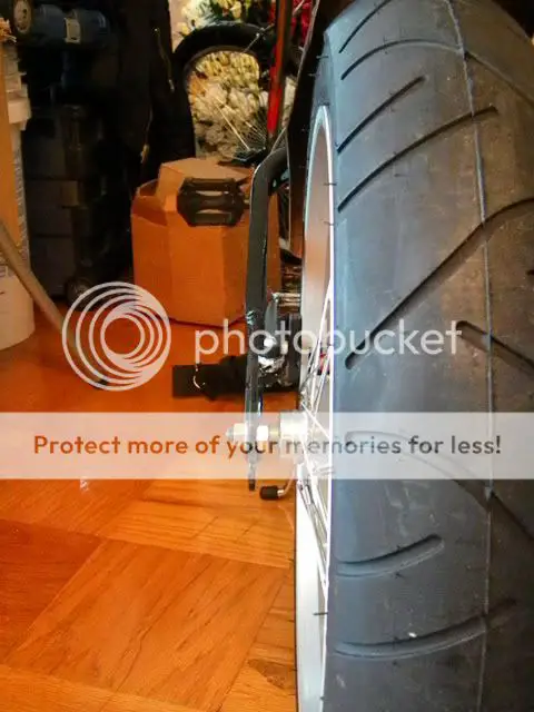

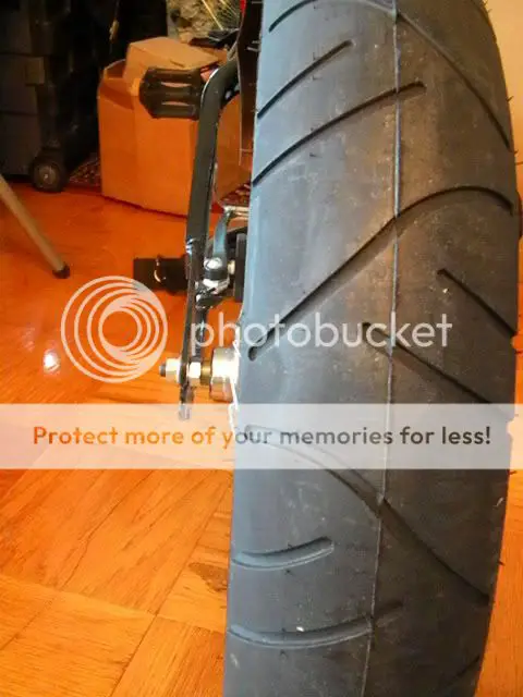

Ok now I have a challenge I'm thinking about running a Left Hand / Right Hand Dual Drive Freewheel on my OCC Chopper & XL Chopper Builds.
Here's a few pic's or rear wheel left side & right side. The right side has a freewheel sprocket and I'd like to add a freewheel sprocket to left side.
Why?
Answer: If this is possible I won't have to use a jackshaft to switch honda 4-stroke 50cc pit / dirt bike drive train to right side rear freewheel sprocket.
I would in then have two or a Dual Drive rear freewheeling HUB / Wheel.
I would still have my pedal power driven right side rear freewheeling sprocket, and on the left side I'd have a motor driven rear freewheeling sprocket at the rear wheel !!! YEAH !
The reason I'm trying to do this is that with the chinese cloned honda pit / dirtbike engine, when you place it into the frame the engine drive sprocket lines up almost perfectly with rear wheel axle.
On the OCC Choppers & XL Choppers you have almost 1-1/4" thats one & one quarter inches of free space on left side of rear wheel and the Hub appears to have flange diameter of 1-1/4"s also.
If anyone has suggestions or know where to purchase these please share this info.
Here's the pic's of XL Chopper rear hub & wheel:
Notice all this space / room for a possible left side drive freewheel sprocket.
