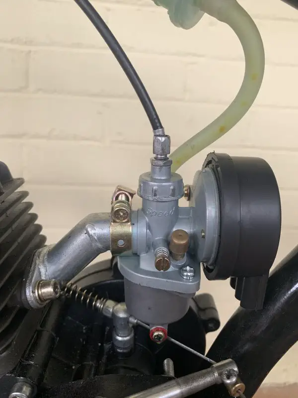

Im not sure where this ramp that needs to be to the idle screw is. :(
Unscrew carb top pull barrel out with cable. then you will see exactly what I mean.
