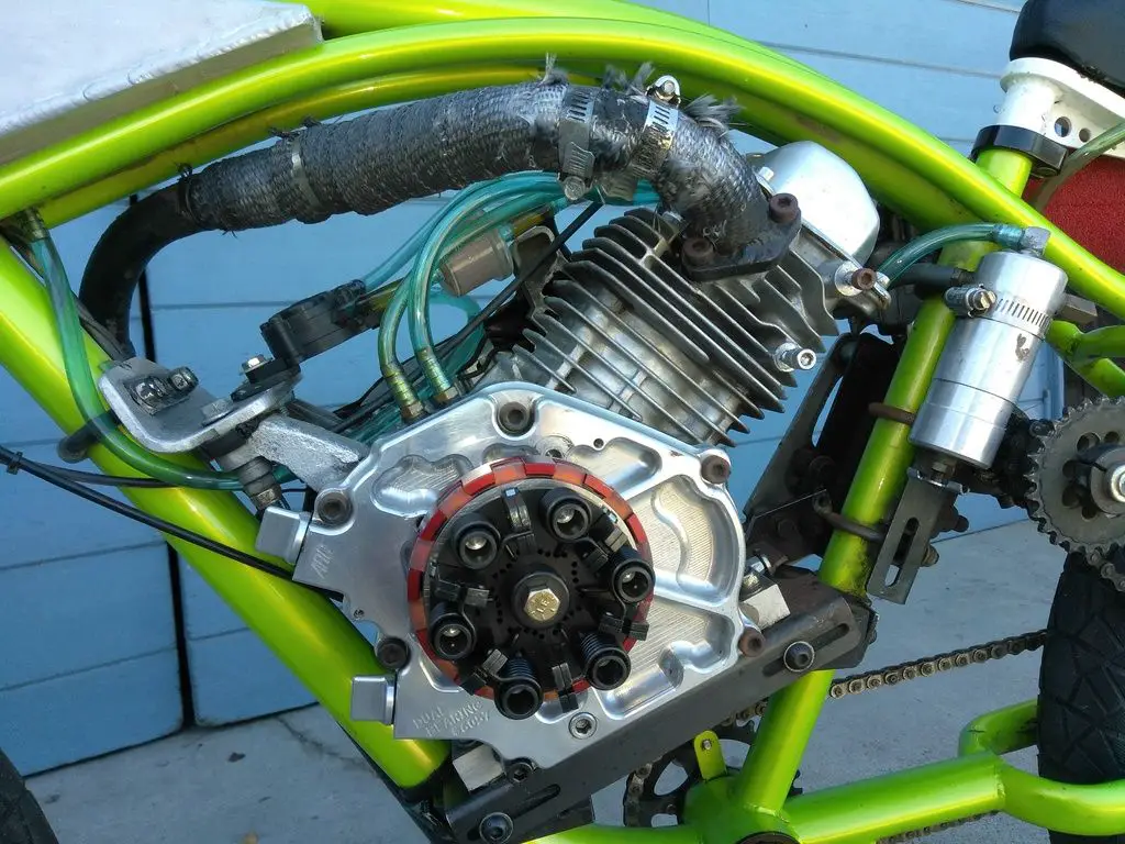

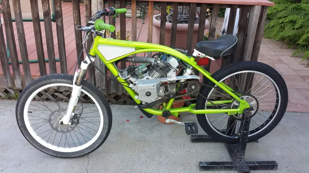

I have a 212+cc Predator (first generation) that I have been racing for over 5yrs. now and it's gone from single speed TC at 10hp to 2 disc cent. clutch at 26hp.
Either way gears have not been needed for this application but a jack shaft is required of course. Currently running a gear ratio of 11.11:1
The primary gearing is 12t on the Vortex clutch to a 25t sprocket using #35 chain and the secondary is 9t sprocket to a 48t sprocket on the hub with a #41 chain.
Tried and true... I've won many races using this setup.
