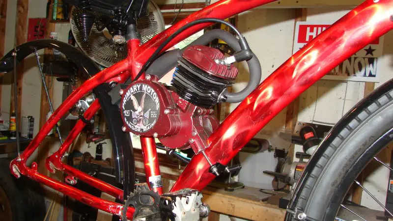

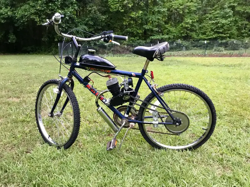

As Allen said we need to see pictures, you hv to have the engine mounted solid, no gaps at either mounting point. The picture is my 24 “ with the engine mounted correctly, I took the picture with my iPhone.
very nice Greg! Picture this. I'm waiting for a long Z intake. This is an older engine GT5 rebuilt a couple years back. I in fact shortened the rear mount about an inch and then put a drum sander in my drill press to re shape/angle the front mount by hand so the engine would fit low and tight. That alum is very soft. Softer than hard wood and easier to work. This is a 26" NEXT Laholia spelling could be wrong I took all the stickers off.

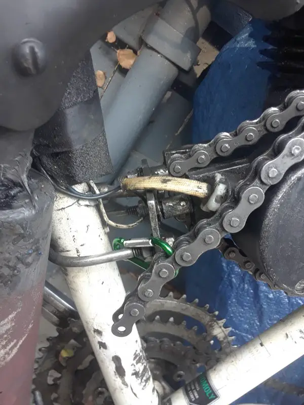

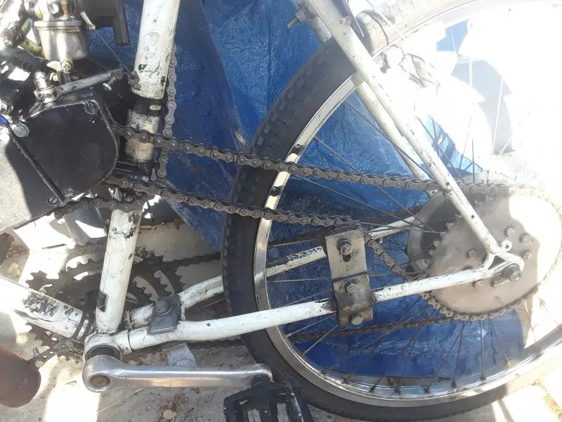

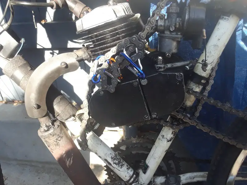

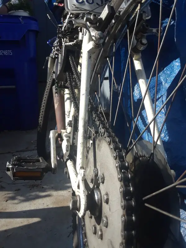

thanks for the reply guys! here is what i'm working with. dont mind the extra chain with the clips that are blocking the head from view. that was my sad attempt to lock the motor in place. i think i know what the problem is from seeing your pics. it looks like the end towards the front wheel is poorly mounted(the picture with the green clip). it has a D ring that pivots pretty easily. let me know if you need more pics
