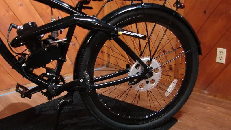

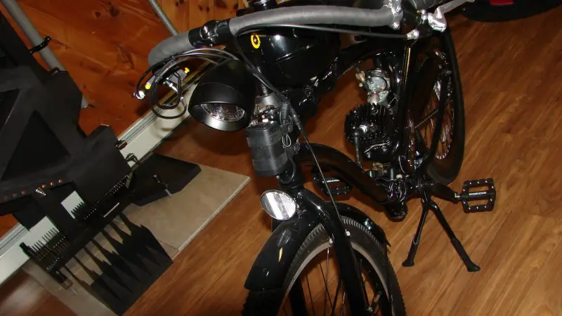

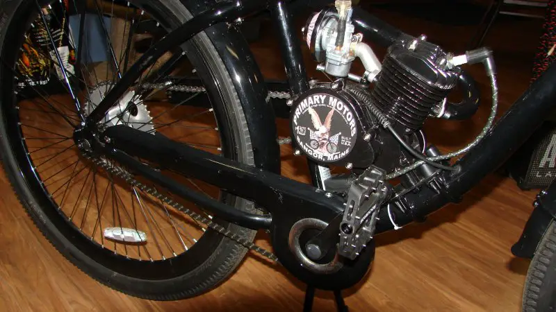

here's a pic. I know hard to see, I got table leg ends on the end of the u-bolts for cosmetic purpose so tis hard to see, but you get the idea. Also a pic and link to the exact mount I used.
