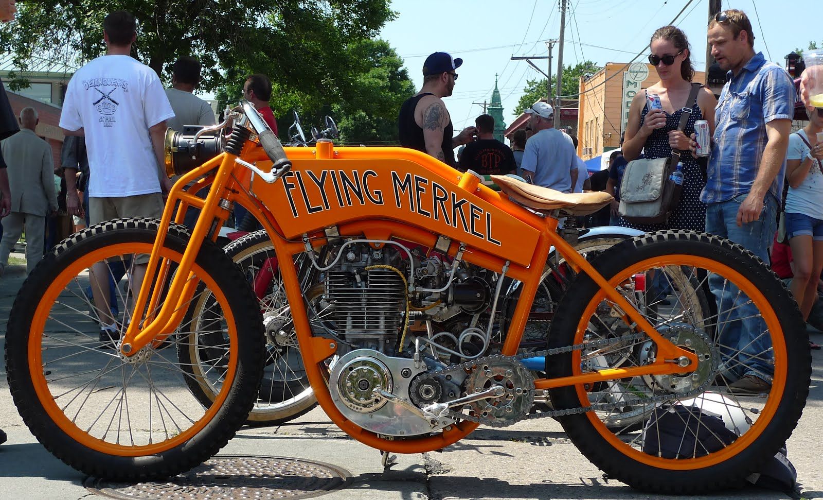

I saw what I believe was member Rebuilder’s Yamaha powered Flying Merkel drive by a couple of times, but it was to quick to have a chance to introduce myself or even get photo’s.
