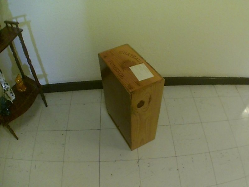

I found a free piece of varnished ply, part of the sad remains of an ex wardrobe. I had an already found wine box. Somebody's lost the plot, and it ain't me.
I tried it tonight at an open mic. Not enough volume, the ply was too thick. Never mind, this time next week it might be a speaker cabinet, I have a 12" to go in it.
I took 9 screws out of the sound board, leaving just 3 to locate it. It's louder, how much more, I find out tonight.
Yes, letting the wood move around has let it sound out a bit more. Now I need to find something to use as a snare at the back of the board.
The final incarnation has the two screws at the side each going through the board into what is now a short piece of wood to connect it to the crate. Loud, a bit rattly, and still iconoclastically CHEAP. Lordy, ah feels gooood!

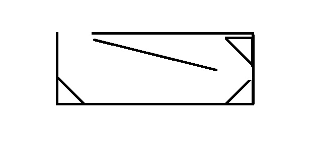

So much for final incarnation. I'm going to put an idea I had ages ago into practice. Making the noise take the long way round to escape, hopefully enriching it in the process.
I did the simple internal panel tonight, initial quiet sounding indicates more sound leaving by the front slot, and it is deeper in tone. Interesting.
The final "finally". Two wooden bars screwed and glued to the plain end as feet. The other, printed top end, the back, the sides are coated with PVA. The volume and range of sounds it gives is much increased over the simple box without the internal baffle.
