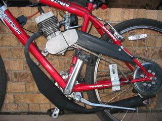

Now that I've teased you for breaking your carb if you can send me a drawing of what you need and make a intake make exactly of what you want out of pvc or some parts cut and glued together I could make you a nice one out of steel. looks like it needs to be a short run on the intake and a little offset to the left if your setting on the bike. let me know
not a good picture of my offset intake manifole but i think you will get the idea
