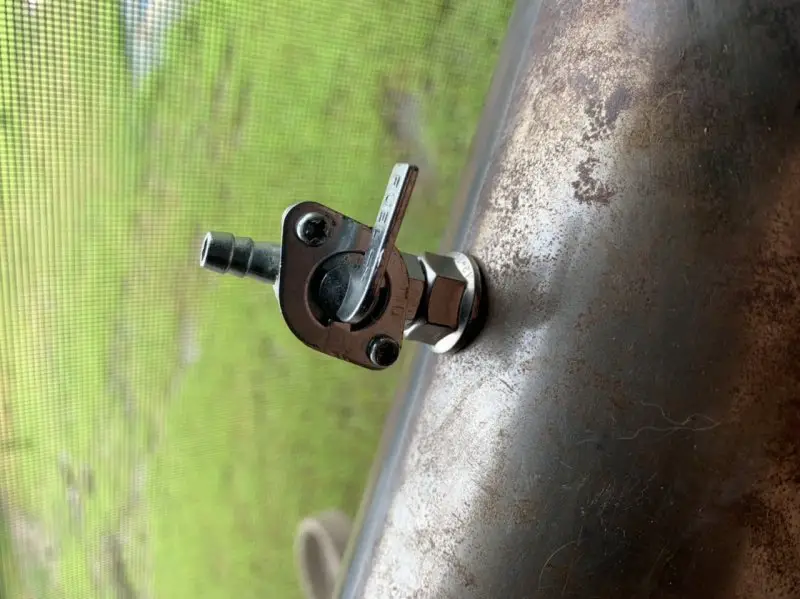

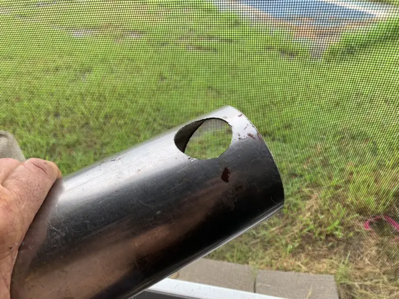

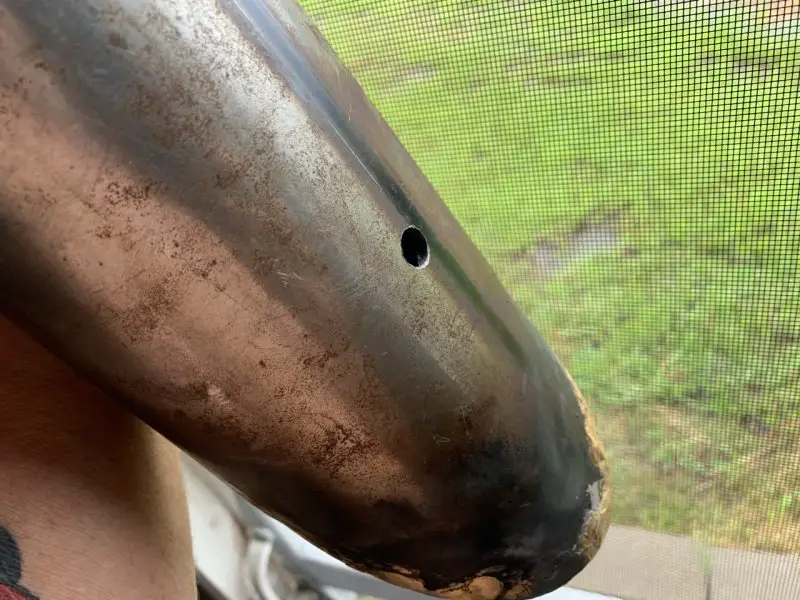

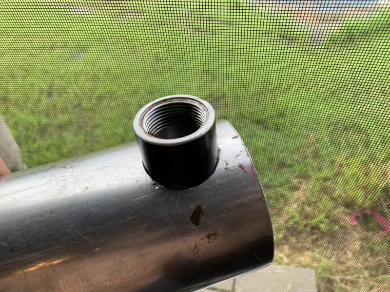

I should be working this morning, but it’s raining again :rolleyes:
well, I am at least feeling well enough to work on the bikes again. Me and the drill press got reacquainted this morning and I put two holes in the gas tank.
for the first time, I believe I might be able to pull this gas tank off in one attempt. We’re not there yet though.
Have to try get to the welding shop before noon to pick up some silver soldering rods.
Well I was practicing my silver soldering and it was going very well when my acetylene quit flowing.
It did this once before and I took it to the welding shop. It was something in the regulator system. He showed me but I didn’t completely understand. I’ve been in there enough times he didn’t even charge me for it. Well now I believe it’s happened again.
the welding shop is closed until Monday, so I believe I’ll start taking things apart and see if I can fix it.
it actually did this about a week ago and today when I fired it up it was working fine. So I didn’t take it with me to the welding shop when I went. It only worked for about 10 minutes and it went down again.
anyway, if I can get this thing fixed I believe I’ll get my nut and filler bung soldered on today.
it was a little red piece down in there, does anyone know what I’m talking about, LOL
OK I dug into the regulator but couldn’t find anything obviously wrong. Could not find a rebuild kit either. probably just gonna order another regulator. Mine is very old.
I also got the gas tank welded up today. Once the acetylene torch is up and running again I’ll do a little silver soldering or brazing to fix my leaks.
