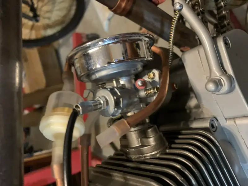

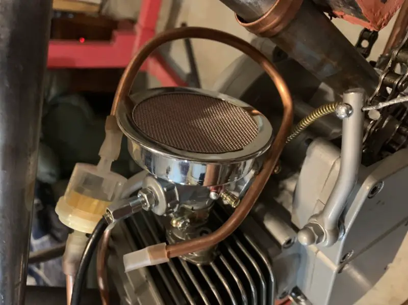

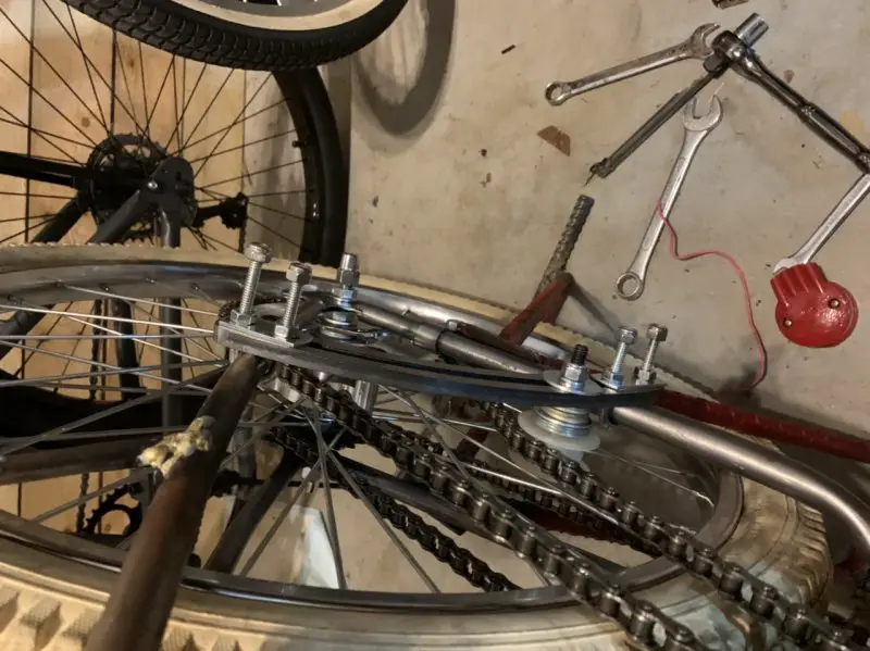

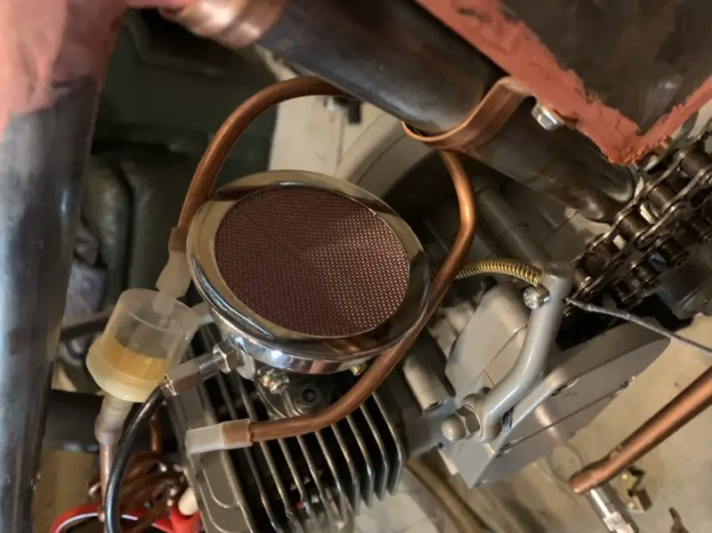

Ok ok ok, thanks to Lynn @ MBRebel for the arch tensioner and chrome air filter/faux velocity stack.

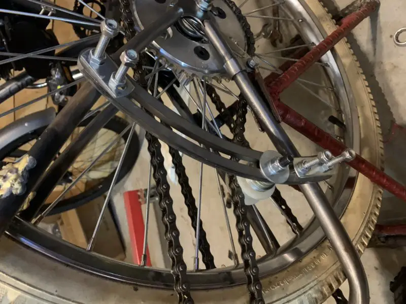

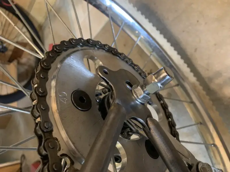

Had to use quite a few washers to get my nylon wheel to line up with the chain.

"chrome air filter/faux velocity stack"
Nice detail!
Yea when I saw it I thought it would fit the bike nicely. Been looking for one for a while. And even though the rubber hose (connects filter to carb) diameter is too small to fit around the carb, the air filter itself has an indentation that will easily silicone to the carb. It it needs removing it should come
off easily.

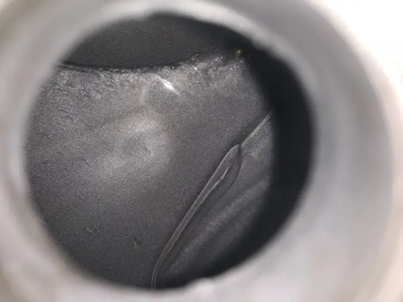

Trying to start her for the first time today.
believe I have a fuel problem. I just read 330ohms off the Magneto and 6.6k ohms out of the CDI. Apparently those figures are in the correct range from what I’ve read.
I’ve got gas right up to the carb, so I guess I’ll remove it and check the float/bowl and jet needle valve.
Any other ideas on what I should check? I do have a spare carb and spark plug sitting here, guess I could also try those

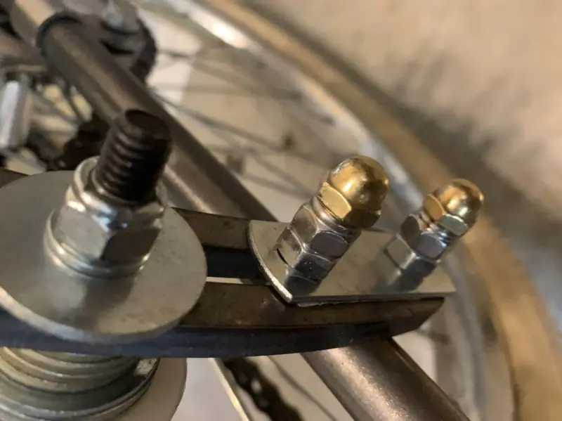

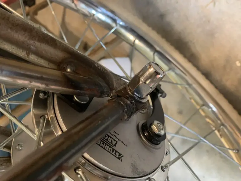

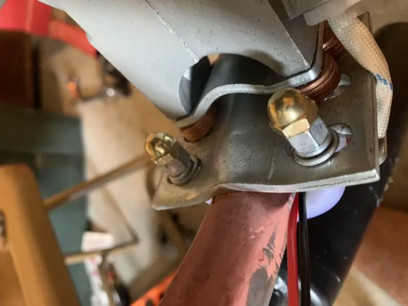

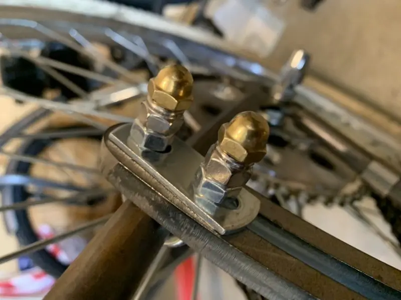

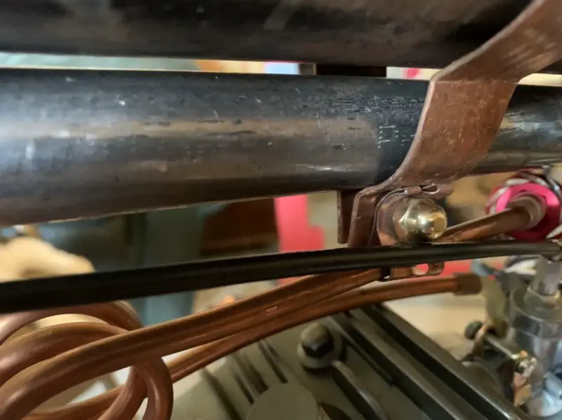

have more brass acorn nuts coming. For the motor mount bolts, the exhaust bolts and the screws holding the leaf spring together/on.

Matching front and rear axel nuts. Fancy! When you get done pimping your ride, some full build photos are needed.
