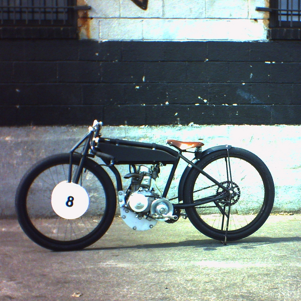

Thanks glad you liked the video. I will be posting more as soon as I get the new bike done. The engine is totally stock aside from the 22mm carb and custom exhaust. The exhaust in the video was only temporary, eventually changed it to a very short stubby pipe like some of the old harleys had. The shorter pipe had a much meaner raw sound to it. You can see it better in this photo.
