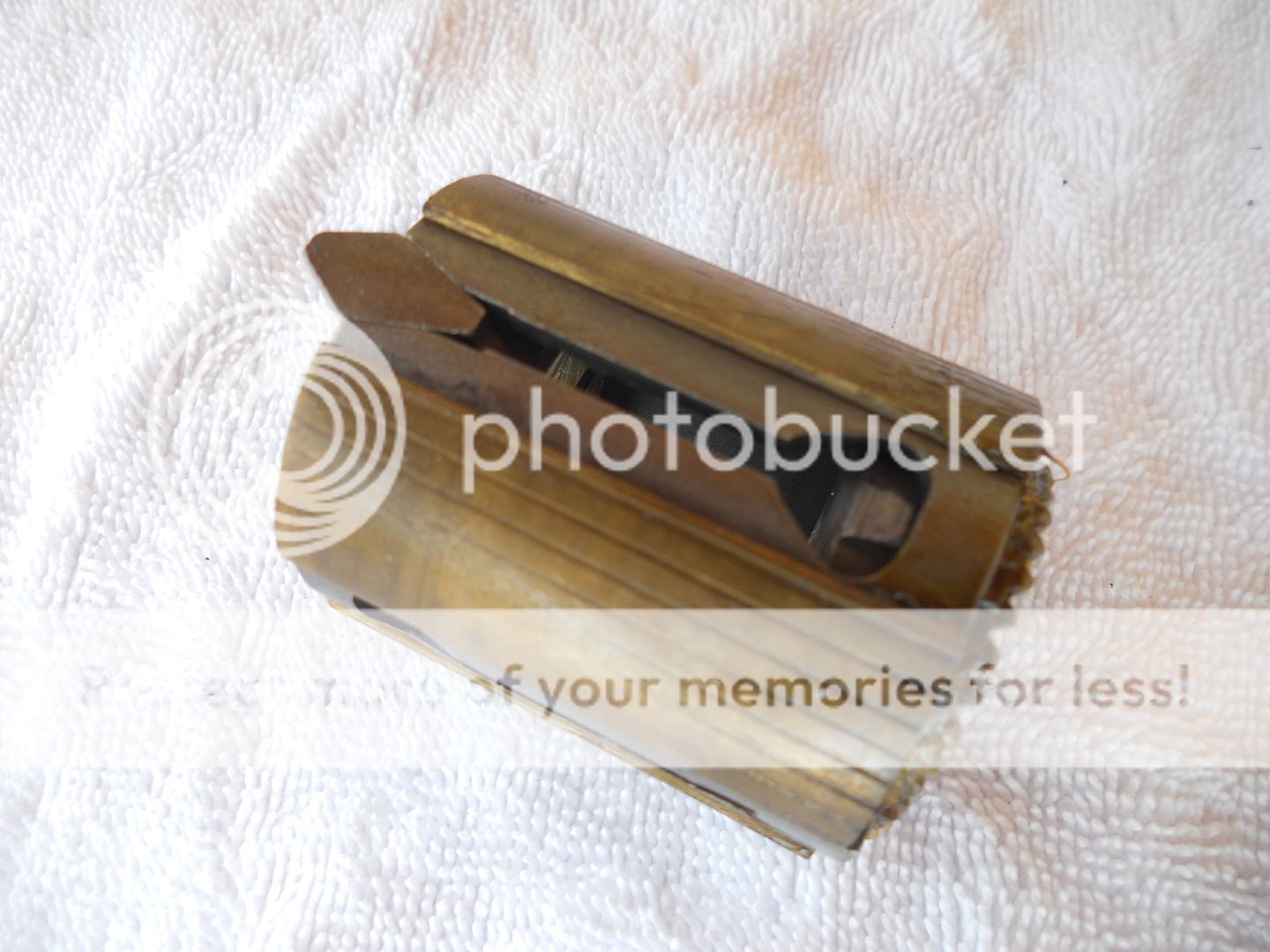

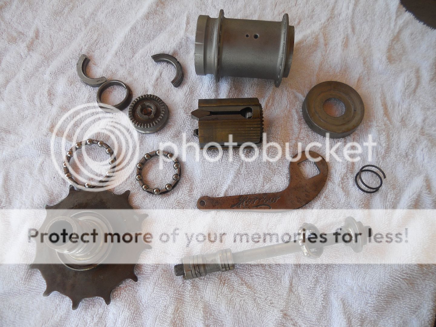

i tend to stay away from coaster breaks now unless i know its a well made heavy dutie one ! i have had a coaster break explode on me and lock up the rear wheel going 30mph !!!
the break shoe inside the hub cracked n half cause it was made from cheaply casted steel and crunched up sidways in the hub digging into the hubs outer wall and locking it up solid !
i posted a whole thread about it on here about 3 months ago, and believe me it was not due to neglect or improper lubrication ! i kept good care of it and had fresh grease in it ! the hubs casted break shoes were just cheap and not designed to break the hub at 35mph and could not with stand the repeaated stress of racing and street riding and it clean snapped in half flipped up and destroyed my hub and almost me !!!!!!!!
here are the pics if you want to see what can happen to a coaster hub under motorized abuse its clearly not meant for ... i just dont believe that any coaster hub is meant for hard breaking at 30-35 mph repeatedly ! they are built to stop slow moving cruser bikes and dont hold up well to stress from my experiance
this was the second hub i destroyed ! the first got loose and wobbly no matter how i tried to adjust it so i swapped out to a brand new hub with new grease and in less than 200 miles the break pad snapped flipped up and locked up and destroyed my hub
since i have swapped to a 7 speed shimano hub and derailer i have not had a single problem and i have had the smothest ride yet ! not to mention how nice it is to be able to shift when i want to pedal !
if your raceing or riding fast down the road and go to break and one of your 2 or 3 pads snaps like the one i posted .... you best have on a helmat and all you knee pads and elbow pads cause your going down !!!!
