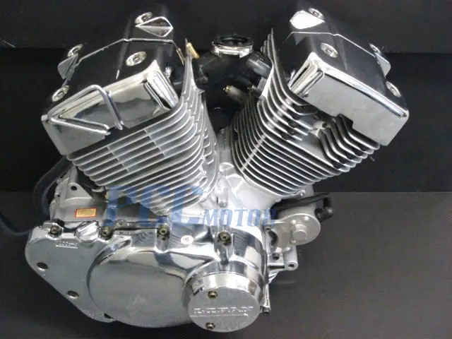

That engine is sold on new road motorcycles that are advertised as having a "cruise speed of 80mph". xct2
I think I will just save my pennies for this instead of having any more wet dreams of china girl v twins that seem to never make it to life... Wonder if I can find a big nuff shoe horn to cram it into a stretch??? There used to be a 125 cc V on ebay but I cant find it any more...
LIFAN 250CC V-TWIN HONDA ENGINE MOTOR MINI CHOPPER BIKE
