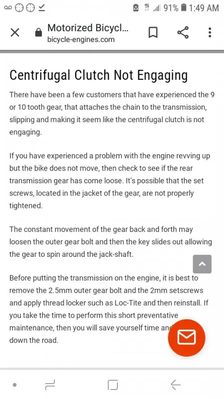

This might help a lot of people...just something i stumbled upon #bt80clutch
