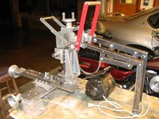

using the shaper's power train to power the mill.
Next thing to build is the power train for the mill so off to the man cave.

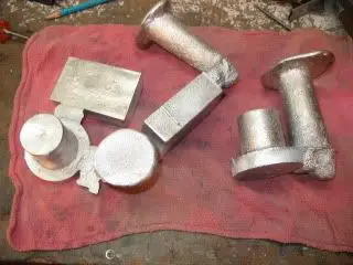

I make the patterns for all of the casting out of wood or med density fiber board. For the aluminum I use what ever I can get my hands on mostly worn out briggs engines.

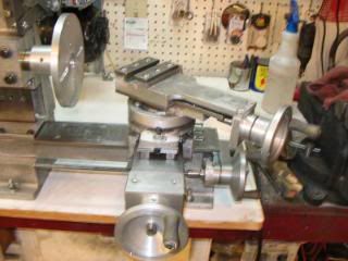

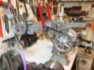

The mill's transmission is done I've made a face plate and machined the mill's compound.
here is what its looking like.
both sides
the compound slide, the mill will also work like a lathe
the frame of the mill's transmission befor the sheaves, motor, and bearing were installed.

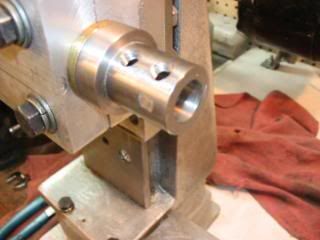

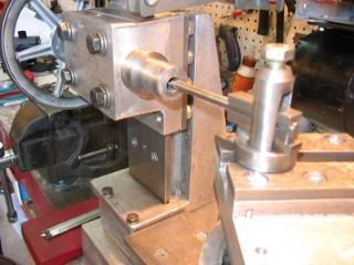

Got the spindle head bored to 0.625 , drilled and tapped the 5/16" fine thread set screws installed.
Now it's back to pattern making to cast a face mill tool. I'll also make some different tool holders for the spindle head and the compound.

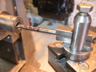

start of the boring to 0.0625 on the spindle head
this is the tool holder with the boring bar.
finished spindle head

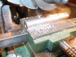

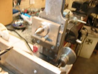

this is a shot of the shaper cutting a flat surface on the mandrel for the face mill which will be cast on this 5/8" dia shaft. The flat area will index in the set screws on the spindle head.

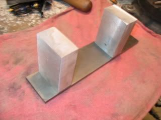

I'm still making parts for the mill made a fly cutter a while back and today I started making a right angle plate pattern for the mill. I'll shoot some pictures of it soon.

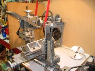

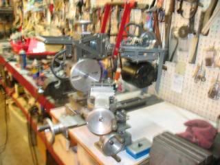

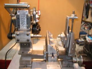

Here is the mill.
first 2 photos is the mill with the tail stand missing it's hand wheel. you can see the right angle plate installed on the permanent table.

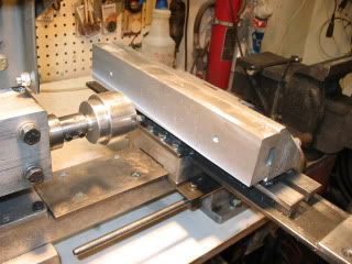

this is the permanent table base being milled. It will replace the 1/2" square key stock base that is being used used as a table. The first 2 photos show the permanent table in use.
the tail stand is designed for support for an over head boring tool or for off set machining.

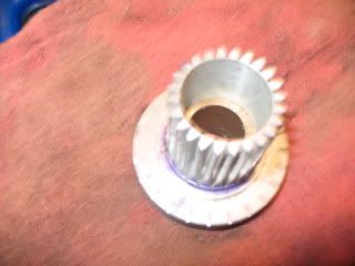

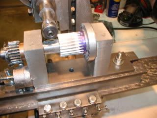

I used the mill and shaper to fix the sears lathe broken gear here's the photos
cast blanks
building the gear cutting stand
milling the gear using my home made mill
the finished gear
It works fine got my sears lathe back up and running. If I could of bought that gear it was priced at $300.00 it came as a gear machined to a pulley.
I cut off the damaged gear on my pulley machined the gear and now its held on the pulley with bolts that is the reason for the shoulder on the gear.

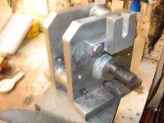

I started building the dividing head that is in book 6 of the Dave Gingery's series on building your metal shop from scrap.
So far I've made all the patterns except the dividing wheel disc. I've done the castings for the dividing head frame and have them machined and the bearing are in place on the frames.
I ordered the worm and worm wheel from Mc Master Carr it has a 40 to 1 ratio they are the correct size etc. The plans say they cost about $30.00 including shipping. That was in 1982, boy have they increased in price, close to $100.00 for both.
I'll start casting the rest of the parts soon plus machine the small steel parts that go into the dividing head. I haven't taken any photos, just been lazy about doing that.
If your wondering what this dividing head is for Google "dividing head" then you will know that this thing is for.You will be surprised at what these cost if you are looking to buy one.

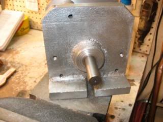

here is the start of the dividing head
this is the front of the dividing head there is 3 casting to make the frame of the dividing head. there are 2 bushing 5/8" id by 3/4" od. one bushing on each frame half.
this is the back side of the frame you can see the small foot at the top this is for mounting the dividing head vertical on a mill or drill press.

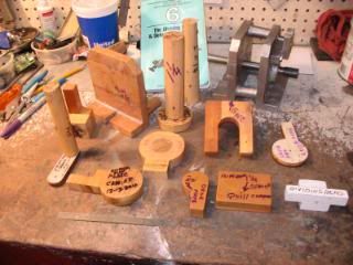

here is the patterns only one more pattern to make. The last one to make will be the indexing plate. I will need to cast at least 3 plates or more, the plate will be 5" dia. by 3/8" thick not too tough to make I'll either cut the pattern on my dremel table saw or cut a blank and turn it on the lathe.
The worm and worm wheel is on it's way from Georgia should be here by the end of this week and wouldn't you know it its supposed to snow Fri. today we had temps in the 70's. I haven't started to machine all the steel parts yet but they should go quickly as none are very hard to do.
Once this dividing head is made I'll be able to make gears or even a bikes wheel hub and be able to get the spoke holes drilled accurately. This even could be used to make a sprocket.
